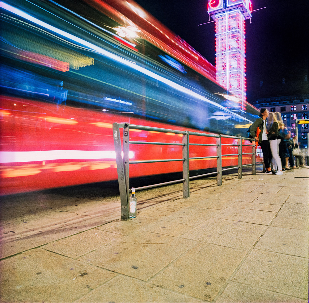

ept ei 100; 50mm @f/8, Mamiya 6, no filters, 8 second exposure. The neg looks a lot like a c41 neg and prints normally.

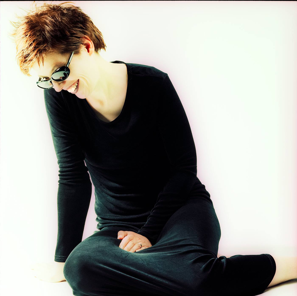

e100sw; 75mm f/5.6, 40cc mag filter, mamiya 6, the neg has no base color and is very difficult to print -- notice the bloom of magenta and it still has a green cast. without the mag filter on camera it would have been worse.
