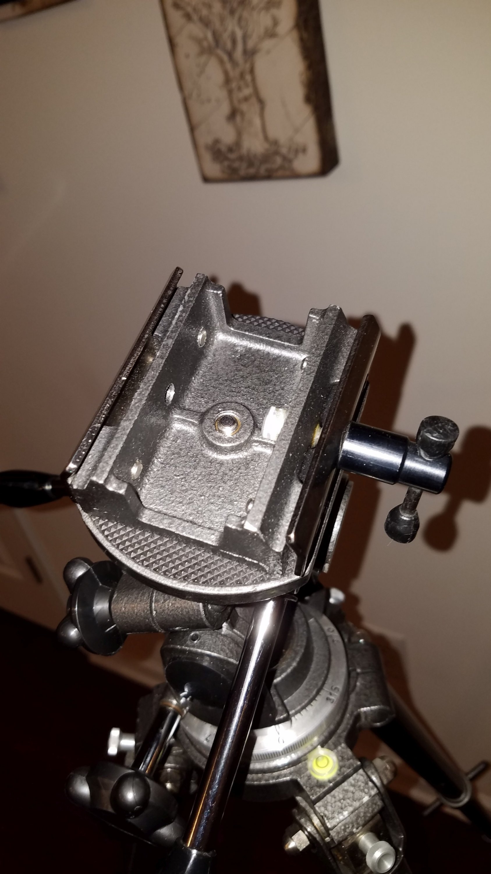

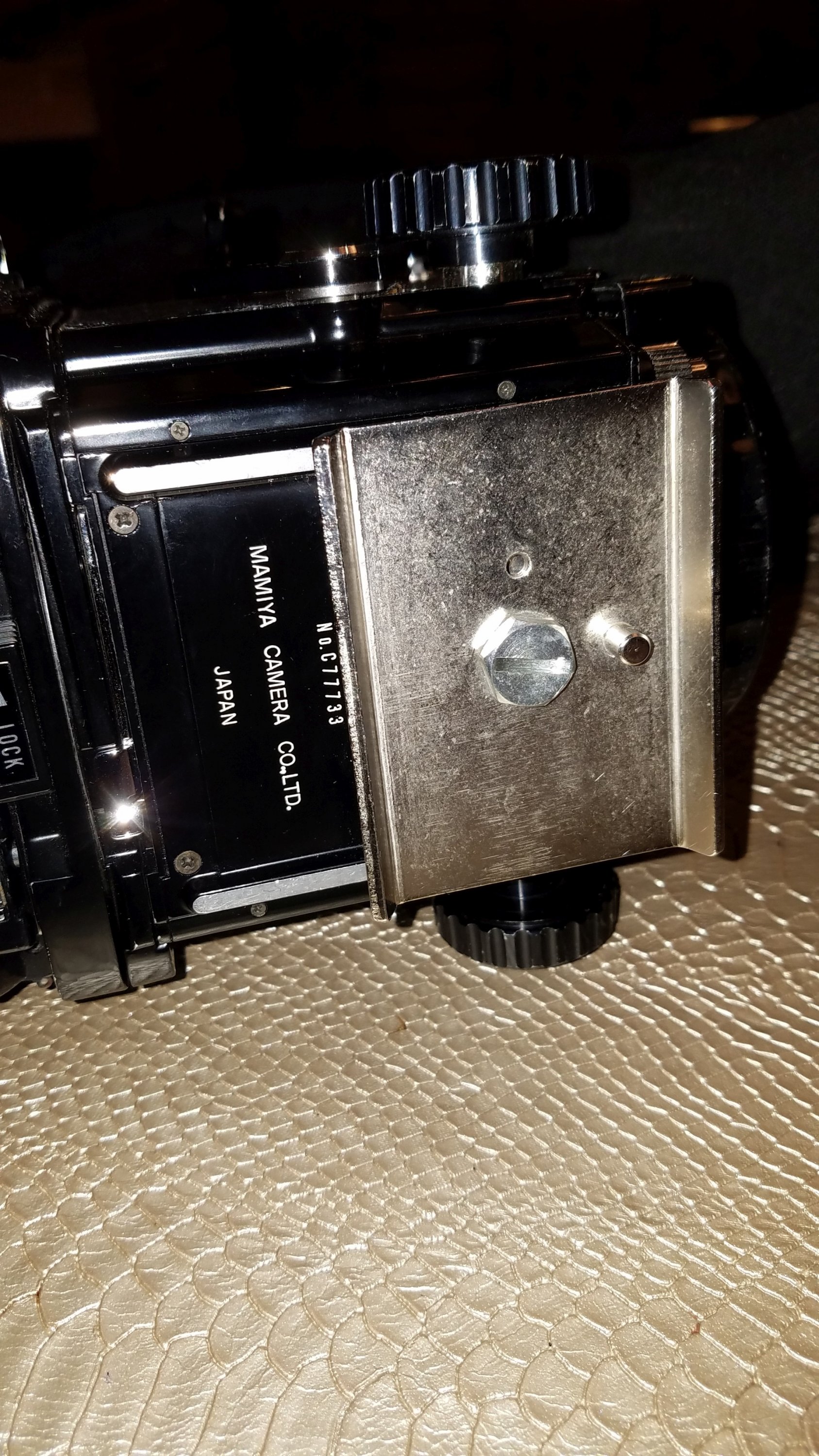

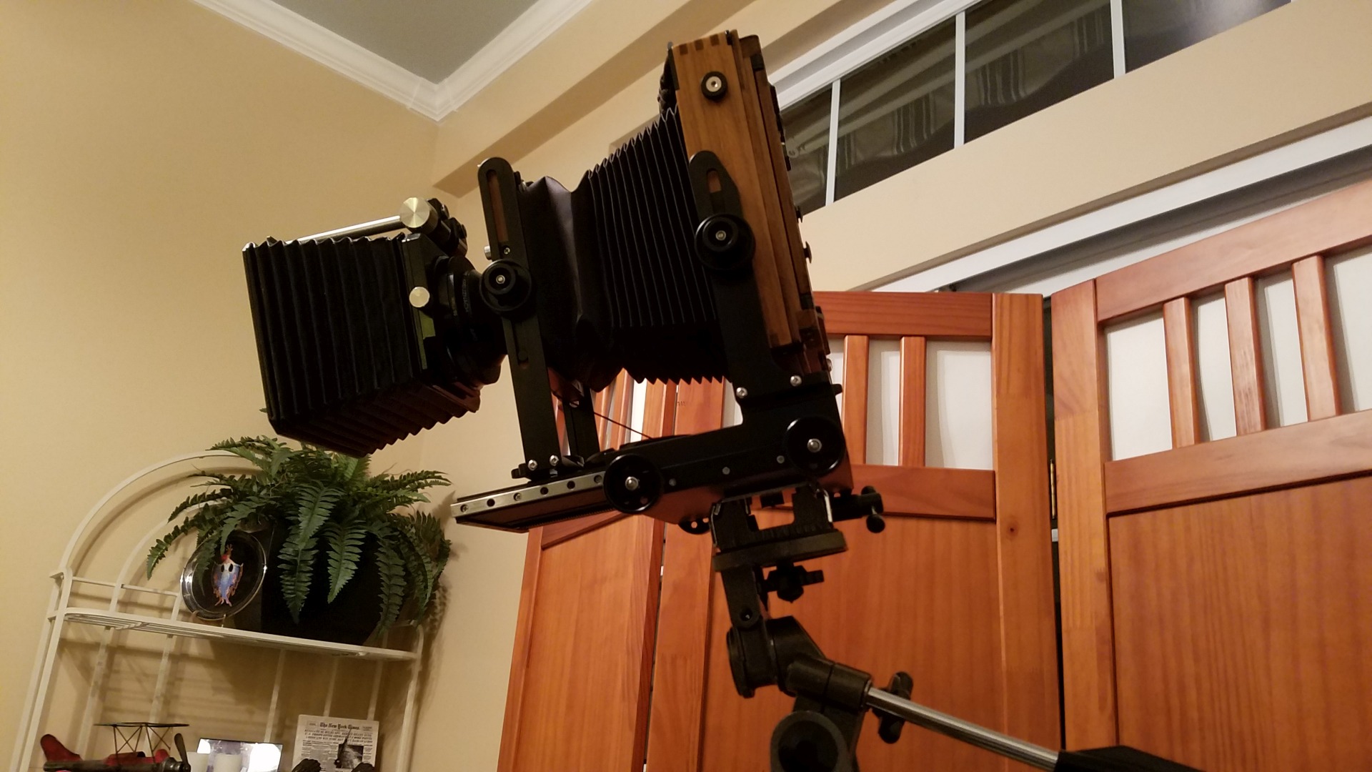

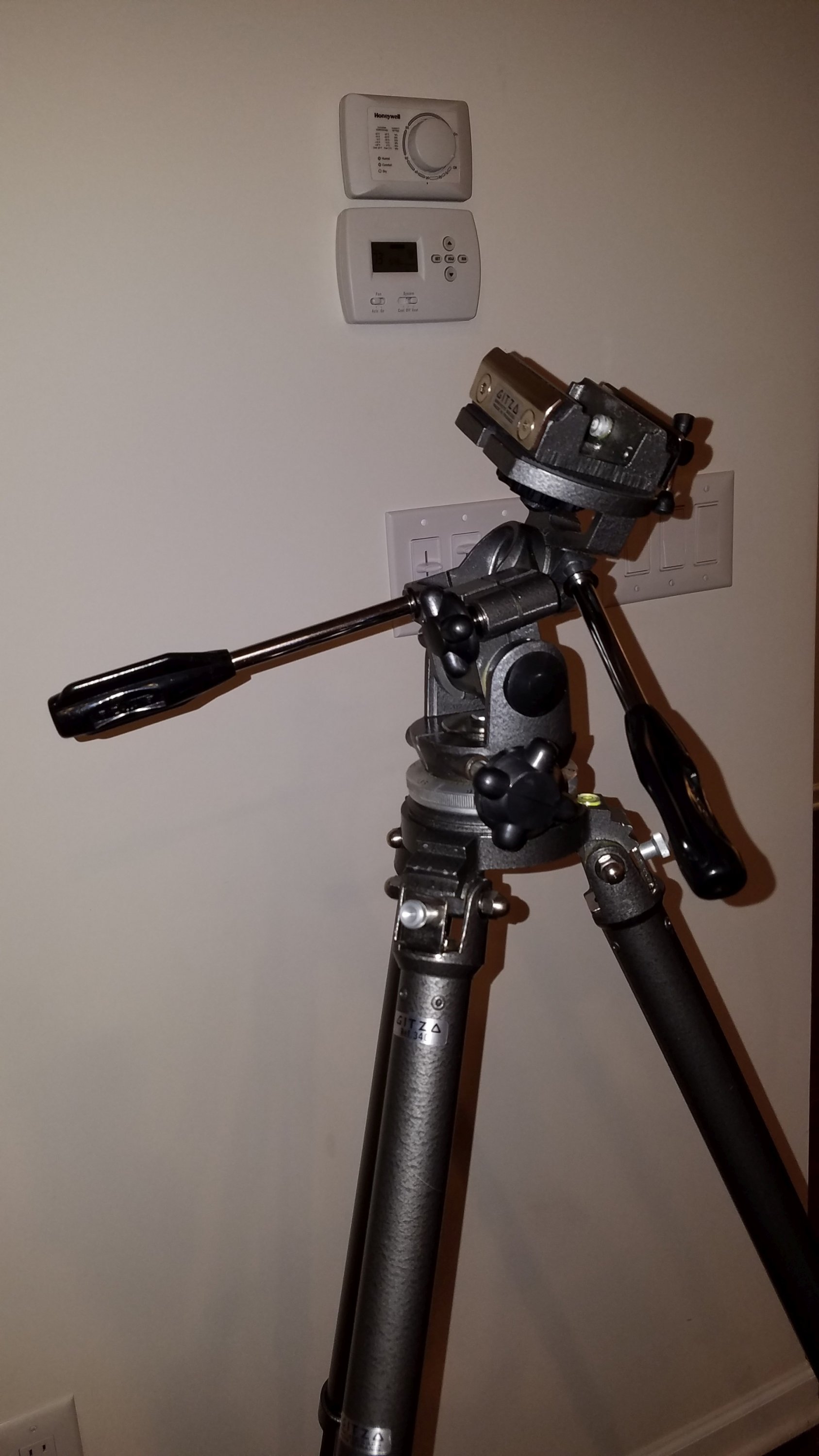

I have a Gitzo 3-way with a Gitzo Brevette S.G.D.G. 385 QR that mounts I think with a 1/4" screw. I've used it on my 9 pound Mamiya RB67 medium format for thirty years and below is a picture with a lighter 4x5. I never had a problem with it loosening and often carry the set still mounted on the tripod when shooting in the field place to place.
Gitzo 3 way with quick release ab.jpg Gitzo 3 way with quick release bb.jpg Gitzo 3 way with quick release cb.jpg Gitzo 3 way with quick release db.jpg
On might cut/screw off one end of that lever of the locking screw (toggle screw), and place the leverin a holder at the head, so that it cannot be twisted accidentally during such transport.
