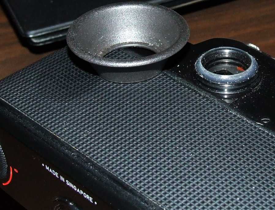

In this case I found a Contax diopter that was free lens, and I glued it the existing flat glass screw in 'lens' on the viewfinder of this Rolleiflex 35mm SLR.
In this case I found a Contax diopter that was free lens, and I glued it the existing flat glass screw in 'lens' on the viewfinder of this Rolleiflex 35mm SLR.View attachment 261266
Whoa, that's great! Very ingenious!

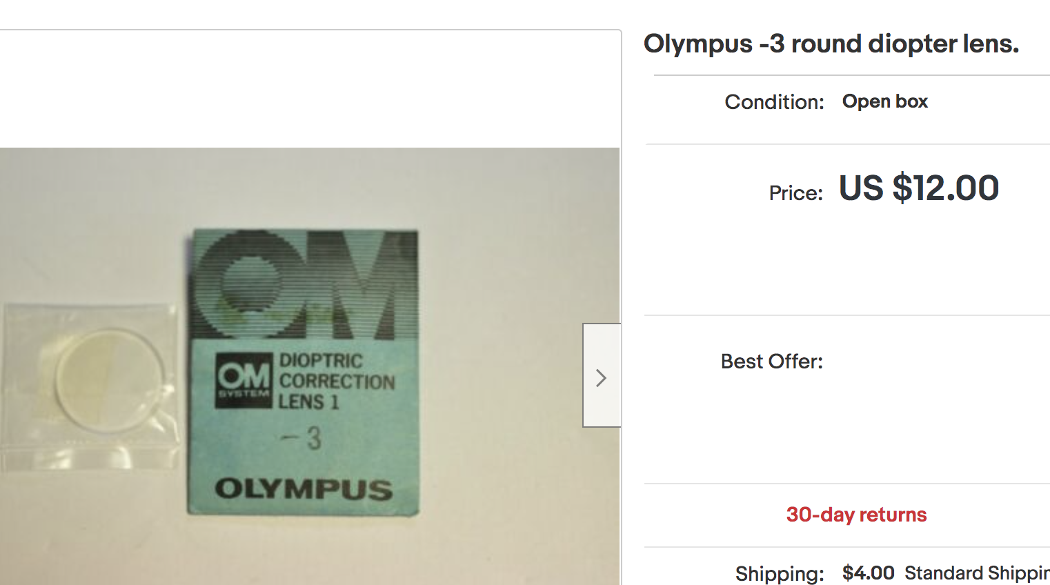

There are actually a lot of loose diopter lenses on ebay. For example this was the first one to come up:
