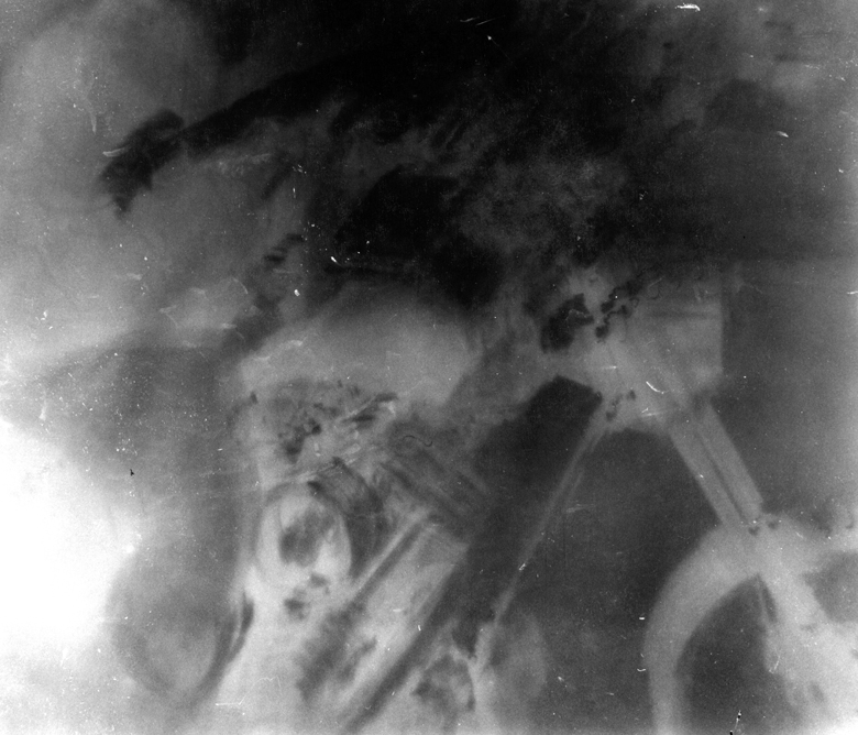

I am interested in anyone that understands just what I accidentally did to one negative. I am shooting with my Holga with about a 10 count exposure. I then process the negs in HC110 1-31 dilution. That leaves very black (bullet proof negs). I then put them in a Farmer's reducer from the darkroom cookbook, tray bleaching back and boom, the image appears. Now the bleach is not really agitated this gives the unique ebbs and flows you see in these images. Ok, now sometimes the image becomes very thin and on one image (Santa on a Harley) it seemed too thin for my taste. I decided to intensify the negative and put it in a intensifier. Well, I must not have looked at it closely when I scanned the neg, because the film scanner was set to positive, hence the image I posted in my photos. Today I went to print and was surprised to see a beautiful 9"X9" negative on my paper.
I know enough about transparency film to know there is silver there, but did I do something that is normal, or have I made a freakish HP5 positive. I know there are folks out there that understand the process and how I managed this one.

I have attached the positve scan of the image in question. I know was a postive when I made the print yesterday it was a negative. I checked my film scanner and it was set to postive, so, well..... Now to the intensifier, I used Monckhoven's formula #179 in the old edition of the Darkroom Cookbook. I intensified only this one negative, so I did not expect the reversal.
Hope that can help answer the question.

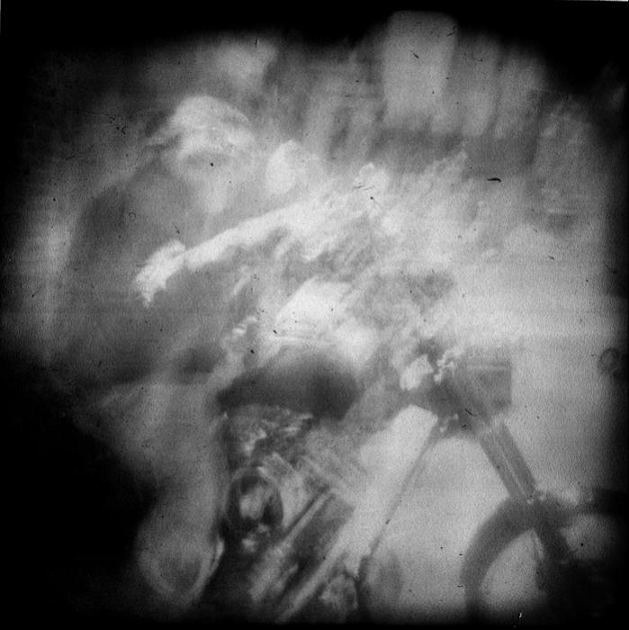

I just scanned the print I made from the image in question you can see that it is a negative image, I am interested in folks thoughts. It should not have solarized.

for all concerned I ran the film completely. That means through to fix. I also tried to reproduce the effect today. It did not work. I have come to think that light leaks or something may have solarized the neg. Since it was completely black when I finished the full development, stop, and fix I could not determine it's condition. When I did the bleach the image began to appear, perhaps already a positive. This still stays a mystery.
