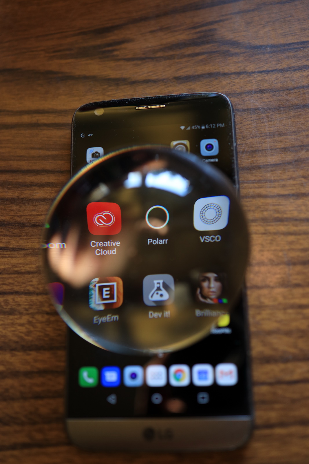

This will be interesting. My phone has two lenses. My phone is also a few years old and I rarely use the camera on it. It's close-focusing capabilities may not be up to today's standards. I don't have access to the magnifying dome at the moment, but I do have a LensBall (TM) that is about the same diameter but twice the depth. I placed it on my khaki bathrobe, lined up the correct lens, and took the shot. It does focus at least THAT close. I can't upload the photo because I need to resize the image and can't figure out how to do it on my bloody phone. I'll try again in the morning with the magnifier.

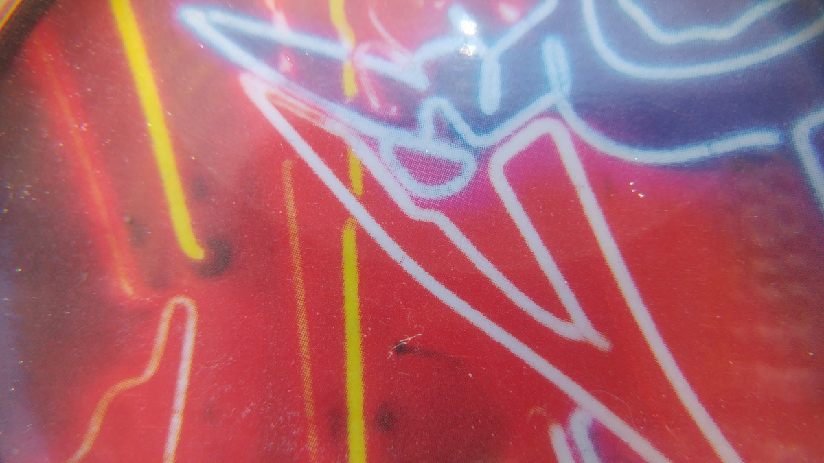

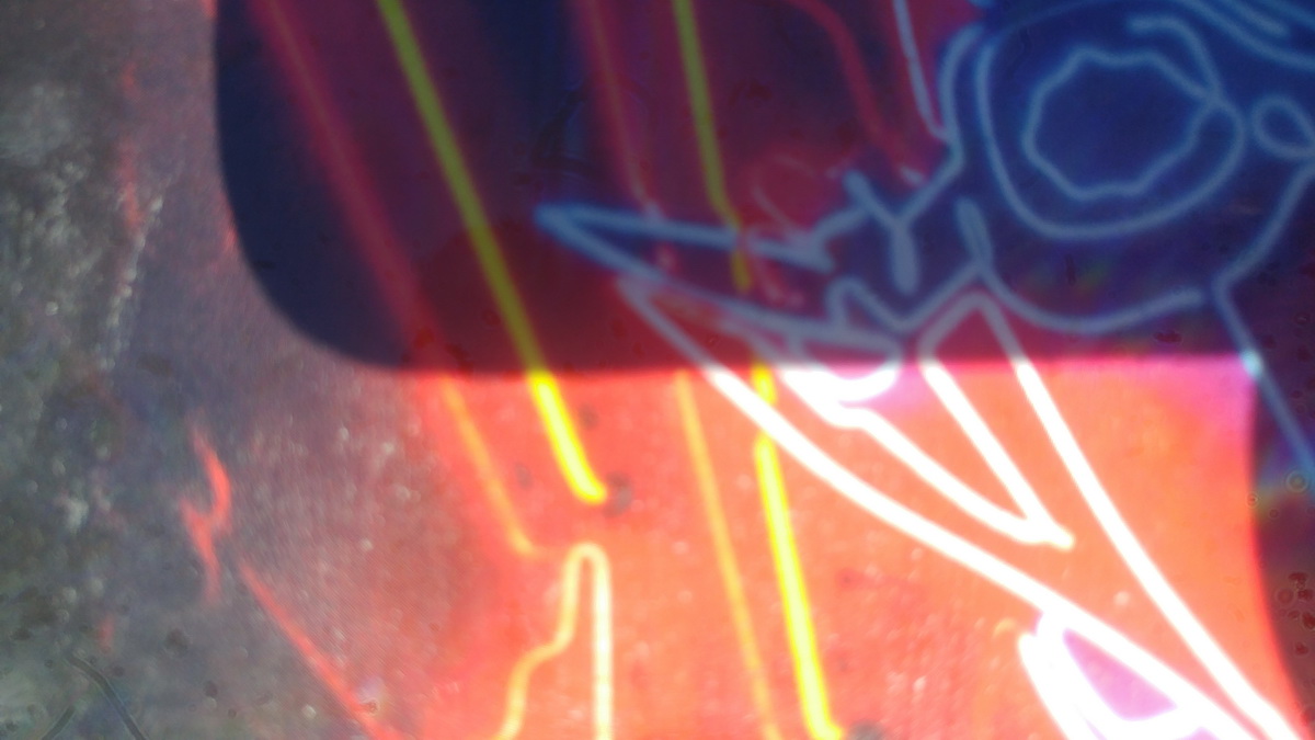

My phone is an LG G5. The magnifier is about 5.5 cm tall. First shot is through the magnifier with the lens resting on the magnifier. Second shot was taken when I removed the magnifier from under the phone.

So it seems indeed that a dome magnifier does indeed decrease the minimum focus distance of the phone, as the desk looks somewhat in focus.

First shot through the magnifier
Second shot without.

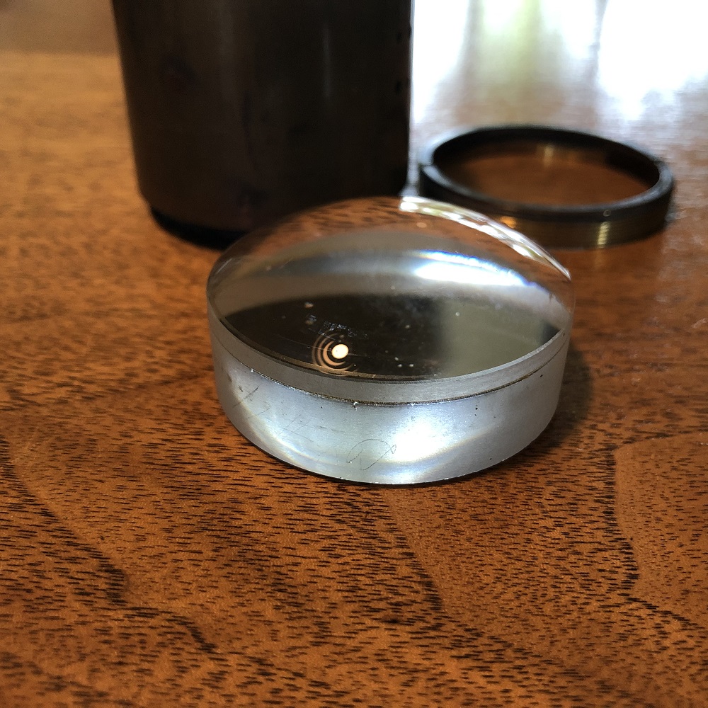

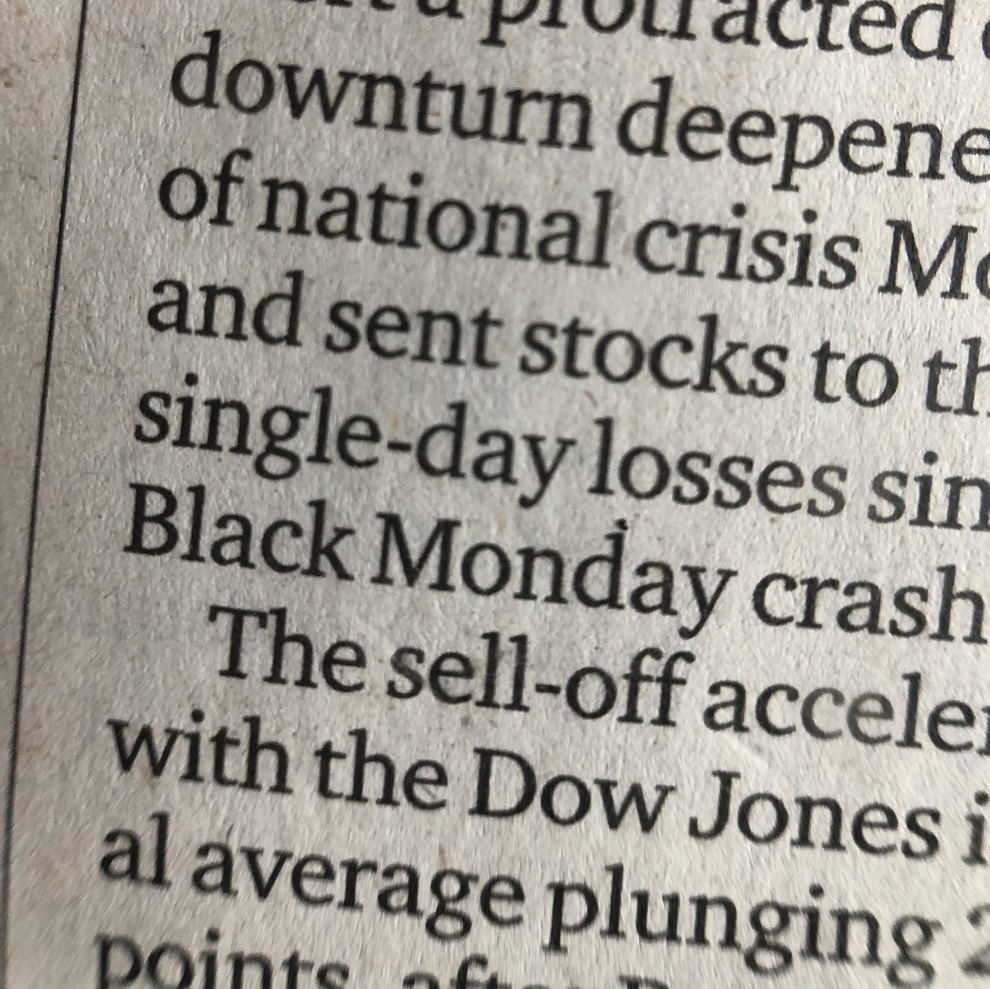

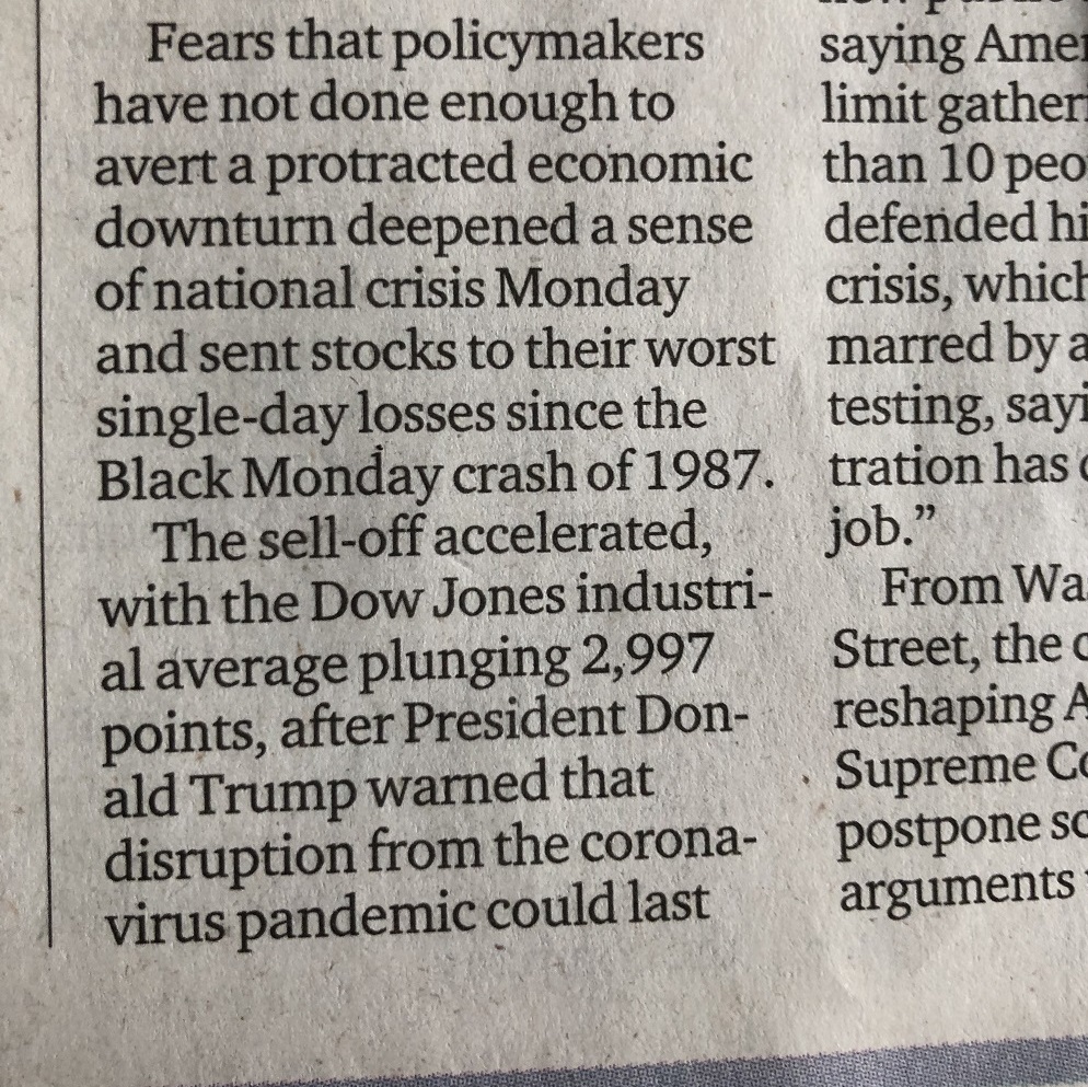

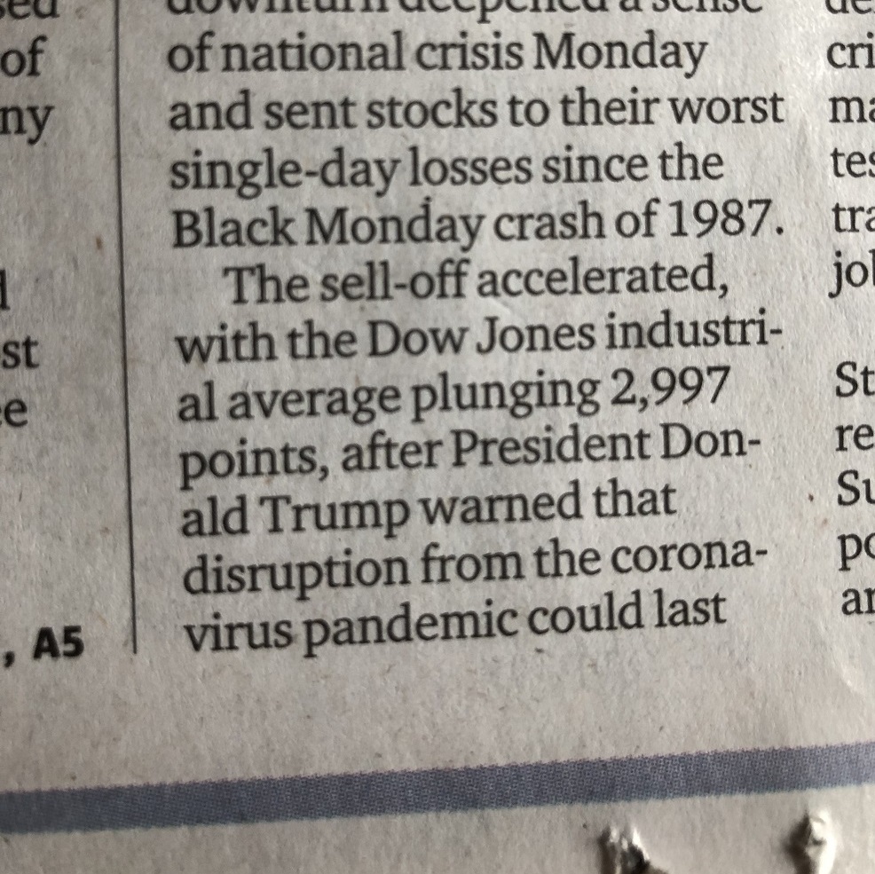

I just tried this with a lens from a condenser. I'm not sure what the condenser came from, probably an old magic lantern projector. Putting my iPhone 8 up against the flat side of the lens didn't seem to do much as far as magnification goes. Putting it against the curved side increased the magnification. The closest I could get using the flat side was about 9 centimeters, it was the same with or without the lens. I could get about 4 centimeters with the curved side. The first photo of news print is with the camera against the flat side, the second is no lens and the third is with the lens against the curved side.
@BAC1967 Awesome, thankyou! Just google'd the Iphone 8 minimum focus distance and it's 6cm. So you're saying that the condenser is 4cm in thickness then yes? If thats the case, then it reduces the distance by 2cm roughly. The last picture looks pretty in focus. Reading about the stock market crash?
@BAC1967 Ah. Thats what I was curious about. Having the magnifier on the paper, and then the phone touching the magnifier. If its out of focus I guess that means that it can't reduce the minimum focus distance of a phone after all....hmmmm :-/
