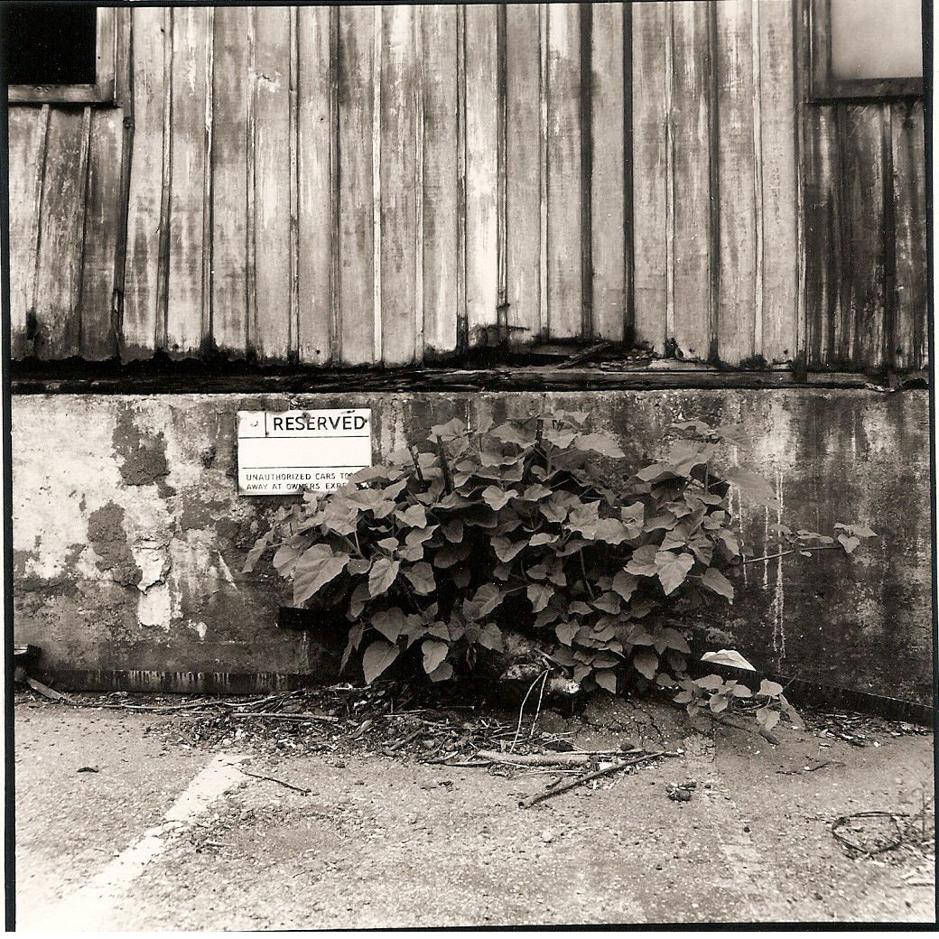

Here is an example of the print I use, though it is a little light and has flare in the lower Left corner. I looked for the actual Fiber Print I use, but could no find where I put it, so this small print will have to serve.
This print is Selenium toned, was shot on Tri-x Pan ISO 200 (D76) back in the mid 1980s, with a 80mm 2.8 on a Hasselblad CM, using a Luna Pro F for metering.
