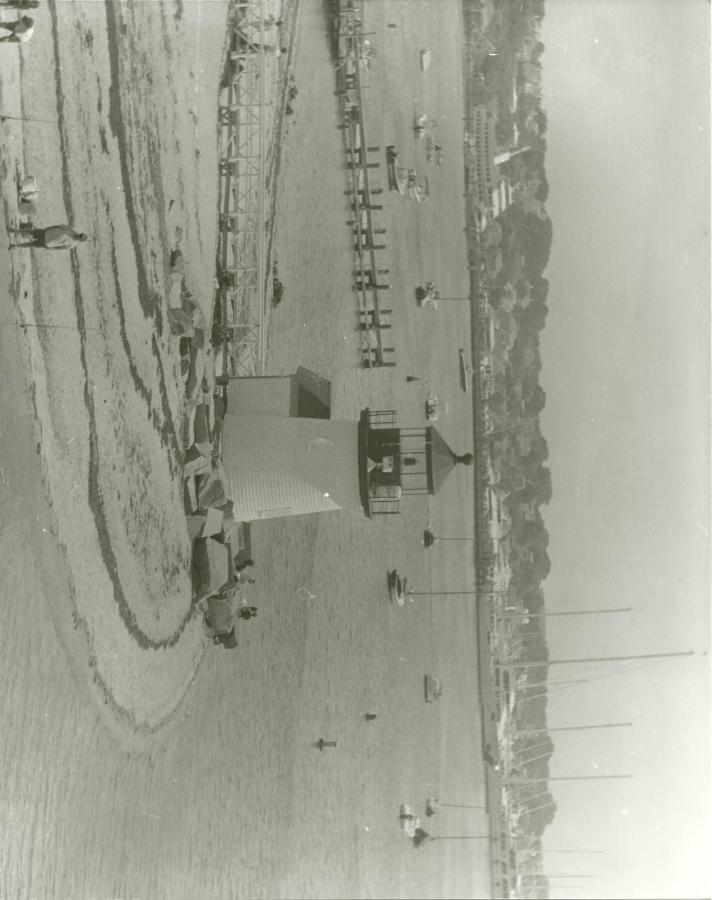

I am using some paper I bought a local store that had been cut from rolls and they say it is Ilford. There is a water mark on the back that says black and white paper. It is a RC and VC paper. I did not print these with any filters. I will scan an example.
Here is an example

I have never seen an ILford paper with a logo on the back, so someone is pulling your leg. Nonethe less that is not important. You need to use a filter to boost the contrast, think above 3.5
the times will be long due to the orange mask of the film.

I just printed a color neg this weekend, and I would say results were just ok, not great. Printed on Ilford MGWT in Dektol, toned w/ KRST 1:20.
The reason I wanted to try it because I wasn't happy with the color cast I had on the original (which you can also see if you click on the link), but have very mixed feelings about digital conversions. Actually I have mixed feelings about the analog method as well...I feel like I should be trying to shoot color better or simply use b/w film rather than try to change what I've got. Anyway, I had to bump up the contrast quite a bit as it seemed flat without a filter, but 160S is a fairly subtle film and the added contrast just seems to defeat the purpose. I think I also printed too dark for the subsequent toning. But...well, there's my example.
