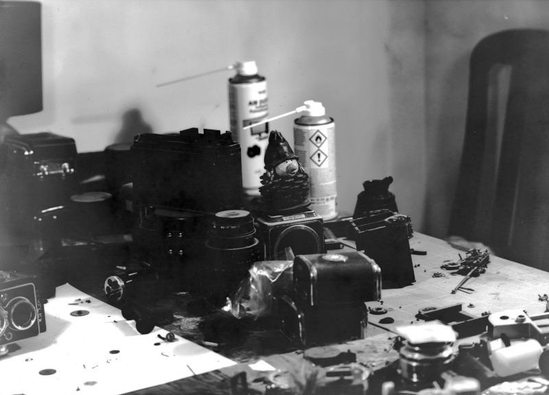

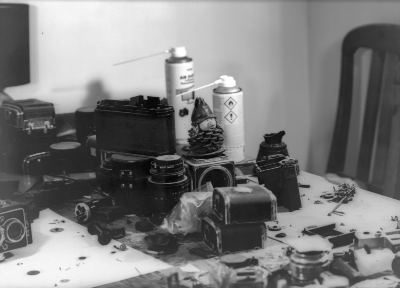

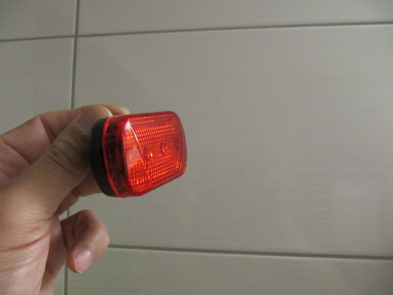

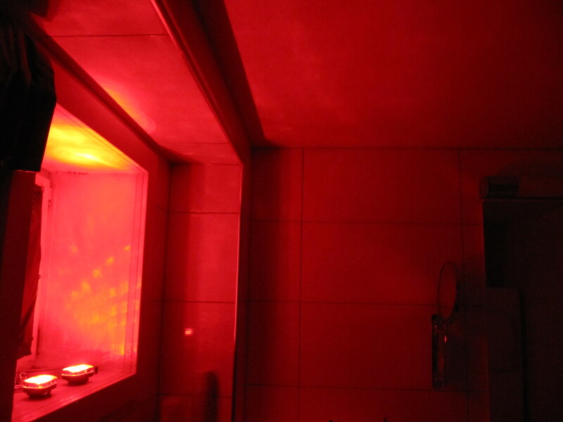

Recently I got a box of Kodalith ortho type 2, and have been trying different developers/times. Yesterday I wanted to try with paper developer. Got a small bottle of Fomatol LQN, and went to the supermarket bought couple of small 3-LED bicycle tail lights:
worked very nice with Kodalith. It was pouring all day so I took an indoors shot for test
~1:30mn under inspection with Fomatol vs 1h stand in HC-110 1+160.

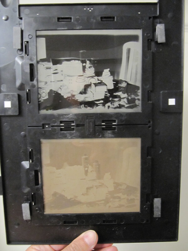

Top Fomatol, bottom HC-110:
respective positives, after grey levels adjustments, for what the Fomatol processed negative had more latitude (top Fomatl, bottom HC-110).
I want to play more with orthochromatic/technical film so am going to develop more and more with paper dev by inspection ...
