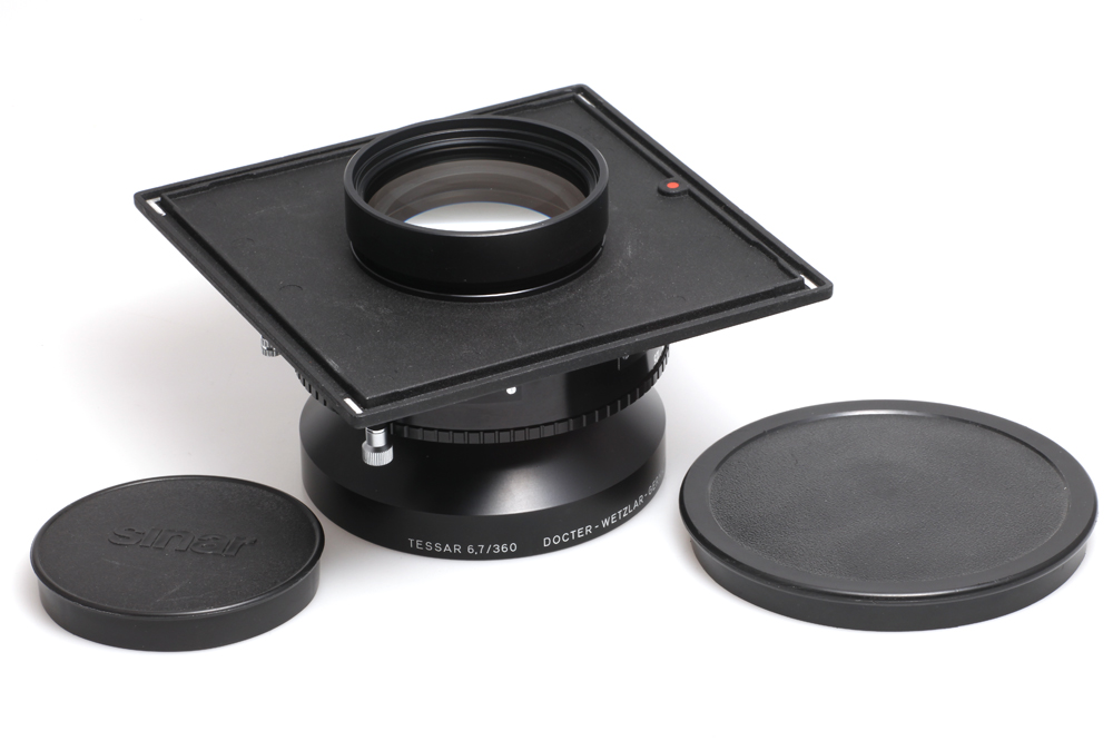

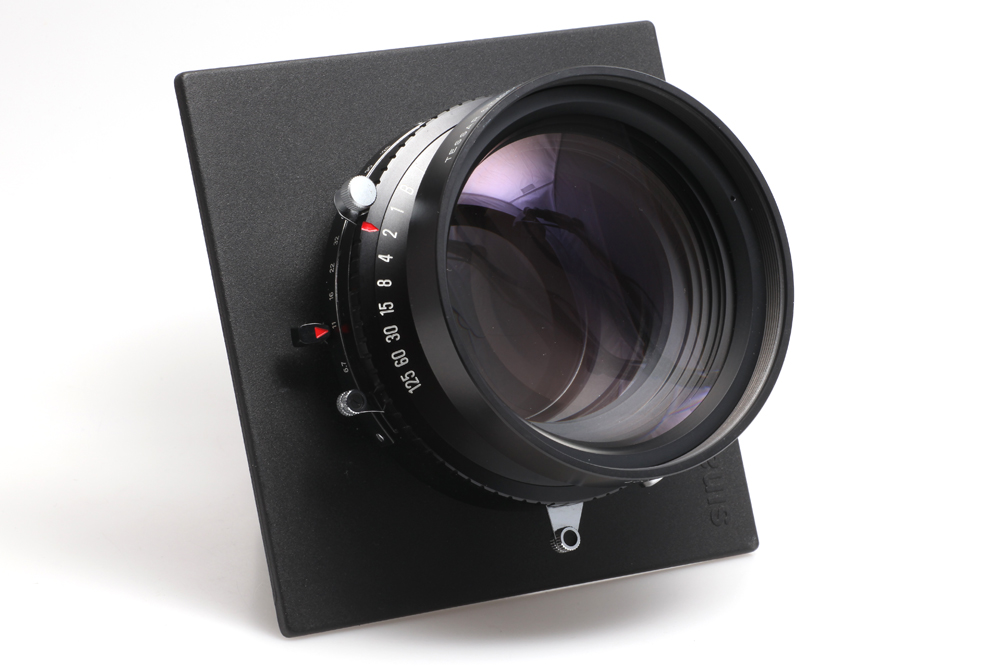

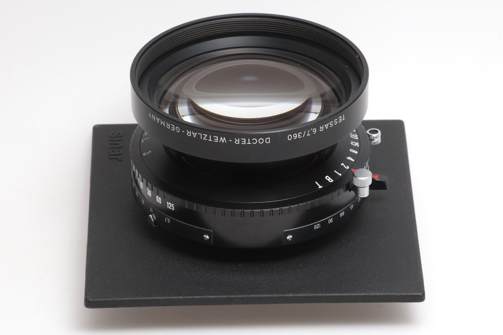

For those interested, here are some photos.
