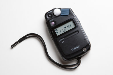

Sometimes I use this.
And sometimes I use this.
I use my meter as a rough guide and primarily rely on eyeballing the scene.

Sunny 16 does not usually work for me Everytime I try to check it, my light meters tell me to use f/11. And when I use the light meter, the negatives look good. So, for me, unless the lighting is very simple and predictable, I check the scene with an incident reading. I have used a Gossen Luna Lux SBC in the past, and now, a Sekonik L-308s, and I trust either of those more than "Sunny 16." Plus, with an incident reading, I don't have to do any mental gymnastics to convert Sunny 16 to my actual shutter speed and aperture.
I have a couple Minolta IV F incident meters. These have served me well for 25 years. Sunny 16 is very accurate, but the incident meter is so nice to use for shaded or partially shaded objects.
