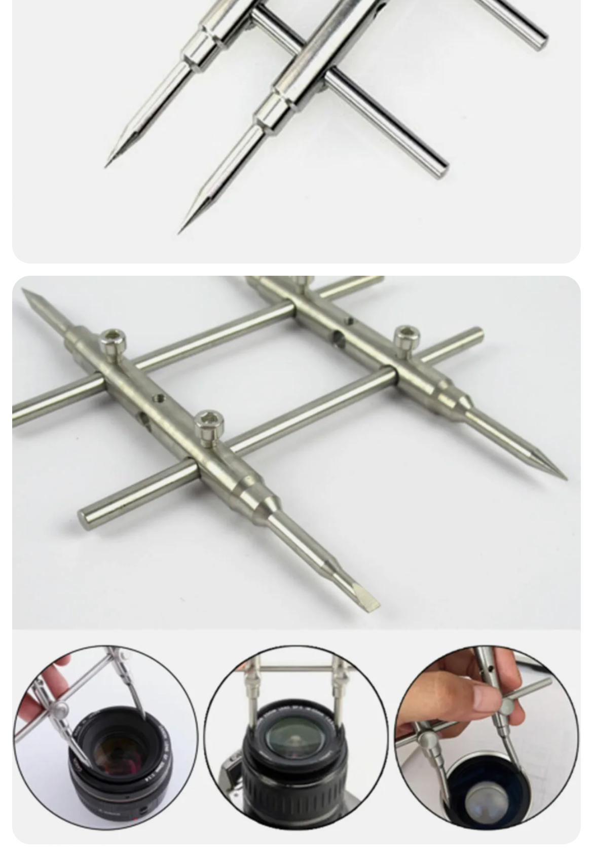

I watched few repairing videos of the gears and noticed some never used any spanner wrenches to open the ring. The video makers are like slightly pushing the retaining ring and it will go off easily. But in real life, the cameras or the lenses on my table rarely go easy like them. Most of them are hard, sometimes it might broke the tip of the screw driver or scratched the ring as well.
I only use the wrenches or rubber caps to losen the ring first ,then drive it out by using wood stick. And by putting it back I do it in reversed way and only use the wrenches to do final fasting and lock. I don't see YouTubers doing in this way?
Do you guys use spanner wrenches? Or have I been doing it in a wrong way for a long time?🤨

I think you are talking about the adjustable two pin wrenches.
If so, remember that some screws have left hand threads. I believe that the self timer lever on the face of Olympus 35 RC have a left hand thread.

The 'H' or gate-type of wrench is very prone to slip if you turn it. Definitely try turning the lens with that one. This design scores for being able to reach into a recessed space, though.
The divider-type (two arms hinged and adjusted with a screw thread) are better in not slipping, but the way they adjust means the blade angles have to be reset if the device was used on a different diameter retaining ring. Mine lets me use different blades. On one occasion I had to mount two watchmakers screwdrivers in it to remove a ring with very fine slots.

When a spanner is actually required (especially small fasteners), I often will design my own tools in FreeCAD, and 3D-print them. Unfortunately, there doesn’t seem to be any standardization, and I have yet to encounter a situation where a previously-printed tool fits another make and model of camera!
eBay is my friend. ;-)

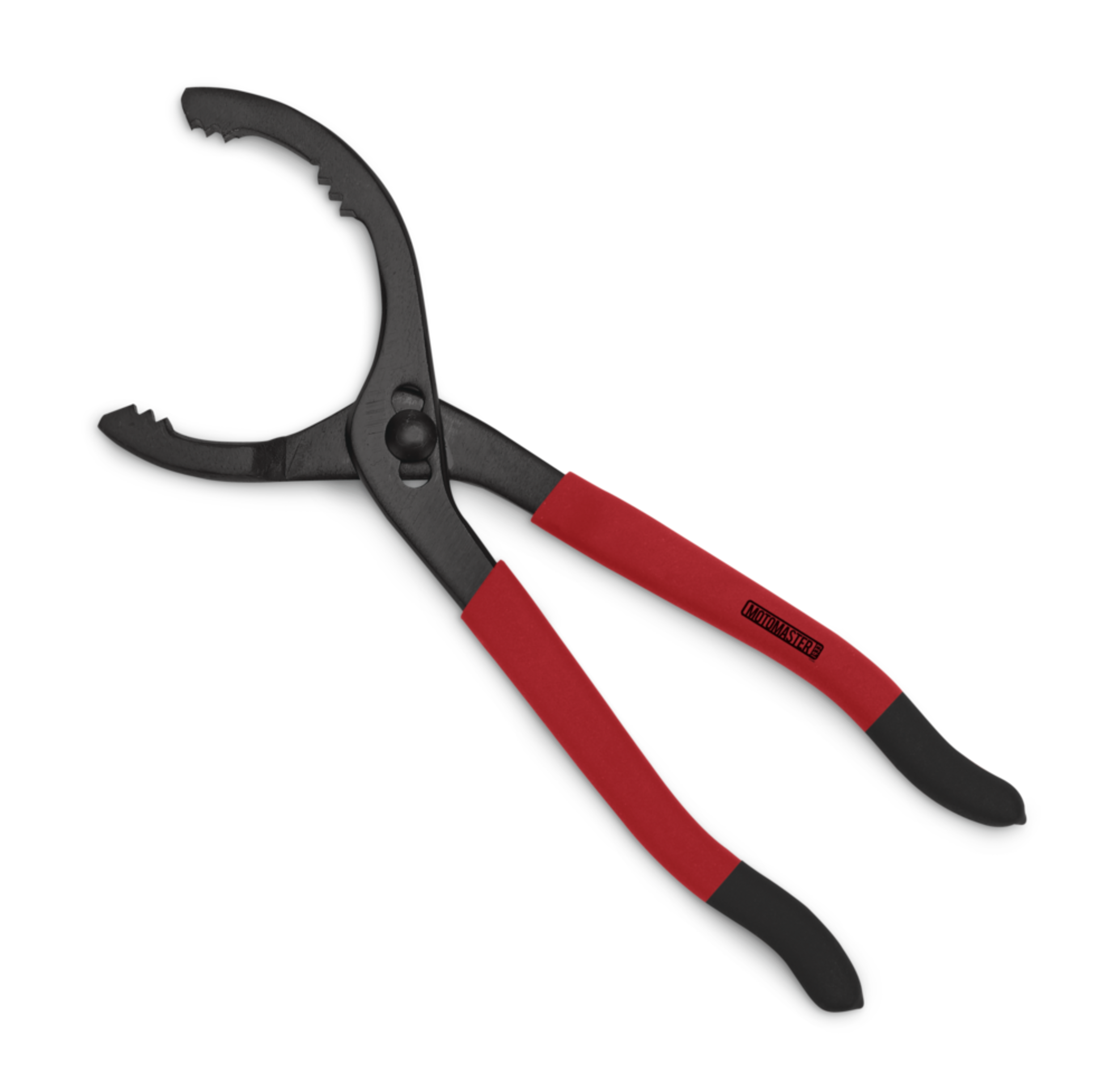

Thread title tweaked, in case people thought the thread was about one of these:
