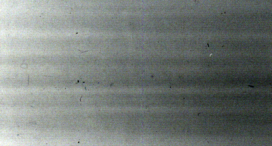

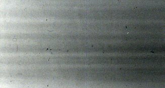

I have examples of horizontal banding in sky's tones on 6x9 thin negatives. Now I'm wondering if that is not a result of scraping emulsion onto the plastic backing showing up when emulsion is thin. It may be a result of twirling developer the same way all the time. I'll have to try doing inversions along with spinning the stur stick.
Is this effect a result of spinning?
Michael.
Which way is the film twirling left to right ? , because this looks similar to some of the problems I had, but in my case it was two wide distinct minus density marks not banding like I see here.

studiocarter
Dec 19, 2008
437
Pittsburgh
I load 120 film tail first in a Patterson tank then spin clockwise. No back and forth or no inversions.
Left to right reading properly orientated, I don't know, tail to head spinning.
If you recognize this then I invert and twist next roll!
