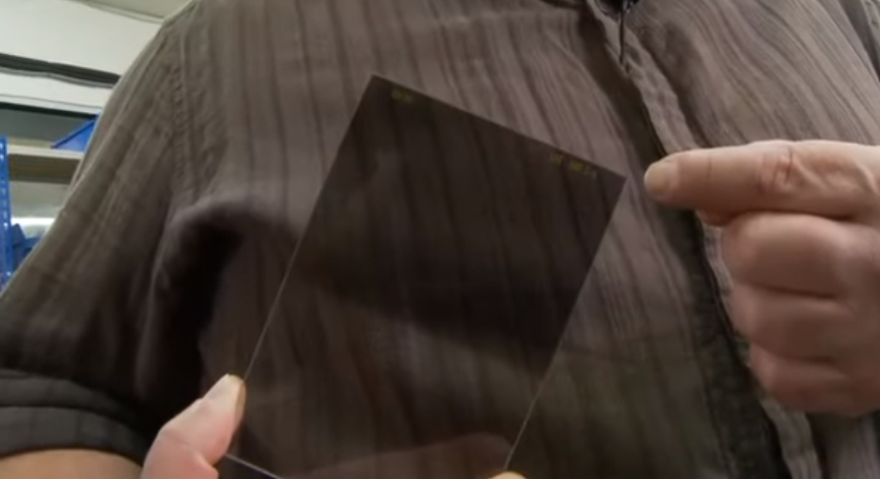

Seen the way they are printed, the lettering may easily change position towards the edge. But also a change in position could have been intended.
Here a Lee filter still in their plant.
Always possible. Maybe the extreme browning is too if the filter has been stored in very hot/humid conditions? Can't rule it out completely.
You are more likely to get fading if the filters were exposed to UV/Sunlight a lot. That's pretty typical with all organic dyes. And yellowing of plastic resins.

Well I would say that filters used in cinematography are full glass tinted ones, tiffen is the most common brand on that. Beyond that, Lee filters has this video in which they show the manufacturing process and they say the filters are dyed by hand (min.0.40).
