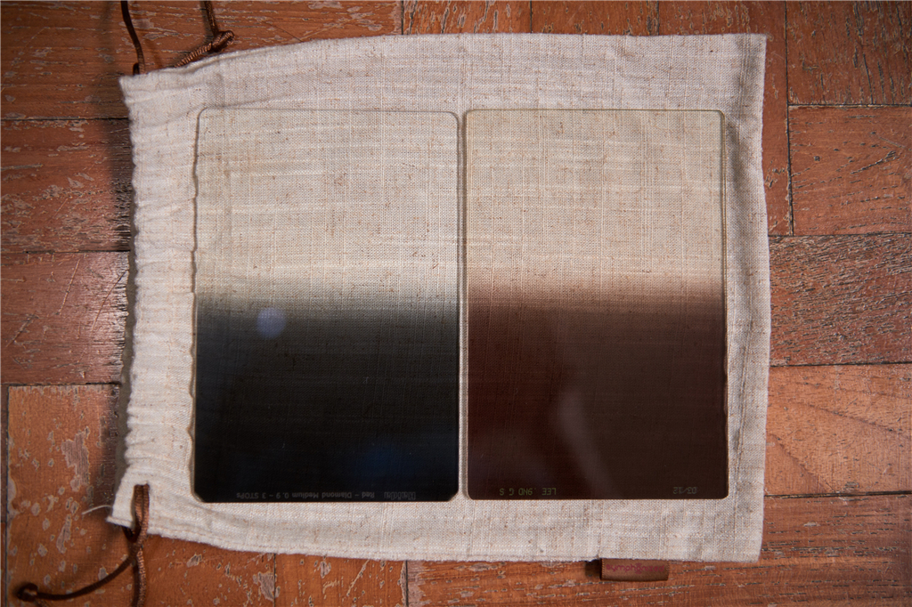

Hello!
I have recently bought a second hand set of LEE graduated ND´s. The thing is that it seems a little bit magentas to my eye and a little bit yellowish at the clear side.
It also has the LEE ND.3(6 and 9) S G inscription from LEE at the bottom right hand side and nothing at the other corner.
I have noticed that other LEE filters are designated as LEE ND 3 SOFT (MEDIUM or HARD) instead and some numerology at the opposite corner (11/15). Even I have seen inscription like mines but with the numerology at the other corner (03/15 or 02/15).
What is the difference between thme and more important, are fake mines? Thank you guys!

Hi! Thank you for your reply! As far as I always learnt, graduated ND must not have any color tint in order to be neutral in color and just to affect light exposure. Said that, I don't know if Lee filters can be made in different ways so the marks on the filter can differ from one to another. There are some elements that make me mistrust on it:
1. The yellowish and warm tint a long the filter.
2. The LEE marks that does not include the appropiate numerology from lee at the bottom left hand side corner.
3. Not rounded corner as LEE filters get us used to.
https://ibb.co/dG01Xm4
https://ibb.co/cDTrRkz
https://ibb.co/BzCyCW5
I leave you some photos so you can judge. Thank you!

They look like fakes to me.
I have 5 Lee grad NDs, ranging in strength from 0.6 (two stops) to 1.2 (4 stops). None of them have any colour cast discernable to the eye in either the clear or the stained part of the filter, and I have never heard of Lee filters tinting with age either. The middle one of the three you posted images of has such an extreme colour in the stain that I assume it must be deliberate (a tobacco grad or similar). Secondly, genuine Lee filters have the following printed on them (with characters made up of yellow dots):
Top right corner: LEE xND G S/H
(for example: LEE .9ND G H)
Top left corner: the date of manufacture in MM/YY format.
These markings are on the same face of the filter, and there should be no more or less. The pictures you posted have just the filter type printed on them, but not only that, the printing is in a different place (genuine filters have the printing closer to the corner). See the following for an example:
edit: I gather (as you mentioned in the OP) that more recent versions of the Lee grads omit the "G" part of the label, and fully spell out the filter category (soft, medium, hard, very hard, reverse, etc). However notice they still have the date of manufacture on them, like so:

From the Lee site - might explain the colour cast. They list coral graduated and sepia graduated filters as well.

Oh, I agree. They look faded (though that's a little difficult to determine over photos), and I don't think Lee would use dyes and resin that fade like that. And that Coral-like filter is labelled "ND" but does not look neutral to me. But one never knows what those filters have been through...

I have found this article on Haida´s website where a photographer makes a review and compare a new haida filter with his old lee filters. He said the next:
Compared to my Lee 0.9 soft grad resin filter, the Haida Red-Diamond glass filter does not exhibit any colour casts at first glance, whereas the brownish cast on the Lee filter is very apparent from the photo above. That said, I have been using my Lee filter for years, and the brownish discolouration could be due to age. The use of glass as opposed to resin for Haida's filter products should also yield a more resilient filter which should not discolour with age.

Again, I strongly suspect the "Lee" filter in this image is a fake. Look how far from the corner the model lettering is compared with the two genuine examples I posted. I have never heard of genuine Lee resin filters browning with age this extremely.

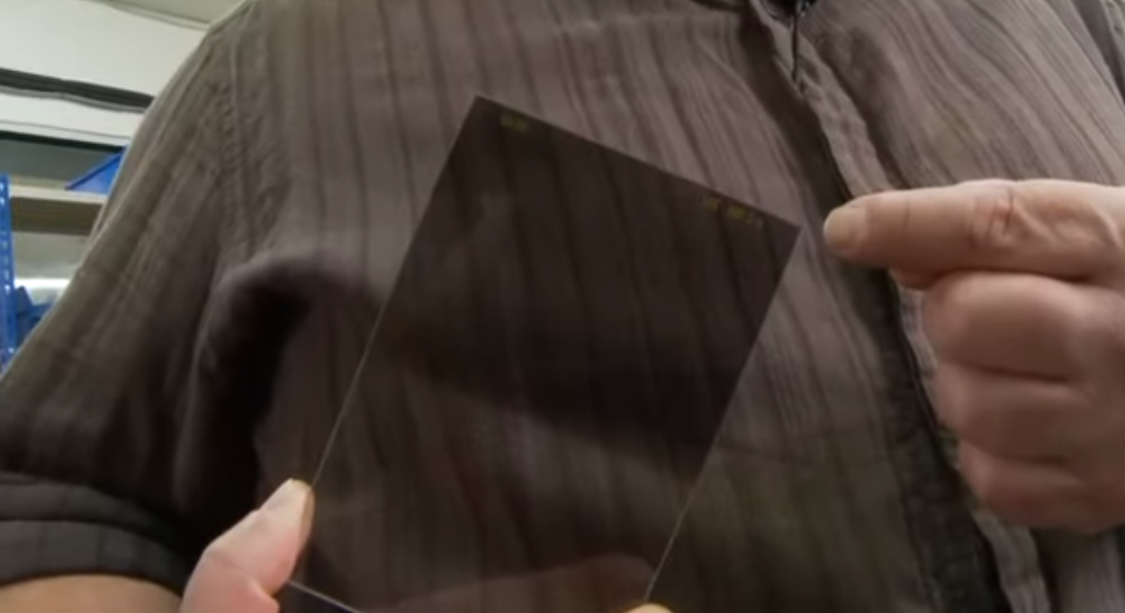

Here a Lee filter still in their plant.
