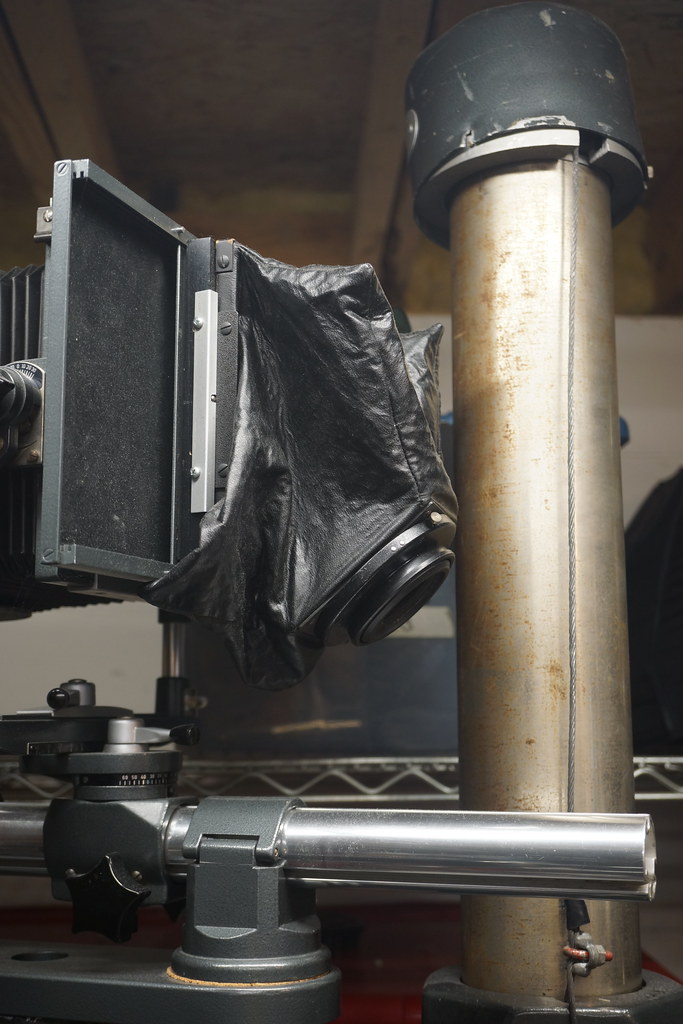

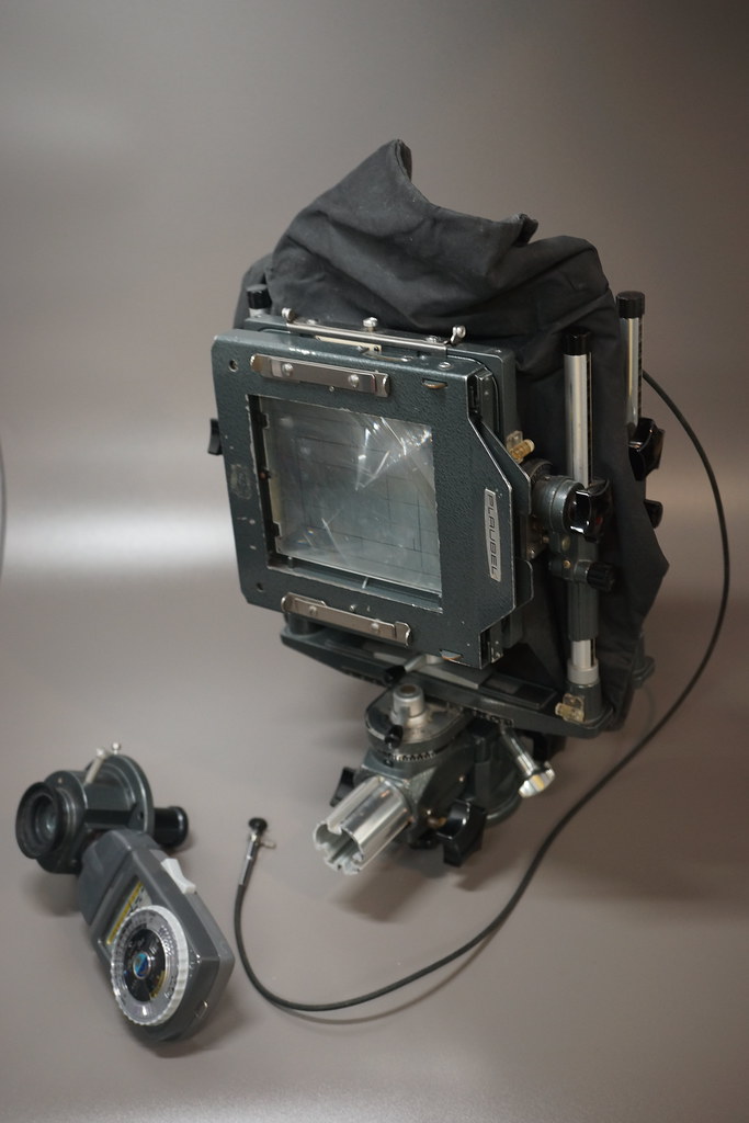

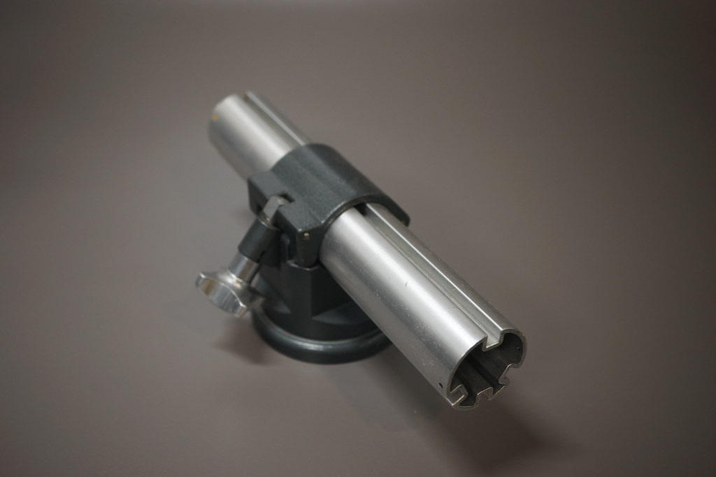

Profia 101 No 1 by Nokton48, on Flickr
Profia 101 No 2 by Nokton48, on Flickr
Profia 101 No 3 by Nokton48, on Flickr

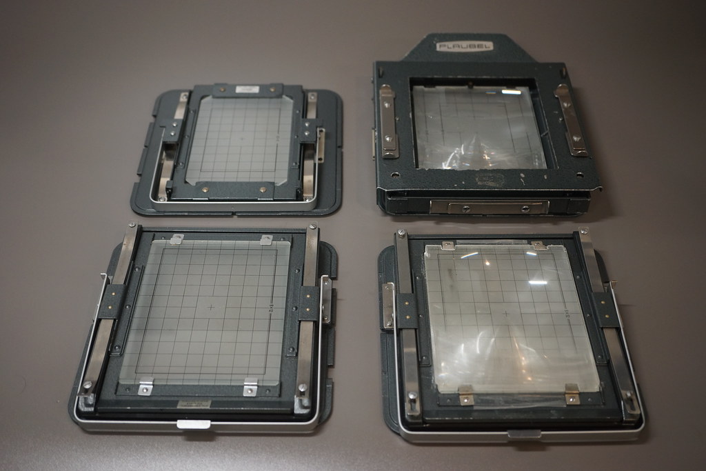

There is a Guy on Ebay that custom cuts fresnels, see the two on the right hand side. I had to cut four slots with a dremel, to accomodate the clips. One locked in, the other needed strips of Scotch Magic Tape to hold it down. Works good and removable. Fresnel side has to face the glass. The back in the upper left takes RADA 9x12cm Single Shot Metal Plates, so the European Way. The other three are Graflex Graphic 4x5 Bail Backs.
Profia 101 No 4 by Nokton48, on Flickr
TTL Metering on the groundglass with the Plaubel Peco Profia Lunasix Adapter. Works good! Needs Bag Bellows on the back, for proper viewing. Which I also have
Profia 101 No 5 by Nokton48, on Flickr

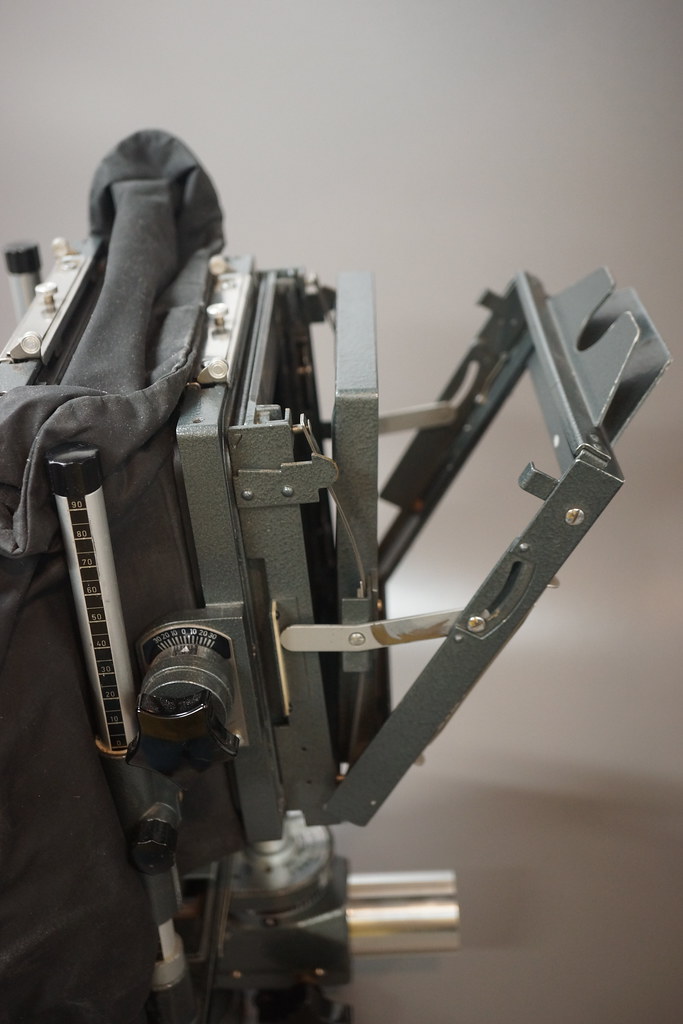

I sawed a long rail in half, to get two Short Rails. Necessary for Wide Work

I got mine from this fellow, I measured carefully and he cut it to the size I needed. He also made Plaubel Fresnels for my my Makinas, an odd size around 6.5x9cm. So ask before purchasing.

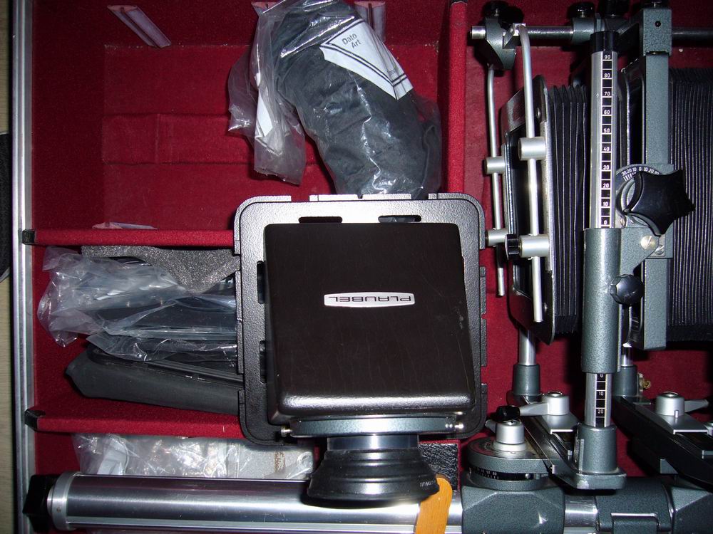

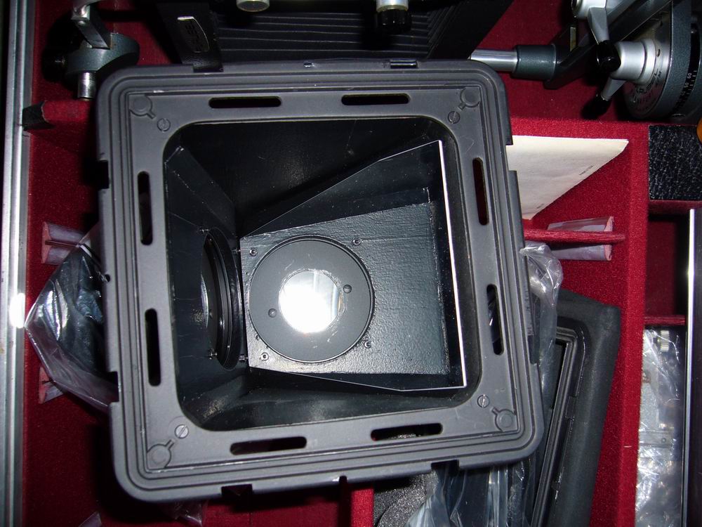

I have the angled finder (w. mirror & 2x magnifying) f. my Profia 4x5. Can be used both horizontaly and vertically and is a joy to use. Recommended! (if you can find it; I've bought mine locally abt. a decade ago, and haven't searched for it on eBay etc). I think it's the item with no PS 440/6 on Nokton's list. (apologize for the messy pictures)
Certain Exposures
Aug 31, 2023
208
USA
Analog
This is interesting, thank you. I'm guessing you can see the whole focusing screen and it's easy for you to adjust focus on the four corners with the view?
lobitar
Jul 17, 2018
271
Denmark
You can see the whole focusing screen okay, but with wide angle lenses there is always the problem with darkened corners. (But I don't personally use wide angle lenses often).
