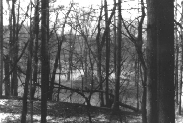

There is no right or wrong answer to the question. I am trying to determine the best way to duplicate what is in my negatives.
I shoot 4x5 negatives and they usually turn out pretty good. When I print them; I crop if necessary, choose the grade paper I want for the contrast and develop them for the time required to get the look I want. The look I want is as close to the natural setting as one can get when trying to convert color to black and white. That is admittedly quite subjective but the goal is to stay as close to my memory of "as shot" with minimal enhancements.
The problem comes when I try to scan the negative or the print into a digital format. The analog to digital format conversion is not very good. It is inevitable that I will have to do some degree of post processing. Since I am not a fan of post processing and after chasing my tail a number of times in the past; now, I simply crop, adjust the contrast and call it done. Attached is a pinhole photo I scanned.
It has been my experience that trying to duplicate a back-lit monitor image onto reflected light photo paper is near impossible, or at least requires far better equipment and knowledge than I have. The back-lit white is always brighter.
So the question is, how much digital manipulation do others do to their pinhole prints.
Down the Hill to the Pond
Party cloudy and windy day.
ISO 200 film
f360 at 68 seconds.
