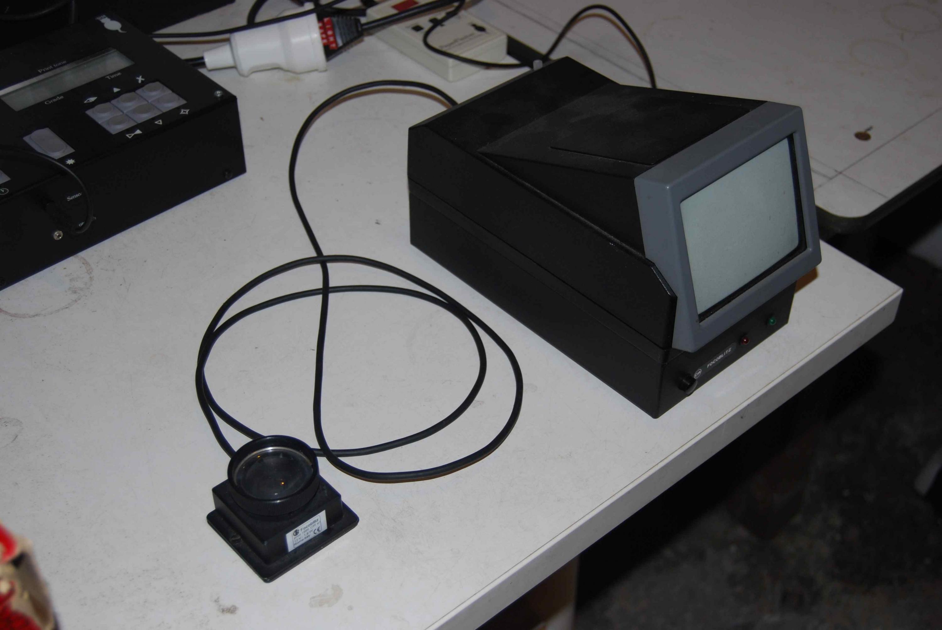

I acquired a Focoblitz several years ago. I think I paid GBP100 or so for it; it is a precision laboratory instrument, and they come up on eBay about once every other year. It was made by a company called CIR somewhere in Europe. It is mains powered . The sensor you can see has a lens which sits on your baseboard and focusses the grain on some sort of photo-electric cell and reproduces the grain, greatly enlarged, on the B/W cathode ray tube display. You can judge its size against my RH Designs Analyser 500 in top left of picture. Not sure for what purpose they were originally made.

The reason I don't re-focus with the Focoblitz every time is firstly, that I don't need to; and secondly, being a cathode ray tube there is persistent glow after switching off; whether that would be a problem, I don't know because I haven't tested it.
