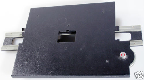

Beseler makes a negative holder that allows you to move to the next frame. 35mm & 120 size. No need to refocus if making the same print size, just a quick magnifier check if needed. Never had a problem although I am usually making a lot of smaller prints.
That's pretty neat! That's the negatrans that Eddie referred to? I usually make smaller prints too... I can imagine using one of these, especially for the kind of printing I was doing this week. Wow, learn something new every day!
eddie
Jul 24, 2005
3,259
Northern Vir
Yes, Ned. That's a negatrans. I had both the 120, and 35, for my 4x5 enlarger. They do make them for the 23C, too. They are expensive if bought new, but you can get them on ebay for $30-50. Nifty gadgets if you're printing more than one negative from the same strip.

I have used it and one of the specialty paper easels so I could print a whole roll of 2x3, 3.5x5 or 4x5, or 5x7. The easel moves the 8x10 paper underneath a frame mask.
