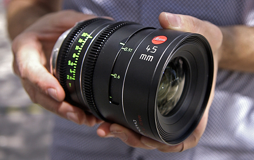

From my "feeling" Leiz is an other example were one is allowed to state a brand with such or such special characteristics is given. And this company (during all the time in the near of bankruptcy)
have done a real hart job to advance on the top.
The latest impact to Leica is their coming reputation on Film works - but (also) here Leica is top in lens characteristics AND top in highest pricing.
best example is Leicas Thalia series.
