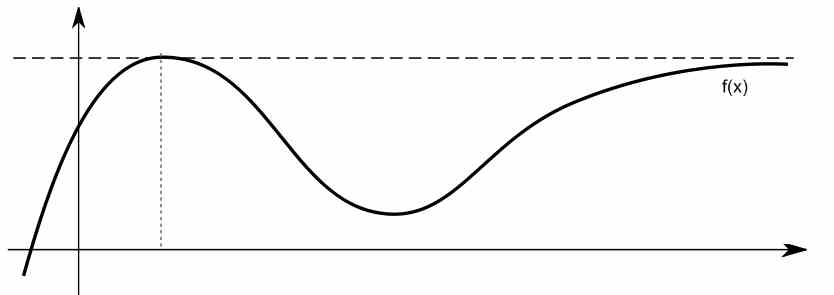

Here is an example of a picture:
The vertical axis is quality, the horizontal axis is time spent, and the dotted line represents excellence.
The large dip in the middle is where you are spending time over-thinking things!
Note that as you move toward the right, and add more time, you are getting closer and closer to excellence, but you never get there completely (that is the asymptote).
The curve is probably not logarithmic, but it looks sort of similar, and I couldn't find what I needed quickly :smile:.
