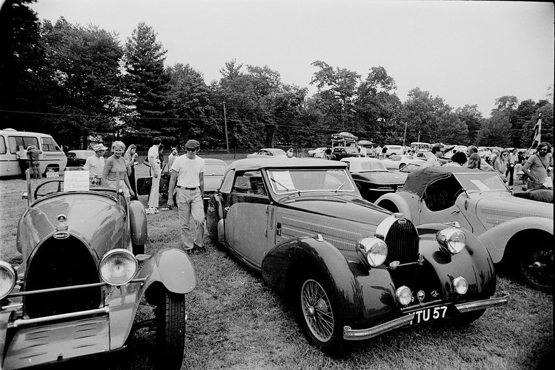

Come on, Matt, let’s see some bellbottoms!
Bugattis 1975 New Hope Auto Show by Michael DeLuca, on Flickr

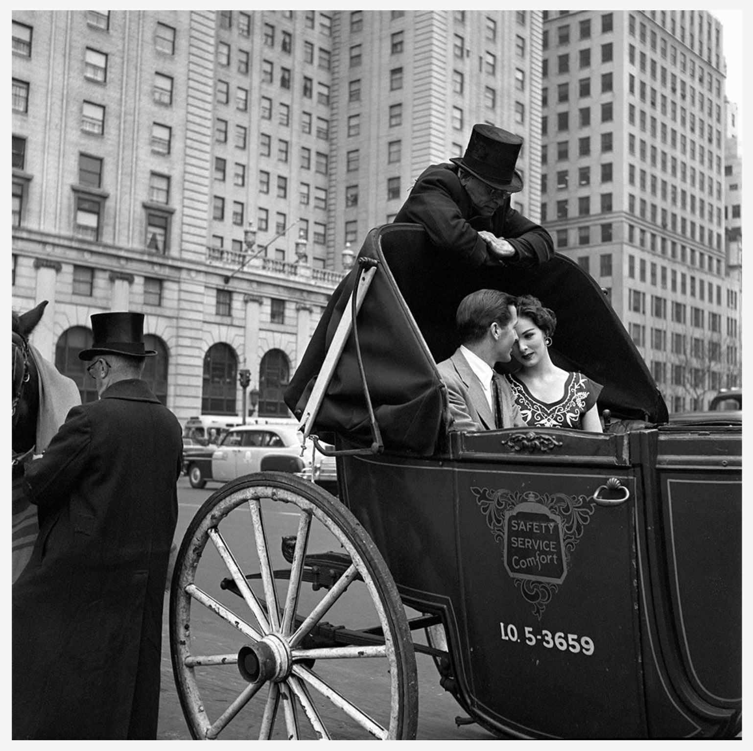

I wish I can get a tonality like that of the Vivian Maier in #60.
I once shot a roll of modern 35mm 400TX and a roll of Double-X 5222 at the same time, then processed them simultaneously in HC-110. I liked prints from the latter more.
