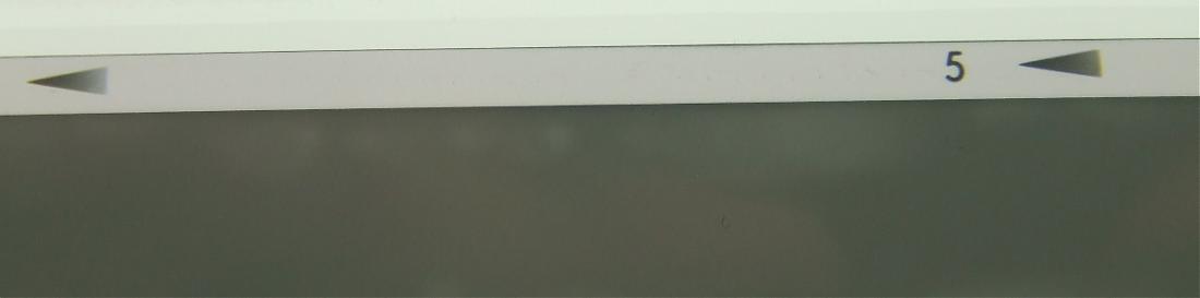

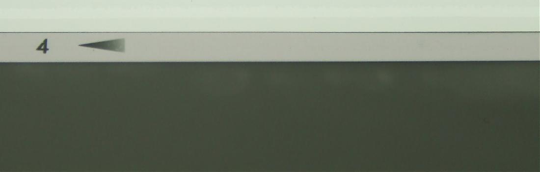

here are a few digital snaps as best I could

These marks may vary but are regular. I can space them evenly with measurement on my screen. They also appear to be 3rd party film. This can be a film or process defect, but it is hard to tell.

It is Fuji Acros 100 purchased from Freestyle, processed in xtol 1+1 with distilled water and then Ilford rapid fix.
