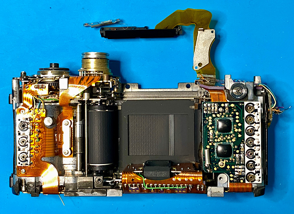

Less space than in a submarine: artfully installed electronics in the Nikon F3 from 1980.
As cameras are even more cramped than in a submarine and free space is scarce, the electronics are intricately integrated into the camera housing.
The circuit surrounds components on a flexible board, is connected via cables that run across the housing, and is artfully woven into the case, sometimes on several levels.
In order to accommodate all of the camera's functions, there are usually only integrated circuits (ICs) that are soldered onto the circuit board as small black blocks. These ICs are usually not documented either, as they are a manufacturer's secret.

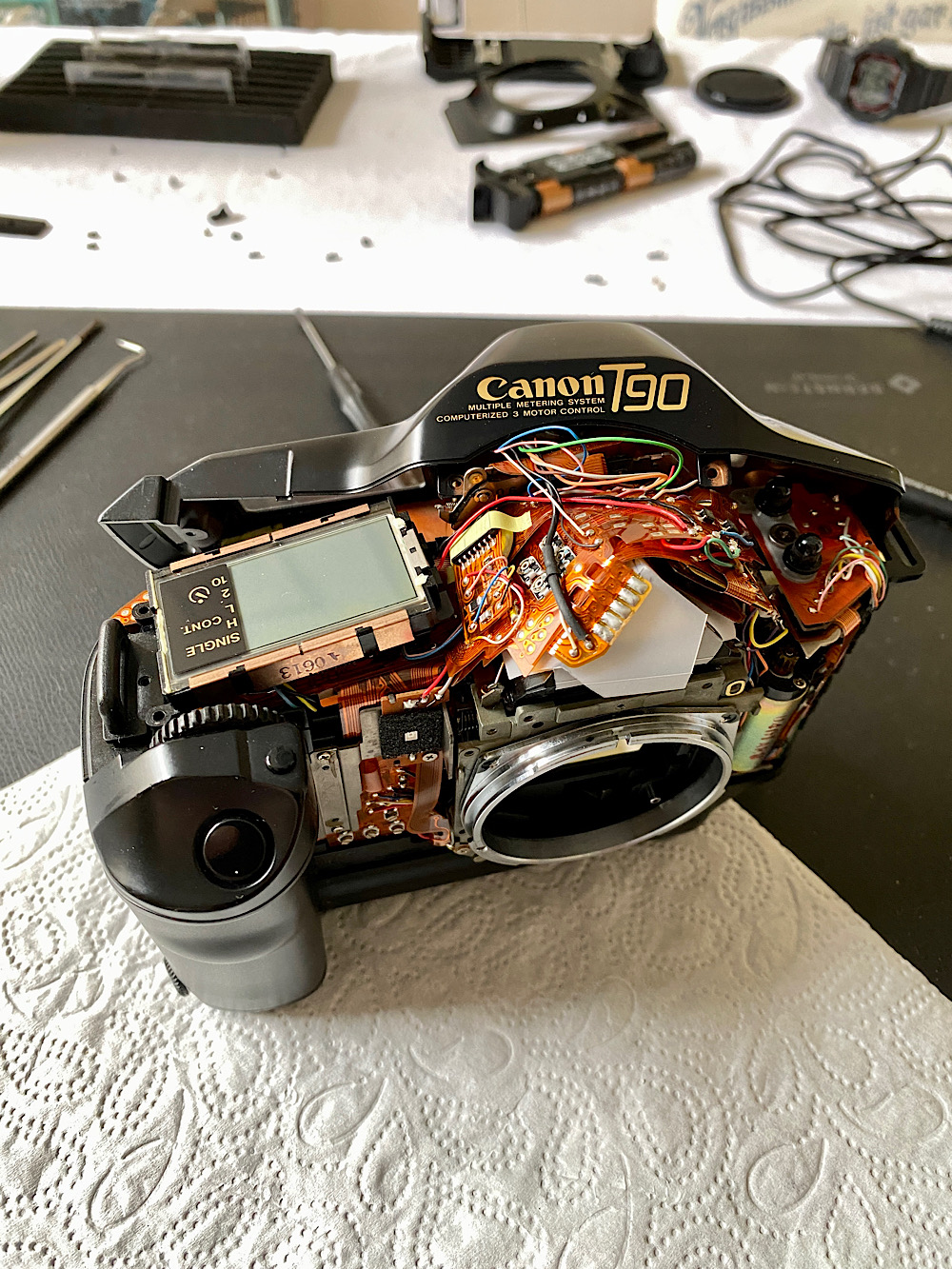

Masterpiece of Japanese circuit board winding art: Canon's T90 from 1986. Here the flexible conductor tracks run in layers on top of each other, which makes access to the camera's built-in components almost impossible.

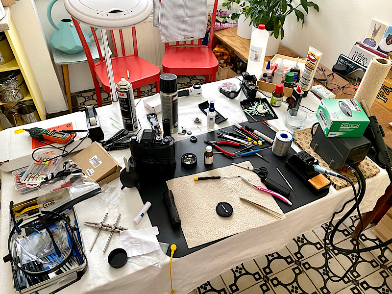

Nevertheless, it is often amazing what you can do yourself in a repair case.
What you need to get started is not much and certainly not expensive:

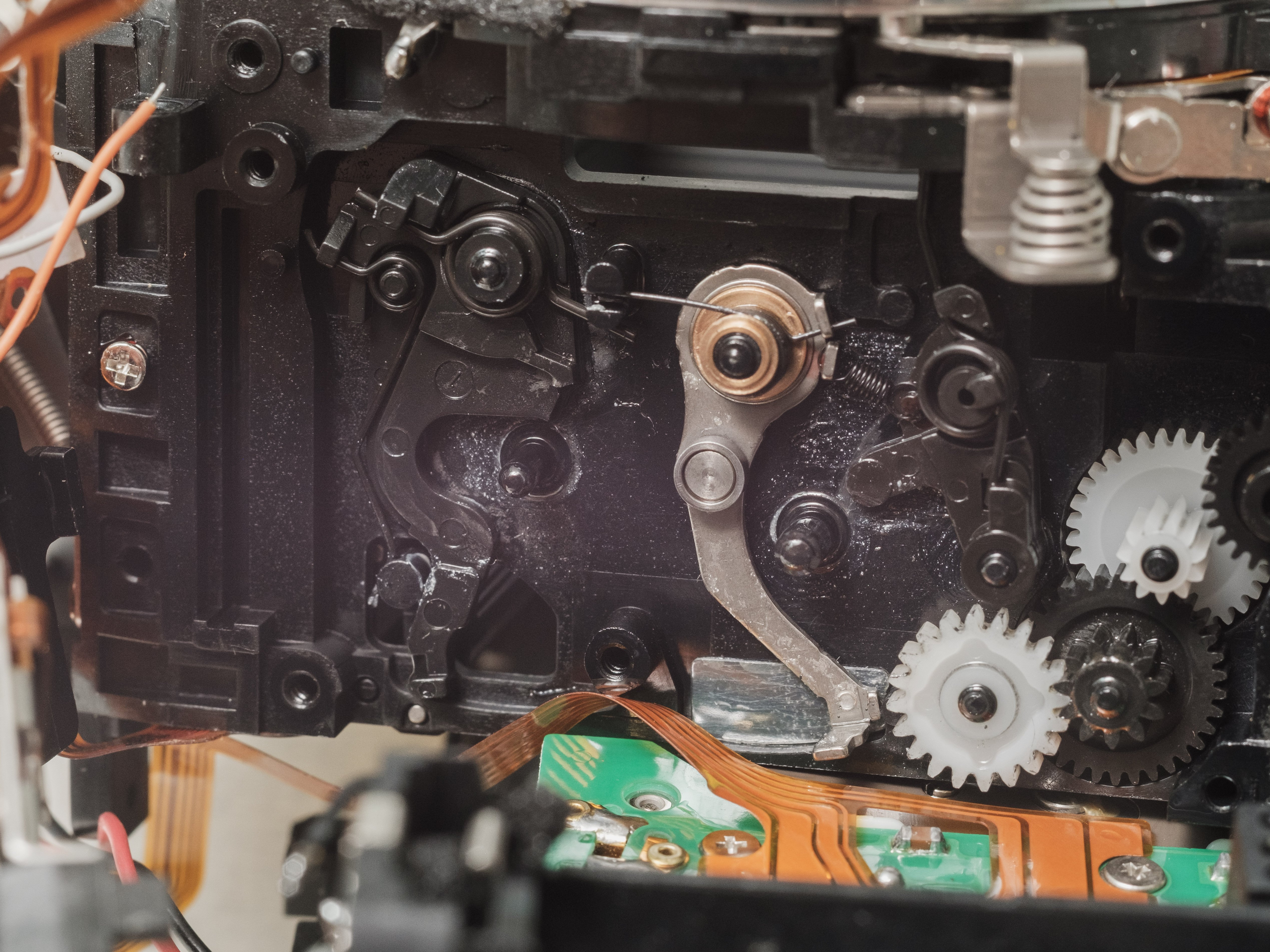

Additionally, even with electronic cameras, a lot of the failures are in the mechanical components, which are reasonably easy to troubleshoot. Parts can sometimes be reconditioned and sometimes replaced with newly fabricated parts.
Are there limitations? Sure. But there is also a ton of doable work. It's way too harsh to right off this entire generation of cameras as lost causes.
