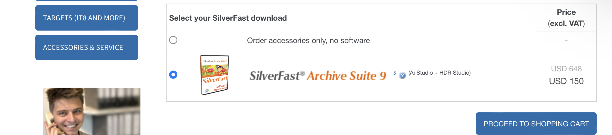

iHDR is an upgrade which costs extra, correct? My version is what came with the scanner. Their upgrades are pretty pricey for me.
I don’t agree. They have specials all the time.
This is today upgrade from the SE version
I think I paid more then twice that.
It’s the price of a restaurant meal…
