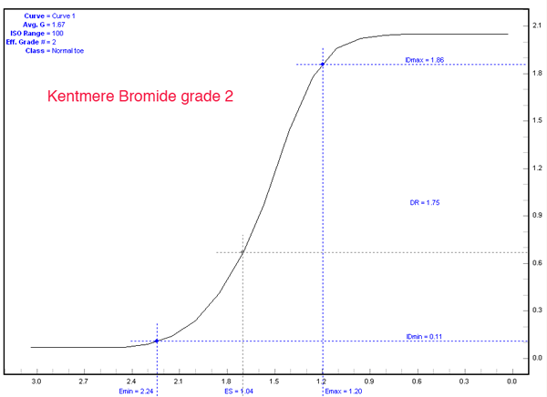

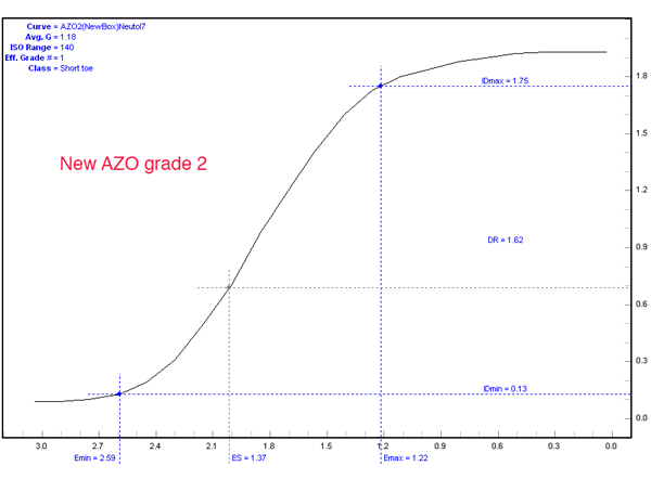

Kentmere Bromide and AZO curves
Here is a comparison between the Kentmere Bromide and new AZO grade 2, both developed in Neutol WA. There seems to be a large difference in how both papers respond to exposure. Neither paper has had selenium toning at this point of testing.
Fascinating.
Now, here is an interesting experiment for you.
Read them both again but using transmission densitometry. Please post the results, and I will be glad to explain anything 'unusual' that you see in this new plot.
Oh. I would also suggest that you redo the original pair but with a 50 second, 5 second and 0.5 second exposure using a neutral density set to 'normalize' the positions on the charts as much as possible. You may see something 'unusual' in this as well.

Sandman, without knowing more about your testing parameters, I’m going to suggest that paper reciprocity is at work in some respect here.
Steven, one of my suggestions in my last post involves a test for reciprocity effect.
I believe that there is a contrast reciprocity effect active in this, and also a coating problem. That is the purpose of the first test I suggest.
Paper, or reflection materials in general involve some peculiar effects when viewed by the human eye. Few people know how or care to test extensively to understand reflection materials. Well then, few people test films completely. They rely on the human eyeball and judgment which are not very good.
I would have suggested the use of goniophotometry in addition, but few people in the world even know what it is let alone have the equipment to measure for it. (It is the essentially the measurement of refllection density as a function of viewing angle and angle of the illuminating light)
PE
Ron,
I must say you have intrigued me with the suggestion that the thumbnail curves of AZO No. 2 and Kentmere Bromide 2 show signs of reciprocity effect and a coating problem. To me they just look like normal curves one would expect form these papers, with the caveat that the ES of the new AZO 2 paper is quite a bit shorter than what most people have reported. My own curves of this paper, for example, with both Amidol and Ansco 130, show an ES of around 1.60.
So what is it in the thumbnail curves that suggests reciprocity and a coating problem?
Sandy

Sandy, it was actually the problem that people have been having with the last batch of AZO paper that clued me in, as well as some other information such as the fact that AZO really looks best with ultra long exposures which allow lots of dodging.
Bingo! A clue. Something began churning in my mind and suddenly it came to me. Silver laydown error and/or LIRF/HIRF problems.
Oh, that and the fact that I had the same problem making my own AZO here in my DR, which I had to solve. LoL. Yep, BTDT. And, not on purpose.
So, that is my thinking FWIW.
PE

Sandman said:
Paper reciprocity might be at play here, but anyone who works with AZO knows how slow this paper is and how such very long exposure times relative to 'normal' paper (eg Kentmere Bromide) are usually required. It makes me wonder if some this paper's admired printing characteristics can be said to revolve around this 'reciprocity result' if it is actually there.
The Kentmere wedge was contact printed with a 7.5 watt bulb at about 30 inches height above the printer. I think the exposure time was about 15 seconds. To print the AZO with fully exposed steps I had to switch to a 75 watt bulb at the same height and increase time to 25 seconds (if memory serves me right, as my notes are not here).
It would be interesting to re-test AZO with increased light for shorter times and see if the shoulders change. If they do, reciprocity is certainly a factor. If I could prove to myself that reciprocity is present in the curve I've posted it would be interesting in an academic sense, but I doubt it would impress a died-in-the-wool AZO user who would probably just say, "So what?" That is, the curve is there and if AZO prints a certain way because of it's shape why not take advantage of it?
I've not given much thought to shortening my printing times with AZO as my usual times (25 to 45 seconds with most negatives) seem to be pretty much in tune with what other AZO printers seem to be doing routinely.
At this time, I've only tested a few papers. I remember how strikingly different the AZO plot first looked when I first saw it. One of the problems, I realize, when posting test results is that a guy like me tests papers and film for my own use and my results might have a limited value for intrepretation by others.

sanking said:
I have plotted curves of AZO 2 from 1926, 1946 and the contemporary period and there appears to be very little difference in the shape of the curve, though the older material had a bit more contrast and slightly higher B+F (1946) and much higher B+F (1926).
Are those curves obtained by your own sensitometry work in recent years or are they obtained from Kodak or third party tests shortly after the emulsions were manufactured?
If you did the sensitometry work, can you comment on the possible difference on the image hue? (especially if you could mention in the case of Dektol 1+4 or something standard without organic antifoggants or amidol)
Also, are those different vintages similar in speed?
Thanks!
Ryuji
The tests were done by me within the past couple of years with vintage samples. I still have some of the vintage material and might run farther tests at some point in the future.
Here are my observatons from the plots, based on development in Ansco 130.
First, for AZO 2, comparing the new sample with a 1946 sample.
1. Dmax was approximately the same for the old and new samples.
2. The new AZO was faster by about 2/3 of a stop.
3. The new AZO has a longer exposure scale than the 1946 AZO, log 1.58 versus log 1.42.
4. No apparent difference in hue, but the new AZO appears to have some kind of optical brightened added as it appears visually brighter even though there is not much density in paper white.
AZO 3, new sample versus 1946 sample.
1. Dmax is about log 0.15 higther with the new AZO.
2. The new AZO was faster by about 1/3 of a stop.
3. The new AZO has a slightly shorter exposure scale than the 1946 AZO, log 1.07 versus log 1.16.
4. No apparent difference in hue, but ss with the new AZO 2, the new AZO 3 appears is visually brighter.
Sandy
