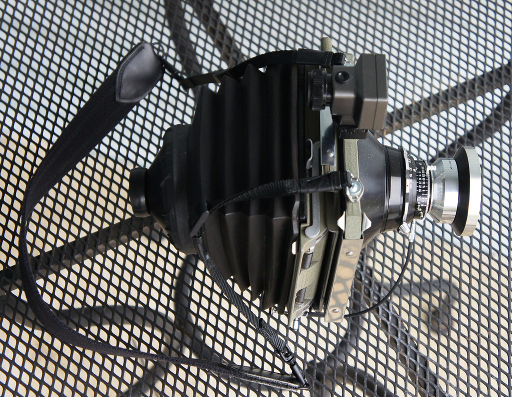

Sinar Norma Handy ready to go. On the back is the rare Sinar Norma Monocular Rubber Bellows, with the Norma Monocular Viewer. With a short locking cable release, I can view through the lens if I need to. I can also insert Sinar Norma 4x5 Meter Cassette, with Sinarsix, deadly accurate TTL metering eliminates a lot of exposure variables, some of which can compound. So uber versatile. The strap is a 1.5" Domke Black Gripper, the strap lugs are Pentax 6x7, I drilled and taped the Norma Auxiliary Frame. Devil Cal on RFF kindly supplied the stainless steel bolts holding the strap lugs. I bought the Graflex XL Grip (Norma used this) from Glenn Evans, I'm not using the Grip for now. I can nicely handhold this all day long
4x5 Sinar Norma Handy 65mm f8 SA Viv365 C Cell Pack by Nokton48, on Flickr
This is my Sinar Norma Handy, built by me from Parts Box Vintage original Norma Helical Mount for 65mm F8 Chrome Super Angulon Compur. Vivitar 365 with C Cell Pack fully operating. The camera is complete ready to shoot, I have three left in this 4x5 Graphmatic. The 365 has the power I need for handheld 4x5 Wide Angle Tripod. I will embellish with XTC Mini Inflatable Softbox soon. I have six loaded 4x5 Graphmatics with HP5+ and TMax400, as a side by side test.

If you want Norma, buy a cheap AUXILIARY STANDARD. That will hold a helical lensboard, and a Norma 4x5 Film Back. Add a Viewfinder, I used a MAMIYA 7 Viewfinder. The STRAP LUGS are from the Pentax 6x7. Remove the metal pins on the Standard Bearer, and attach a Shoe on the top and bottom. There are so many ways to do this, I wanted Real Original Norma Parts. Good Luck. Mine is a work in process as I use it.

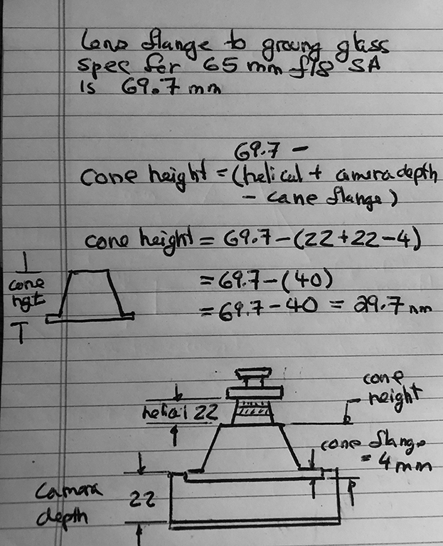

Sorry to resurrect this old post, but does anyone know how tall/deep the Sinar lens cone is for the 65mm Super Angulon? I am trying to make one of the cameras and I am missing the cone. I have the 65mm f/8 SA with the original helical, but no cone! Any help would be much appreciated!
All the best,
Paul

Hi Paul,
Just saw this. OK Using my cheap Harbor Freight Digital Caliper, I got what I think is pretty close as I can get it.

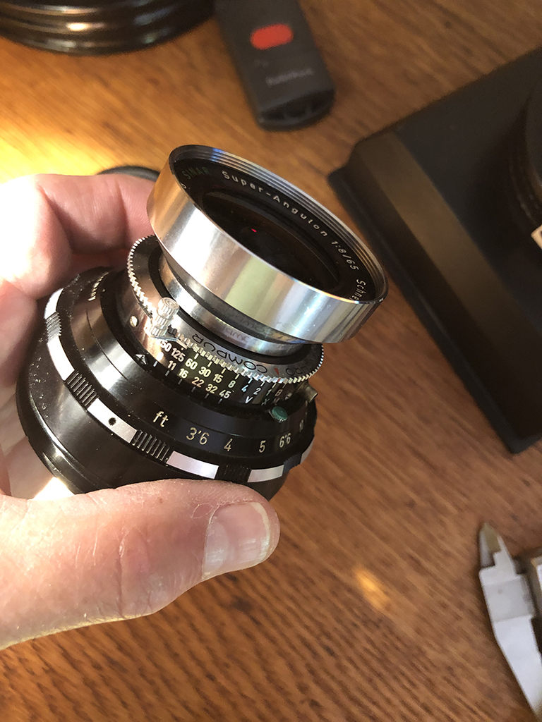

It's 24.3mm. My board is marked in feet for the 65mm F8. How is yours marked?
HI!
Just seeing this myself! Thanks so much for the reply. I am having a cone made up for me by Ebay seller CustomCameraBuilding who is based in Canada. (He's only charging $30 for a custom build, btw.) With my cheap General digital calipers I measured the focus helical and the thickness of the Sinar F camera standard which serves as the camera body. I asked him to make the cone 29mm tall with a 62mm hole.
I have attached for you here a photo of my helical which is marked in feet for the 65mm f/8. I have also attached my calculations which show the cone should be 29.7mm tall ( or 25.7mm if you don't include the flange at the bottom of the cone. I also included part of the Schneider tech sheet for the super angulons. Tell me if you'd like the whole pdf.
If you measured the depth of your lens cone from the front face of the camera standard the dimension would be off by about 4-5mm compared to mine due to my including the height of the flange around the bottom of lens cone. Yours sits on top of a standard Sinar lens board. Mine fits in to the camera body as if was an extended lens board. I measured from the mating surface of the back of this lens board. I think this would account for the discrepancy in our numbers.
I am currently using the camera with a 90mm f/8 Angulon (as shown in the last pic), but I want something wider!
By the way, do you happen to know if this helical can be used with the 65mm f/5.6 as well as the f/8? And if so, would the distance information be correct?

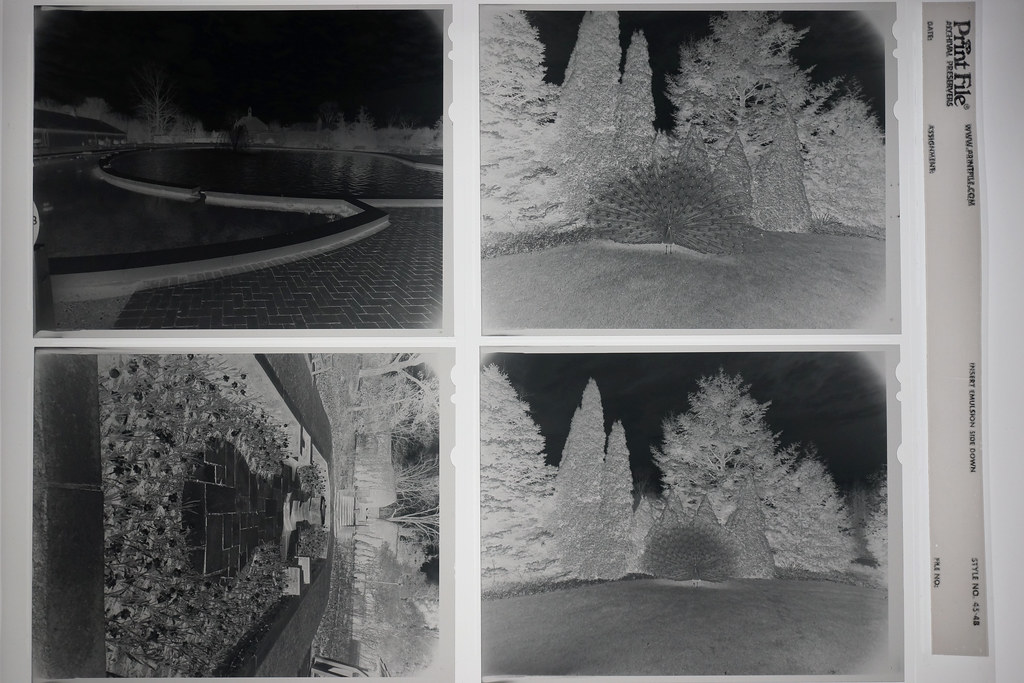

Nice photos of the Peacock! I am surprised to see what appears to be some vignetting on the right hand side of you negatives. The 65 f/8 should be able to just cover 4x5.

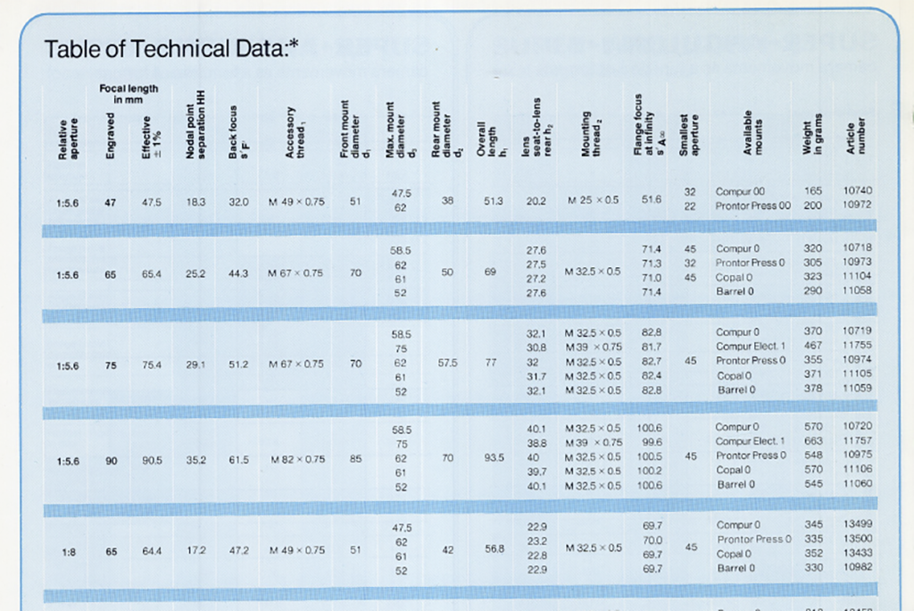

The 65/f8 is usually in a 00 shutter, they did come in 0 but those are really rare...
I don't think the distance scale would be interchangeable (but I don't know for sure)
The distance scale is only for the specific model of lens it’s made for. It won’t even match up with other lens models of the same spec. It might not even match for the same model but different years of production depending on what changes were made from version to version.
Thanks Chuck and T! These units must all be shimmed and individually calibrated. Precision engineered, certainly, but what a manufacturing nightmare!

My olde Schneider literature indicates that it covers 9x12cm. This is what I am finding in actual use. 4x5 will require a bit of cropping all around, you can see all four corners really. I plan to shoot with mine with 9x12cm film holders, of which I have plenty. The Norma has a slightly smaller footprint than the modern Handys, which I also prefer. Finally I would suggest the 47mm Optical Finder for the Mamiya 7, that it what I have, and I love it. Has a really cool bubble level which you can see as you are framing. Recommended! Find a copy of the original Handy Sinar literature, it will give you some good ideas.

Sinar Norma Handy Test 65mm F8 No 1 by Nokton48, on Flickr
Sinar Norma Handy Test 65mm F8 No 2 by Nokton48, on Flickr
Sinar Norma Handy Test 65mm F8 No 3 by Nokton48, on Flickr
Sinar Norma Handy Test 65mm F8 No 4 by Nokton48, on Flickr
Sinar Norma Handy 4x5 Test Ilford HP5+ 65mm F8 Super Angulon at Fll. Kingwood Gardens Mansfield Ohio, waiting for the Solar Eclipse to occur. HANDHELD camera focused hyperfocally. The cosine effect causes corners to be darker, could be improved with my 65mm F8 Schneider Center Filter. Silver image 8x10 print Omega DII 180mm Rodagon laser aligned, Arista #2 RC paper processed in Dektol 1:2. Print copied with Sony Nex 7 30mm Nex Macro Lens.
