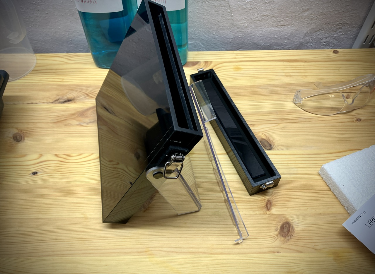

Just an update. Too many other projects in the works so I bought a commercial available silver nitrate bath tank from Philippe at Lerouge-Camera. Superb quality👍
