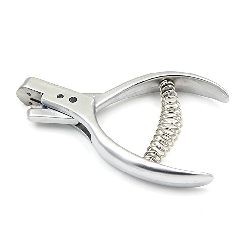

What is that for a kind of punch?
Here's a sewing pattern notcher. This one cuts a 1/4" x 1/16" notch. The 1/4" is too long. 1/16" x 1/16" would be ideal.

With that sewing pattern notcher I picture taking a strip of aluminum or brass about 3/16 wide and forming a 'C' shape to wrap around the big lower jaw with the ends bent to create a limit to the jaw depth. It could be anchored with some silicone adhesive (or epoxy or whatever). (As cheap as that is, one could even afford to make a mistake!)
