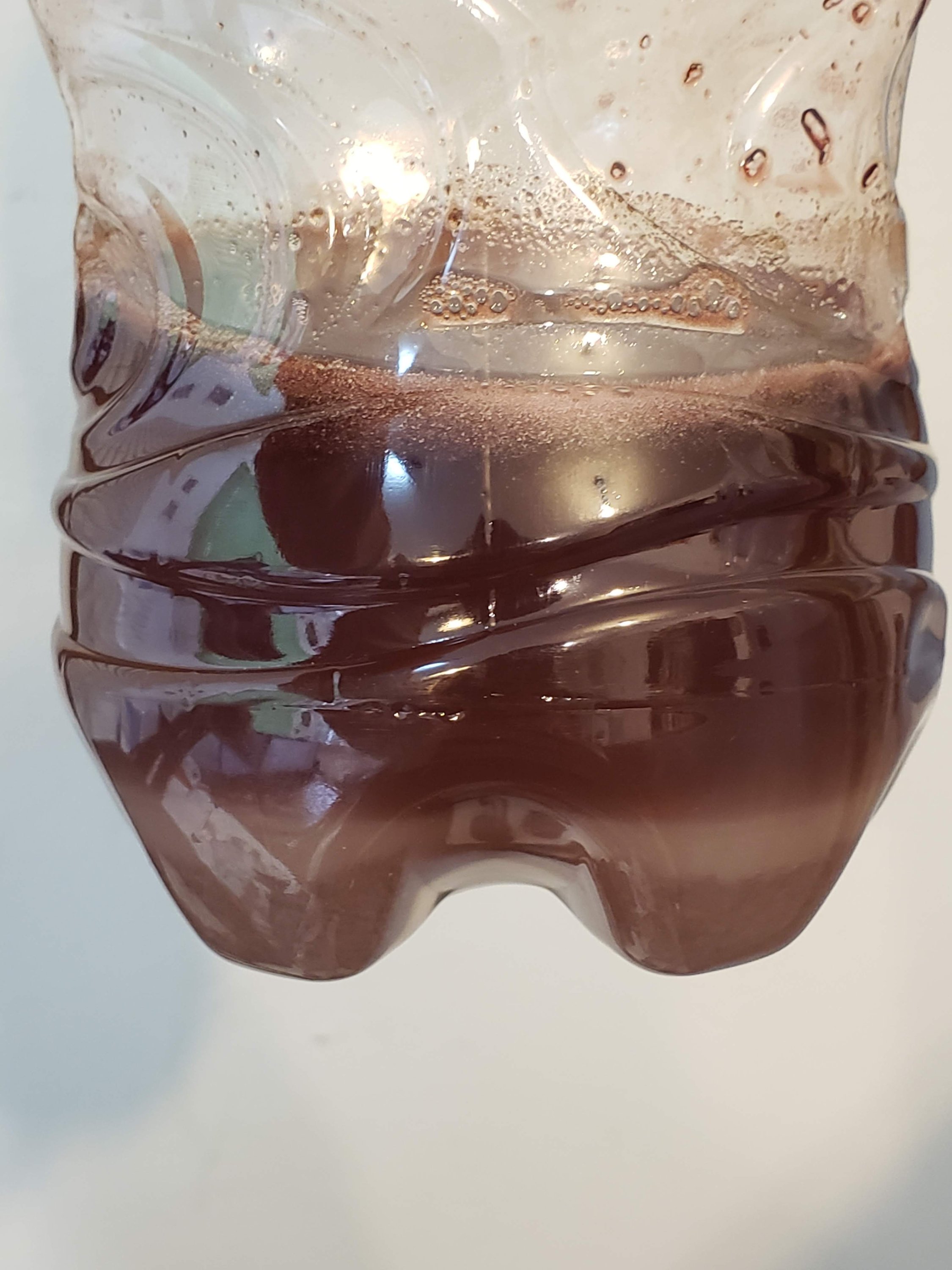

Hi, I did my second batch of homemade rodinal https://varezers.org/rodiynal/ in the first batch I keep the crystals on the bottle but I had to filter the diluted developer before using it because it has a lot of stuff floating, Can I just filter the whole batch after waiting 3 or 4 day and the bottle it? or the crystal are somehow needed?
If the crystals were Sodium sulphite, they should have dissolved readily in the diluted developer. I suspect that the floating stuff is probably not sulphite. Btw what colour do the crystals and floating stuff have?
Like this
Oh you're using Paracetamol tablets! The floating stuff could be some filler material (i.e. inactive ingredients) in the tablets.
So ok to filter. Normally use some cotton or Even coffee filter in a regular basis. I don't think there in any effect. Do high dilutions all the time and performance is consistent enough.
