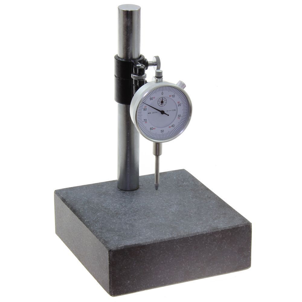

For checking flange-focus one can also use a granite check stand with a dial gauge. You stand the camera on the film rails (piece of glass + precision block). You would likely need a reference block as tall as the flange focus distance to set the zero point. I don't have one (yet?) but they are not too expensive.

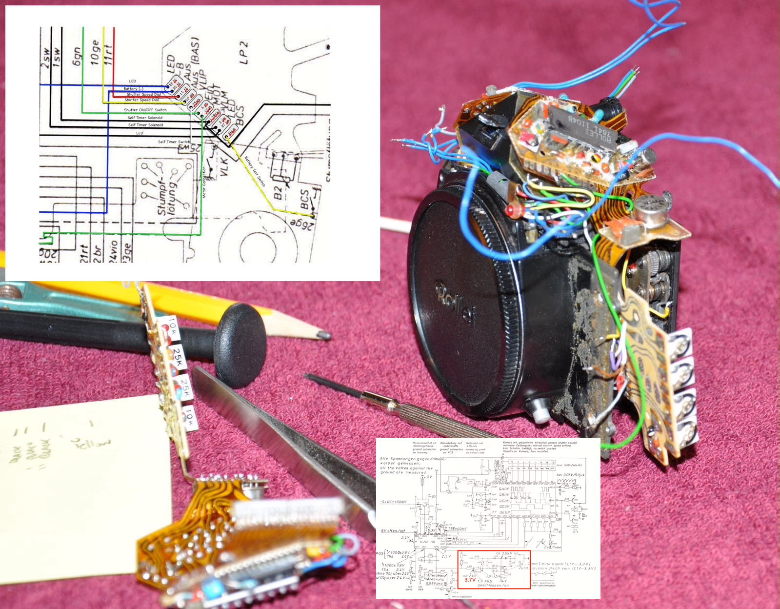

Nice that the camera he is using has the common buss. I do like the way he used the little dip switches. When contemplating something similar, I was going to use a separate camera body for the 10 or so switches needed to test anything on the circuit.
The camera in the picture was repaired with a NOS circuit board.
