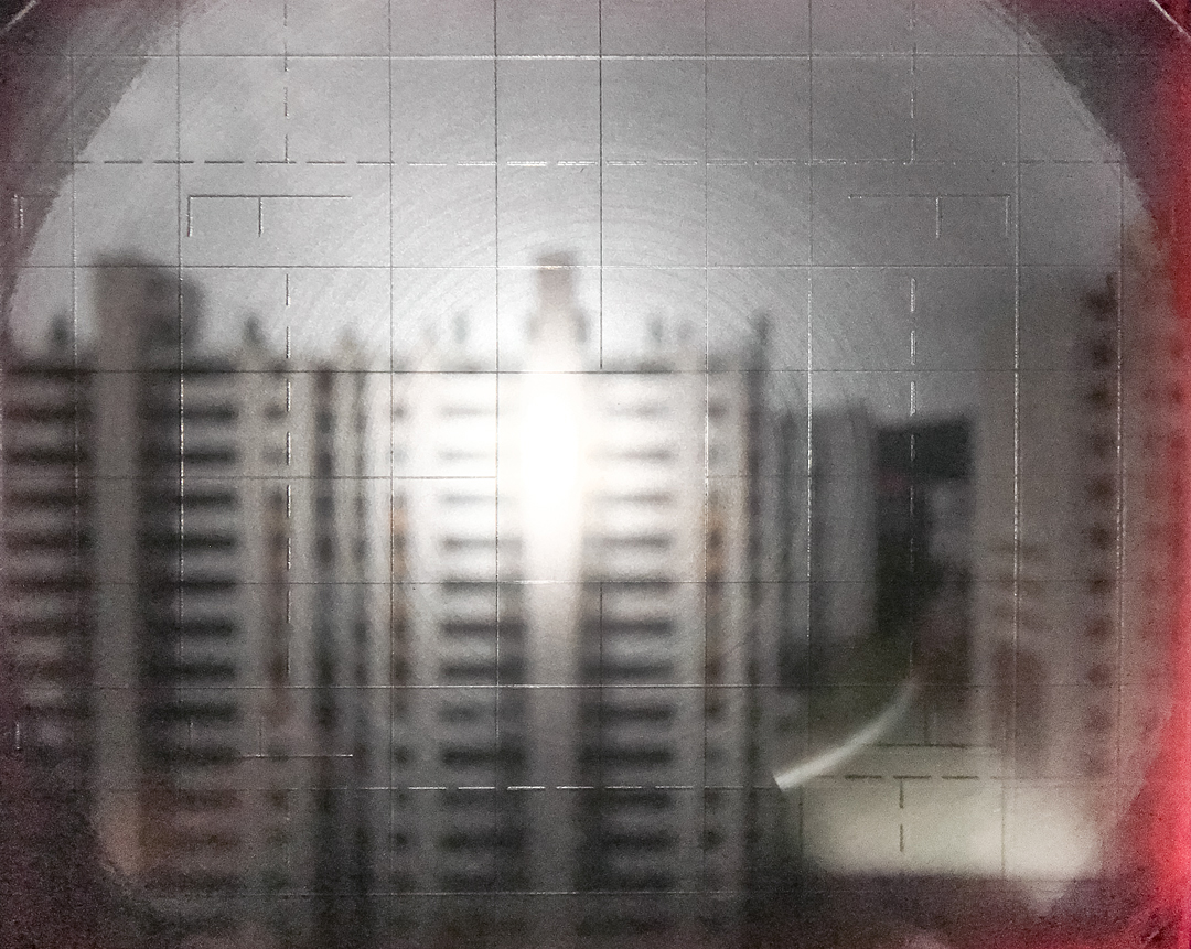

I've gotten into extremely wide pinhole shooting the last couple years, but framing has been hit-and-miss. I finally found a cool solution; I got one of those fisheye lens adapters that clips to my phone; I rest it against the lens and take a pic. In my case, the fisheye was a great match to the camera's field of view. I think I'll build something on my 4x5 to where the phone can rest on the front with the lens positioned accurately, so I can just set it on the camera and snap it; might even buy a cheap used iPod with camera and hot-glue the lens to it.
It's upped my keeper shots to a great extent; the phone pic is barrel-distorted to all hell, but framing is very close to my final shot. Wonder what others do who want more accurate framing?

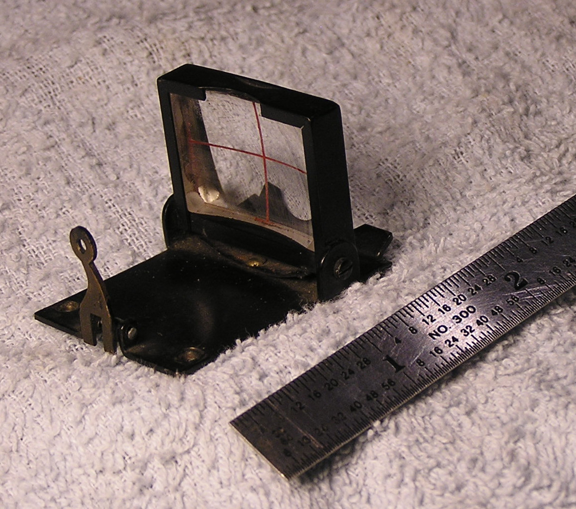

I made a mat board prototype of a wire frame finder for use with the body cap pinhole adapter on my Bronica with the intent of eventually making a collapsible version in some matte black anodized aluminum stock I had. After a day of working with it, I concluded it didn't work well enough to be worth the trouble. Later when I built my 8x10 pinhole, I installed short small diameter dowel pegs for sighting. The locations were easy to deduce from the working drawings I made to construct the camera. Those work pretty well, with the caveat that the ones on the end have to be used before installing the filmholder, as it blocks the line of sight.
Both cameras are rather wide angle, particularly the 8x10. Perhaps some sort of optical finder might work better than a wire frame, dunno. Unless some appropriate off the shelf finder from decades back was available, that strikes me as getting too far away from the simplicity I associate with pinholery. But that's just me!
