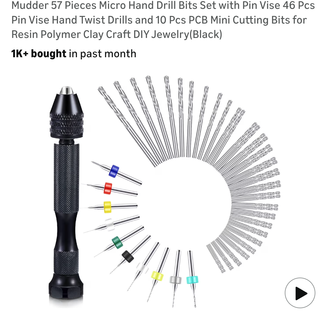

I have done DIY myself, the best come out from those mini hand drill bits which has different sizes.
