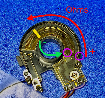

The functionality of this ring resistor for ASA and exposure correction on a Minolta X-700 can be explained using Ohm's law.
Depending on the position of the wiper (not visible here, represented by the yellow bar) over the segmented gold-plated resistance track, more or less current flows and thus the voltage wiper to ground (green arrow) also changes.
Ohm's law shows the relationship between voltage (U), resistance (R) and current (I, German notation):
U = R * I

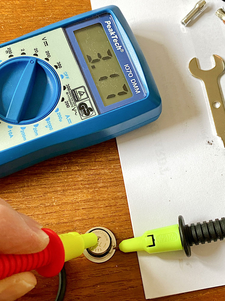

The multimeter

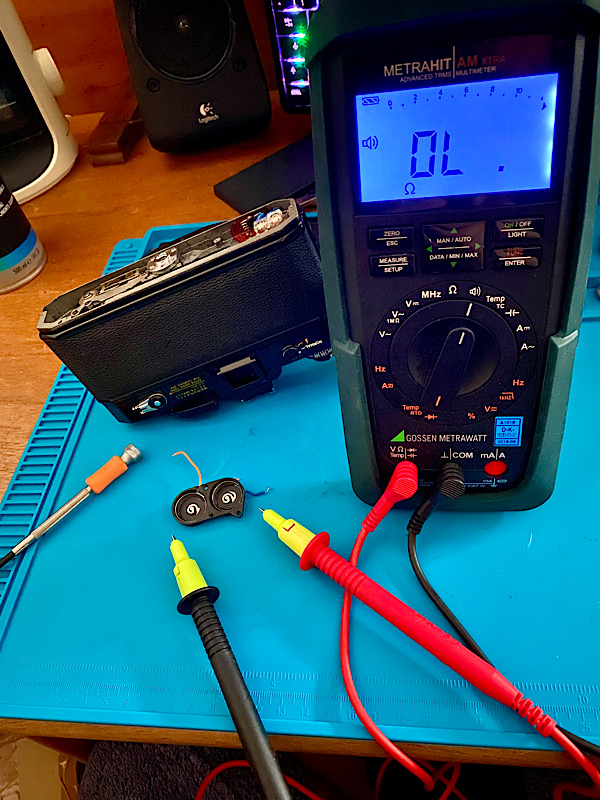

is primarily used to measure voltage, current and resistance.
In addition to the latter, there is a continuity test, which provides information about whether current is flowing freely or not.
An inexpensive digital multimeter
that measures accurately enough for our purposes is sufficient for these functions. Such devices can be purchased for under EUR/USD 50.

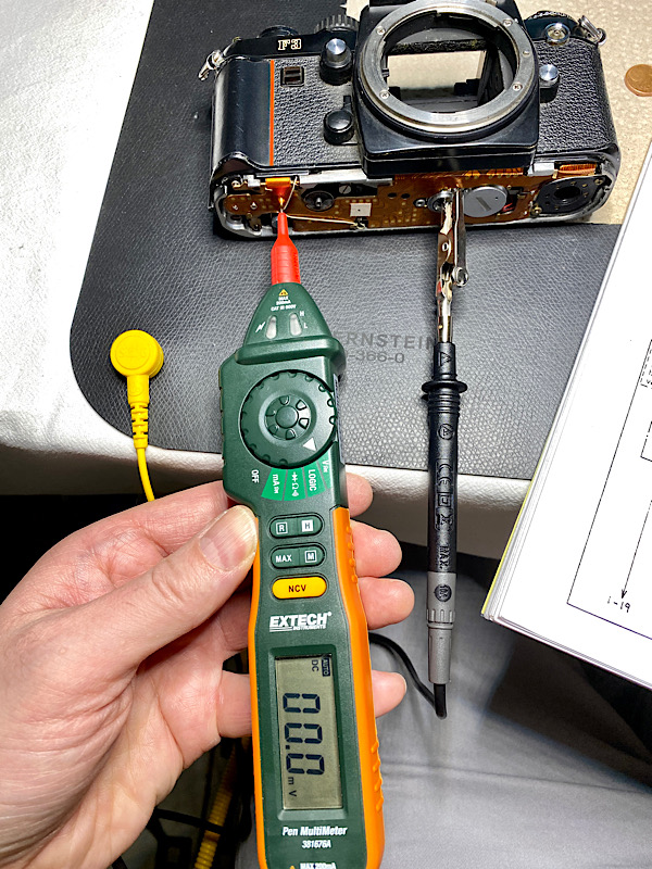

Multimeters usually have interchangeable measuring tips, except for very simple devices.
Crocodile clips or spring hooks are very useful for attaching the negative lead (COM) to ground. This leaves one hand free when measuring (see picture # 2 above).

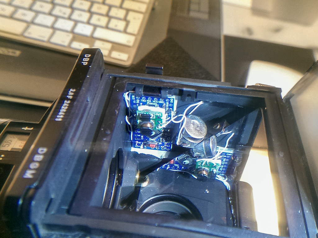

I agree that most electrical problems in cameras are caused by basic stuff, corroded wiring, oxidized contacts, etc. But I would avoid making statements like "There is not much that can be done about electronic problems."
This feels like a statement of your own personal limitations rather than hard unknowables. For example, I know I'm more mechanically minded than electrically minded, but just because I don't know how to do something doesn't mean it can't be done. Things like replacing a silicone photo diode or a solenoid with modern off-the-shelf components is possible. I don't have the knowledge to do it, but I'm sure somebody does. I bet somebody could even program a micro to control an electronic shutter if they had the desire. A Pentax ME is a remarkably simple camera once you understand what it's actually doing. I would not at all be surprised if somebody reprogrammed one from scratch. Impressed but not surprised.
The only thing missing in the current environment is motivation. There's no need to resort to these solutions because donor bodies are still plentiful and cheap. If this hobby were more popular and Pentax MEs were selling for $1000, you can bet somebody would start engineering replacement parts. Or if there were just a lot more talented minds doing this stuff, somebody would eventually get interested enough and make it happen. The number of people repairing cameras is tiny compared to other tinkering hobbies like retro computing, for example.

This person figured out how to drive a galvonometer using an arduino and a light sensor
