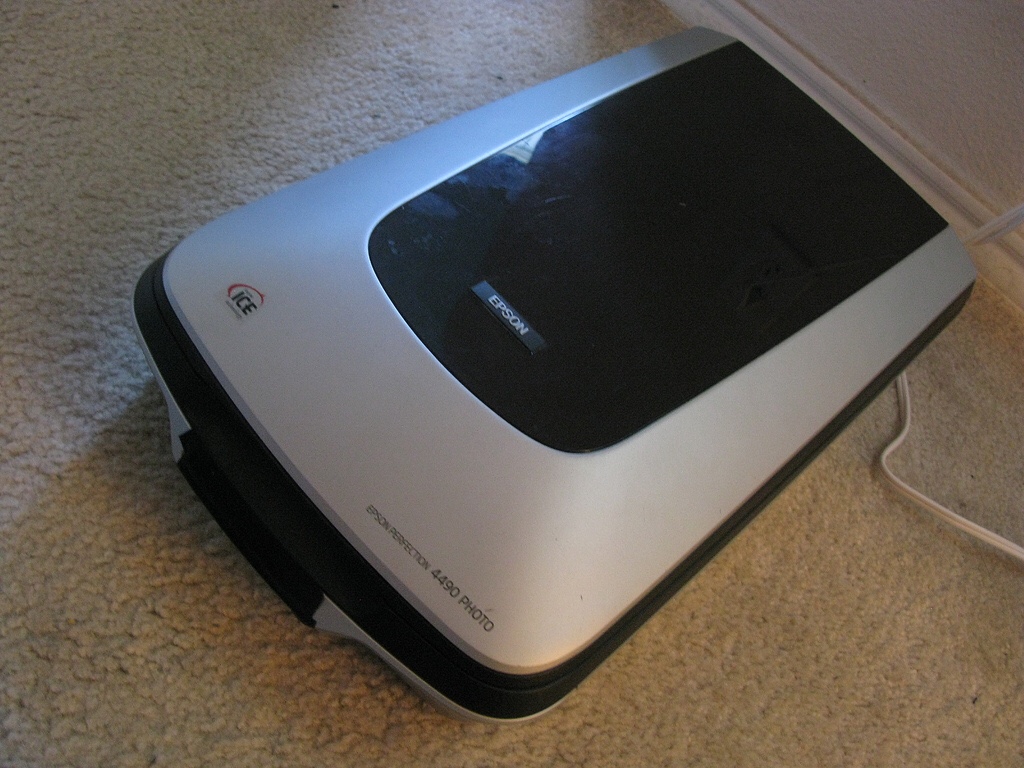

I picked up a cheap face tanning unit for 30 bucks and disassembled the ballasts and the the timer and installed it into a busted scanner I had... Works really well!
Love it!
