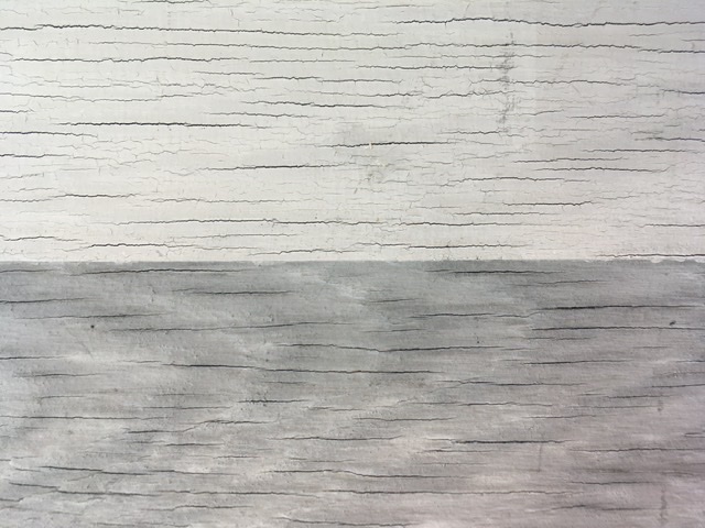

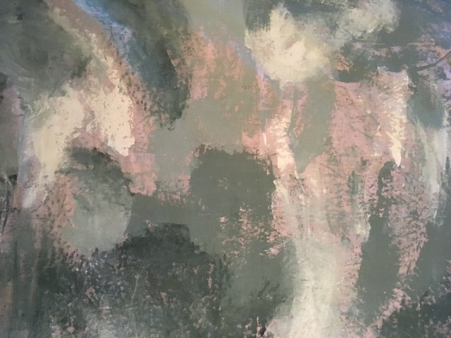

BE301B18-2B40-4DAF-A90A-AB79C3DDB660.jpeg 0FDE7A62-C2FC-49DC-B010-901D66FFF52E.jpeg Paint is a good idea. But you have to be careful. One day I got pigment and white and mixed it myself to make a two-tone gray target (Minor White), recently I just wanted to make a backdrop so I got a quart and told them to make it black, and another quart white. Mixed together it turned murky green.
