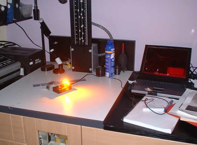

Well, been meaning to make an LED based safelight for yonks and finally got around to it last week. Adjustable brightness, plug-in LED heads for different colours & more output than my Duka 50 (2 or 3 times) in a box the size of a packet of cigs.
Interstingly, Bob, I just made a similar LED safelight from an old turn-o-matic sign. Bright as a Thomas duplex (almost) and it'll probably last forever.
