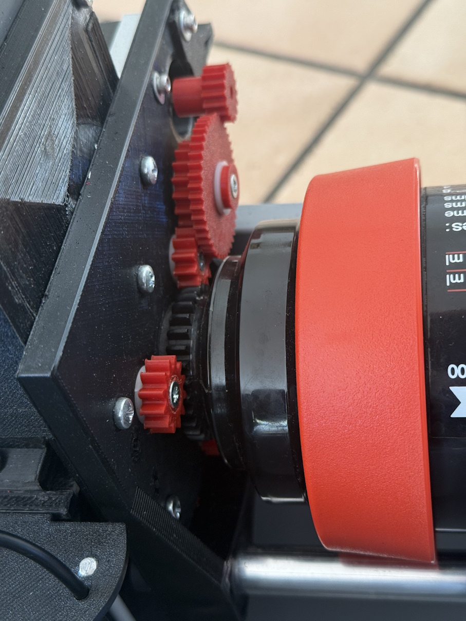

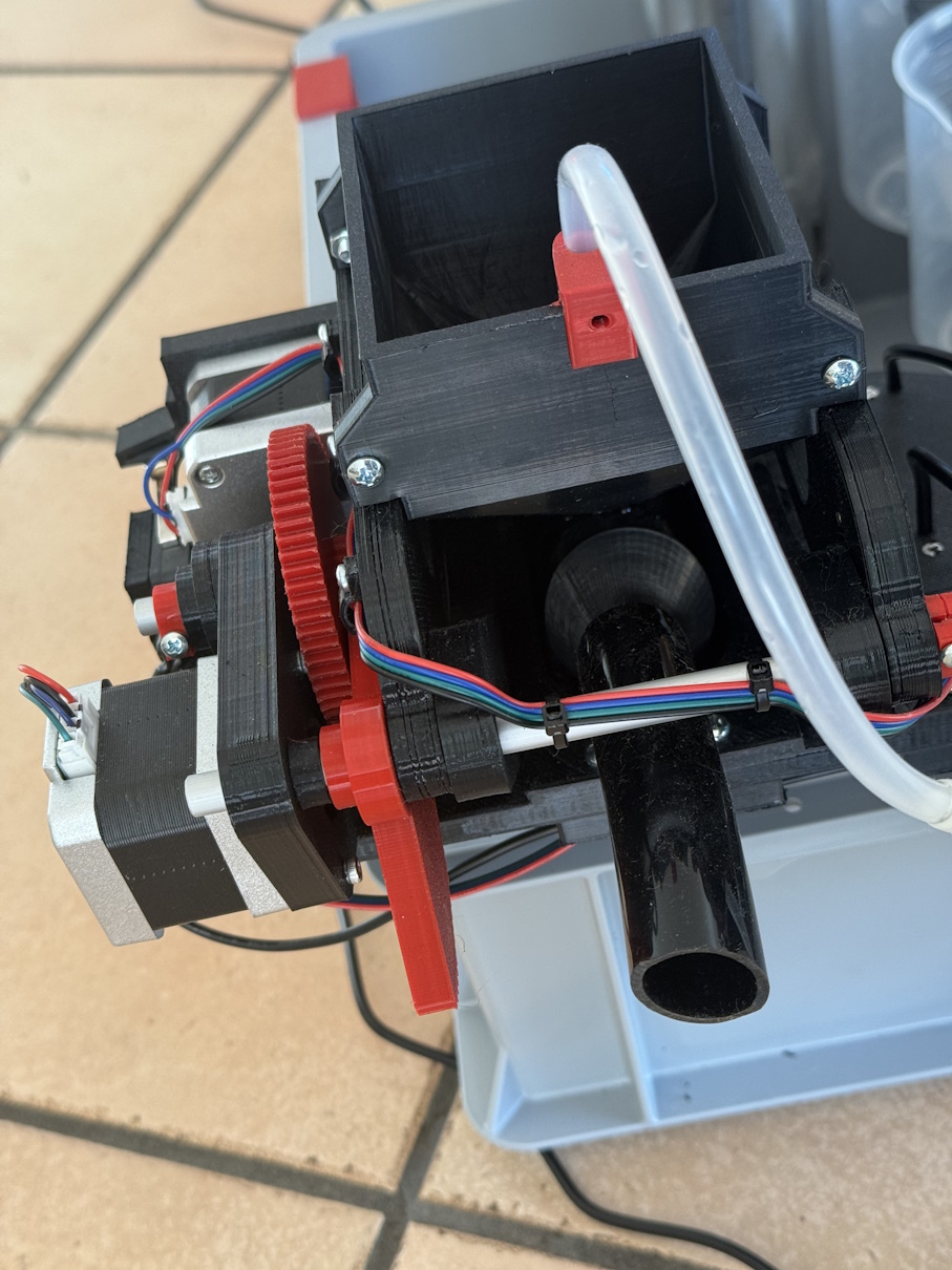

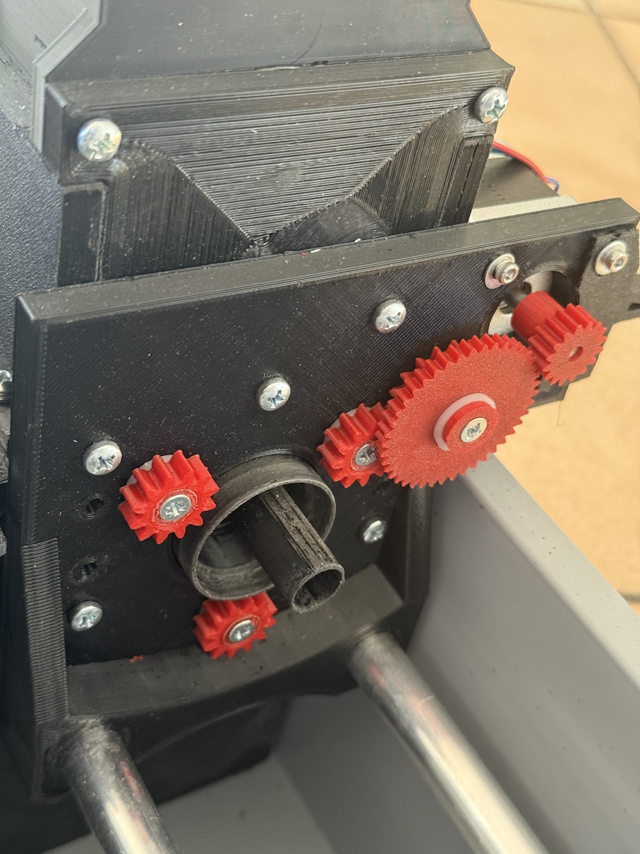

  • Mechanics:
    • Stepper-driven drum rotation with three small gears centering the Jobo tank gear.
    • Stepper-driven lift with reduction gearing for torque.

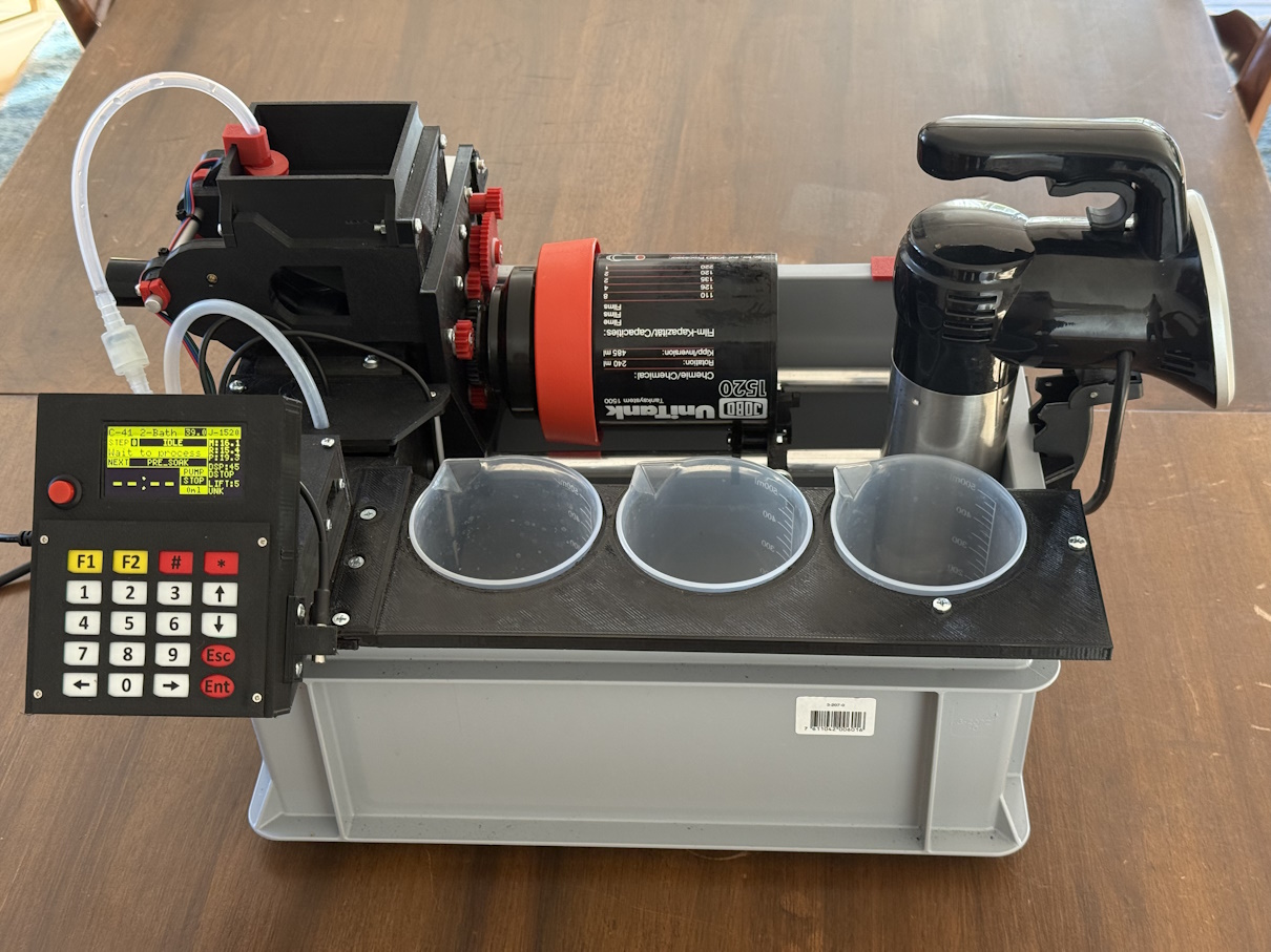

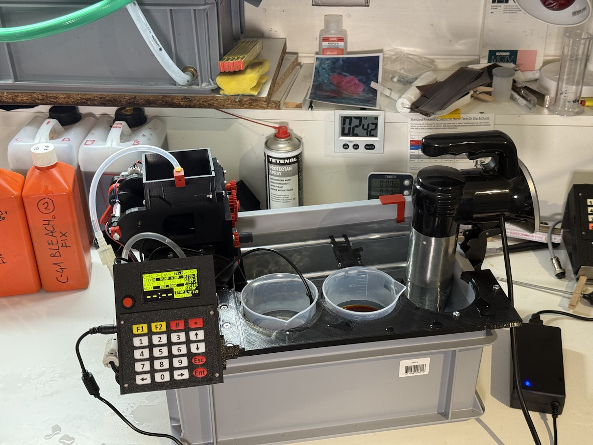

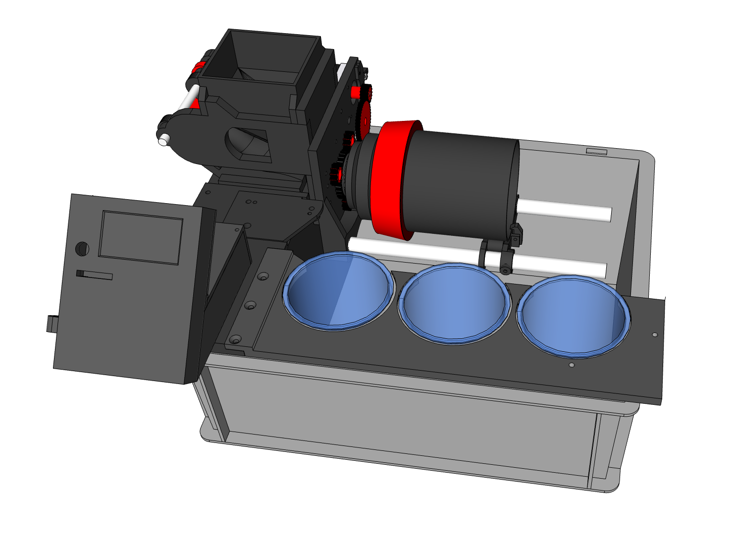

First test results​
The first full development cycles have run almost perfectly.
However, I’ve noticed a few small details to refine:
  • The wide-mouth beakers I used aren’t ideal for temperature control.
    I’ve already drawn and 3D-printed three custom lids to improve chemical pre-heating in the water bath.
  • The drain outlet drips slightly, so that needs a small redesign.
  • The mantle bath can’t heat cold rinse water efficiently,
    but if you fill it already at the correct temperature, everything stays perfectly stable.
  • To pre-warm developer and blix, I simply place their closed bottles in the water bath before pouring into the beakers.
Overall, the machine feels remarkably comfortable to use
honestly beyond my expectations — and in terms of workflow and warm-up handling,
it’s surprisingly close to a real Jobo CPP.
Here some more Details on the mechanics:
