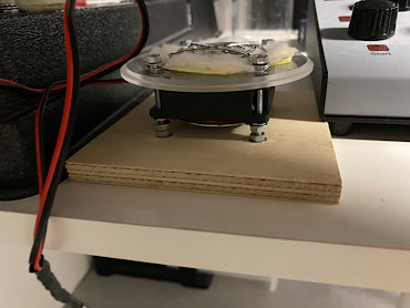

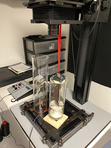

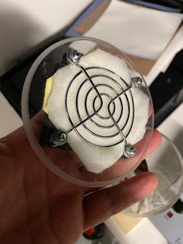

Hello everyone.
I have read quite often here and on other photo groups of the problems, people have with drying their film without spots and dust.
I had this problem, too, but solved it a few years ago when I built a little film dryer.
First of all, I wash my film in regular tap water but use demineralized water from the supermarket for the last two washing steps, then I put the development spools (I use the Jobo 1500 system) into a salad spinner to get rid of excess water. After that I used to place the spools into the dryer and let the film dry on the spool. This never caused any issues, it actually helped because the film could not develop a curl while drying - one of the reasons I never liked to use Tri-X and use HP5 instead.
You can also put some 4x5 sheet films into the dryer. I have to tubes of different lengths, the long tube is ok for up to six sheets of 4x5, the short tube for several Jobo spools.
It of course takes a few hours for the film to dry completely on the spool. But who cares.
I do not use it anymore, because I have built a drying cabinet that I can also use for papers, I‘ll probably post some images of the cabinet in the future, too. This dryer still is a functional, easy and small solution. You can get everything needed for less than 50 EUR / USD.
Dryer with short and long tube:
IMG_2023-12-26-223817.jpeg#
bottom with PC fan and dust filter
Top, also with PC fan and dust filter

The white stuff over the fans is a high class particle filter. I forgot the class, but it definitly is thick enough to keep all dust out. These filters over inlet and outlet are the reason why I use two fans. One alone could not get the air through two filters.
It probably would have worked if I had put the inlet with one filter on to and then blow everything out of the open bottom.

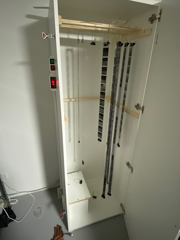

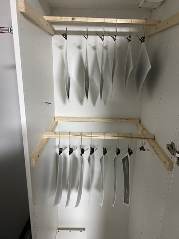

Well, the bathroom might work for some, but I still had problems with dust all the time. And yes, I admit, I am the kind of guy who really is annoyed if a good shot has a bit of dust somewhere.
On a strip of 36 exposures I always could find several photos with a bit of dust here or there and since I want to print my films in the darkroom and have never done any retouch work on prints (and do not intend to ever do it), such negatives are ruined for me. It just drives me mad, to look at a print and see one of these annoying white spots, knowing I cannot do anything, because it is deep in the emulsion of the film.
I would not have put the effort in this stuff, had I not had this problem.
Also I should point out, that my darkroom is in my basement, in a storage room that also includes my central heating, hot water and internet access systems. That room is always rather dusty - the enlarger is always completely covered when not in use.
And it actually got worse when I decided to enlarge only an FB paper which takes quite a bit to dry, for that I then built a complete drying cabinet.
Instead of spend an hour or two cleaning an otherwise unimportant room everytime I want to make some prints, I decided it is cheaper (because I do value my spare time quite more than the 150 EUR it cost me to build that thing, call me lazy if you like) and more convenient, to built a cabinet which I can easily keep completely clean. Air (heated to 28 °C (80 °F I think) goes in at the bottom, out at the top, both holes covered with dust filters. The pictures are a bit older, by now there is a bit foam to seal the door.

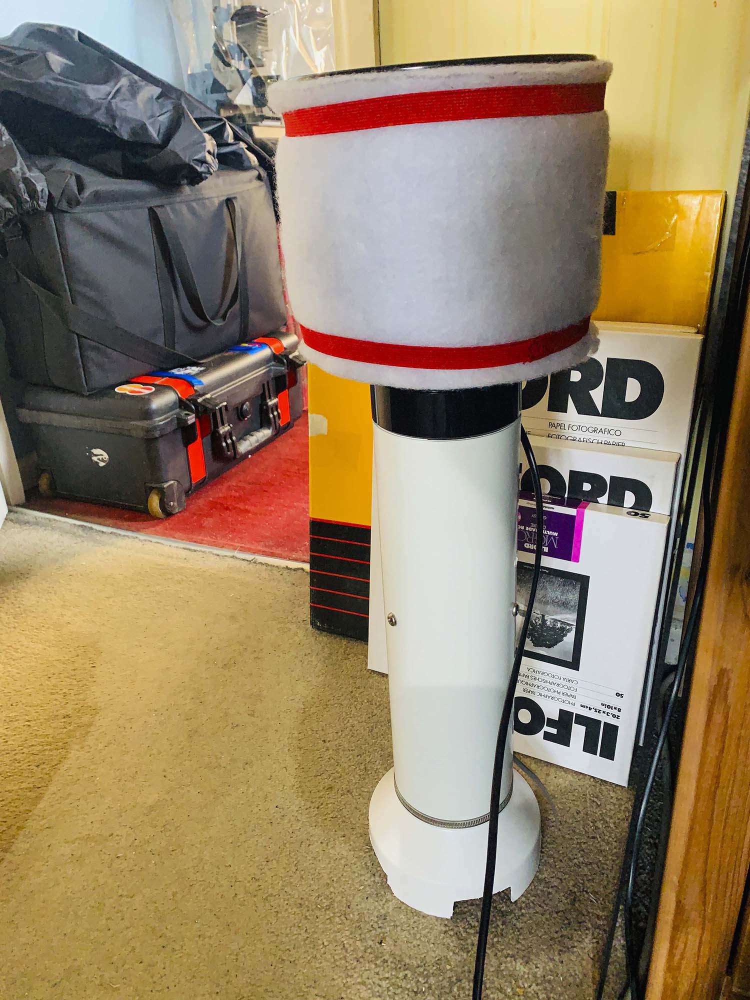

@Thorsten, your film drying device is more elegant than the one I built. I previouly posted photos of that project <here>. My d.i.y. film dryer includes an incandescent light bulb to warm the air. If I was going to build another one, it would look more like yours.
I agree with those that say heat and moving air could theoreticallycause problems when drying film, but based on my practical experience using mild heat and gently moving air to dry about 2 dozen rolls -- I have not experienced anything that I would call a problem.
In the wintertime, when my basement air temperature is 60*F (15.5*C), the air that coming out of my diy drying rig is about 75*F (24*C). In the summer, the heated air is closer to 85-90*F (29-32*F). Typically, my film is almost dry when my 15 minute timer shuts off -- so sometimes I add another 5 or 10 minutes.
The air which is drawn into my diy drying rig passes through a generic foam filter (not HEPA). And my basement workspace is far from clean. My wife mixes up potting soil down there, and I do a fair bit of woodworking in the same area. I do clean my work bench with a shop vac and damp towels before processing film, but it would be impossible to get my basement anywhere near dust free. A few frames on each 36 exposure roll may have 1 or 2 small dust specks which are visible when viewing the scans at normal magnifications. But for me, that is nothing to worry about.
