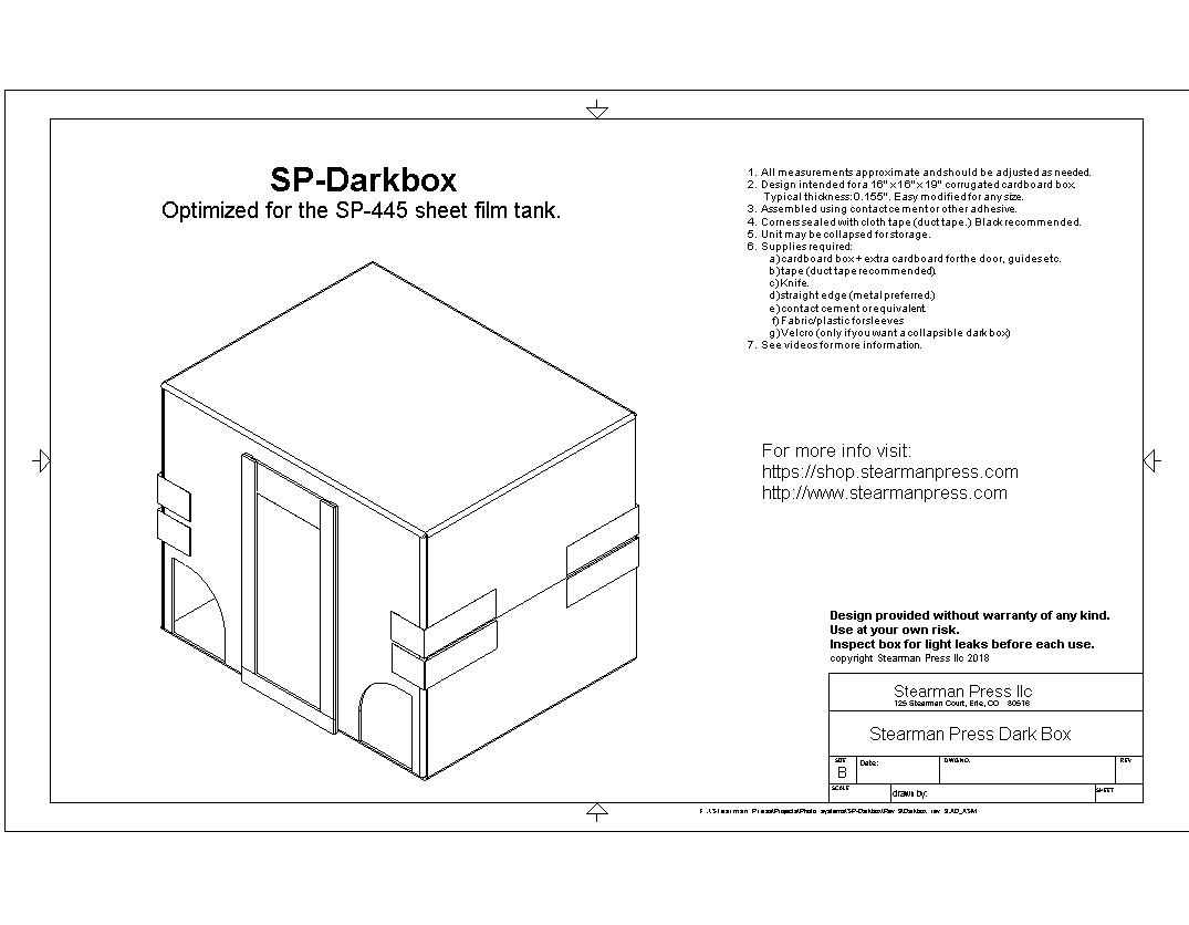

Just posted videos of our cardboard and duck tape dark box:
I would like to know what your idea was behind the pentangle shape of your intermediate (foamcore) design.
It was actually made from Coroplast (hollow plastic sheets used for yard signs). We thought that angling the arm holes would make it easier reach inside the box. Frankly, it didn't make that much difference.
The overall design was very compact when collapsed but difficult to keep light tight.
