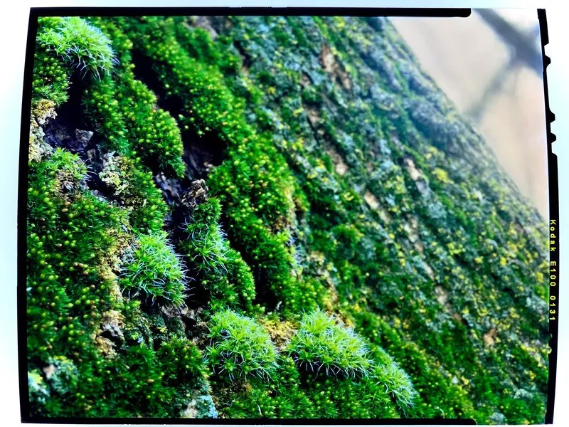

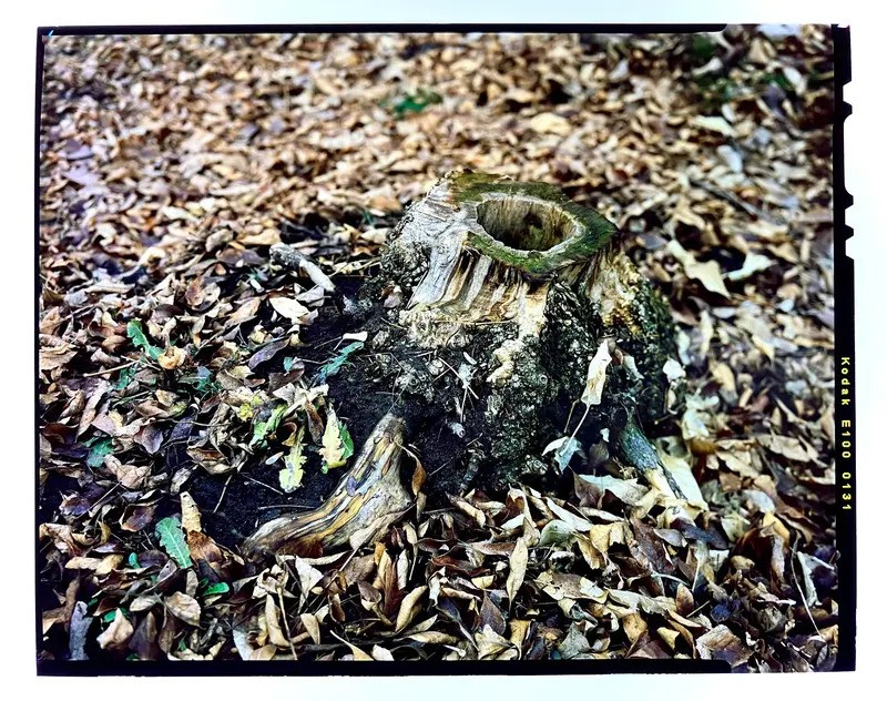

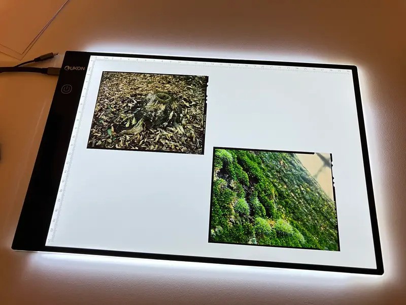

As kind of a "final report" here, I'm getting excellent results that I'm very happy with developing ECN-2 films. I'm getting acceptable results developing C-41 films, but I suspect I can upgrade that to "excellent" with a little more experimentation, now that I know CD-3 is significantly less active than CD-4. And the biggest surprise is that I was able to get far better results than I expected with E6 films. Some HC-110, light fogging, and then ECN-2 chemistry is producing really, really nice slides. And yes, I'm stabilizing with formalin at the end now :smile: ezgif-4-9b22e240d6.jpgezgif-4-9e4a59cc75.jpgezgif-4-0ac51933de.jpg
Low-CRI and rather blueish light source from the tracing tablet, and iPhone auto white balance not doing me any favors there. The thin area of that sheet looks much more neutral in person. It does have a slight yellow cast. Hard to say whether that's simply because I shot these frames with an 81A filter, or because there's something wrong with my process or chemistry. *shrug* easy enough to correct in post. I'll worry about getting it perfect when Ilford announces that they're bringing back Cibachrome :wink:

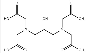

kodak Anti-Calcium #4 柯达 钙剂# 4 is dapta CAS:106362-34-9​
1 3 二氨基乙羟基丙级四乙酸
It appears, that you mixed up quite a few things here:
CAS 106362-34-9 is some weird peptide compound with no (known to me) application in photo chemistry.
The compound you have in that graphic is 1,3-Diamino-2-Hydroxypropane-N,N,N',N'-Tetraacetic Acid, which is a sequestering agent, but most likely not Kodak's Anticalcium #4.
I have already mentioned the true structure of Kodak's Anticalcium #4 in the posting you referenced.
