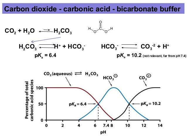

pH will end up way too high:
(quickly nicked from here)
Your developer should be at around 10.25 - 10.30 IIRC. Shifting the buffer to the right by adding an excess of carbonate will shift the pH point upwards. This will make the developer overactive and it will affect color balance as deeper layers (i.e. red, green) will develop faster in relation to the top layer (blue) than intended. It will also affect b+f, but the degree to which it happened here still makes me wonder whether this really explains what you're seeing. Still, it's definitely worth trying.

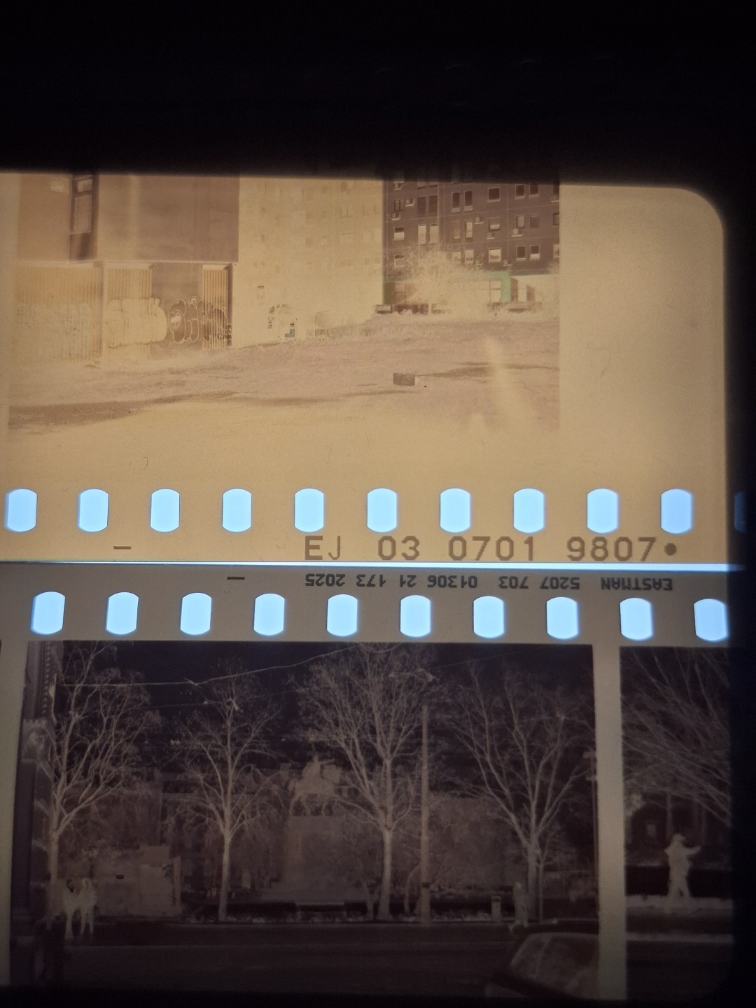

I mixed the developer again. Looks much better!
The top one is some old vision 3 500T that I developed with the new developer. Bottom is vision 3 250D I developed with the bad developer.
Oh, that looks a whole lot better! The top negative looks underexposed, but development looks reasonably close; perhaps a little thin.
So was this indeed the problem that @lamerko suggested, i.e. the carbonate mixup?
Yes, it was the carbonate.
