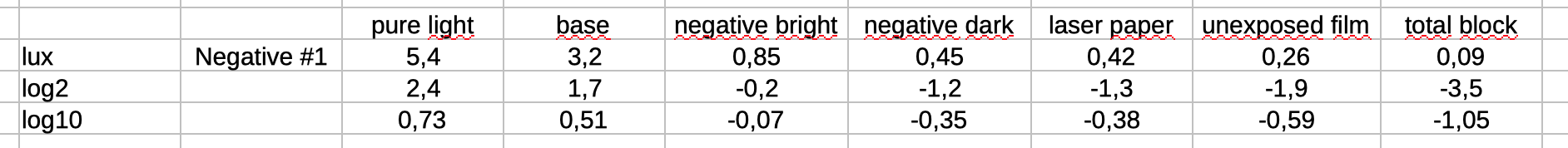

So I did some tests on underexposed negative that is difficult or impossible to print. There are some other values as well for funny reference. And log2 and log10 already calculated, dunno which I should use for "official" values.

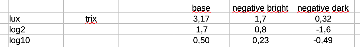

Then here is a much more dense negative for comparison - haven't tried to print but visibly much better better (Tri-X exposed at 3200 and developed by digitaltruth times on xtol 1+1):

.. so what next? What can we learn from these values? When trying to adjust development for printing, what should the values look like? I got approximately 3 lux difference out of 5 (pure light) so I think I have enough resolution in the system or do I?

So what about the values. The underexposed / badly printing negative has contrast difference on 0,28 in log10. The visually much better Tri-X negative has 0,72 difference.
So the ISO R values for these are 28 (underexposed) and 72 (tri-x). We can easily see why the underexposed negative is difficult to brint, it goes out of roof from grade 5. For example Ilford V paper at 5 grade is ISO R 50. The Tri-X negative is very close to perfect, I guess; it should be printed with grade 3 on Ilford V paper.
Question is what grade should be the target, or is this so simple? If I've understood correctly the grade 2 would be more ideal to target which would mean that we need ISO R of 110, which is in log10 1.1 - correct me freely on this! The Tri-X was heavily pushed which might caused a bit thinner negative than the target is. Is the correct way to get closer to ISO R 110 by overexposing or overdeveloping?
Have I stepped correctly into the world of negative densities? What I really know now that I never ever want negatives with low density because those are too impossible to print. Why I have been exposing the negatives incorrectly is another story..
