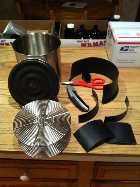

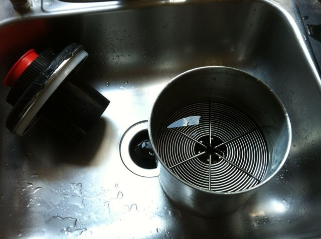

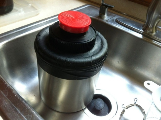

I had to make this tank for my 70 mm reel which holds 15 feet which is still a lot.
I just cut up a JOBO basically and stuck it in a pot lid. However 75 feet is a lot, are you able to Mayne skip frames and measure out 3 feet lengths to cut?

The repurposed light lock is ingenious! I'm going to remember the inner-tube trick if I ever need to run a larger-diameter tank . . .
