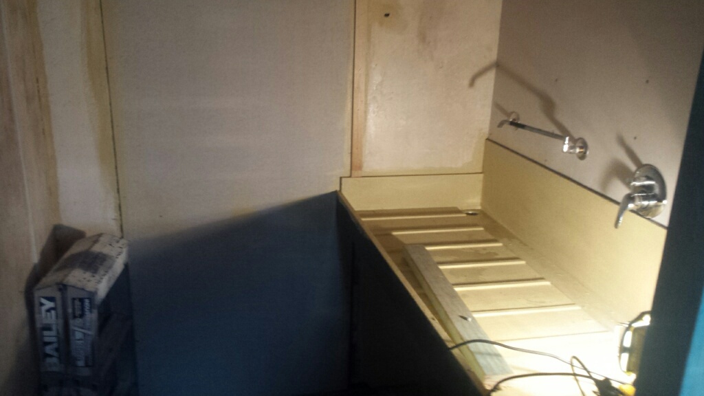

Mine is made with form/marine ply 1800mm x 1200mm x 20mm. Made a trough at the rear just by stepping a 100mm piece, all has slight fall to a 50mm plug and waste, added strips and painted it with water proofing paint. Been using for a couple of years now without any leaks. Repainted the trough after spilling some corrosive chemistry. Its 600mm deep and 1800mm wide, its supported either end and does need any legs in between so have good storage space.

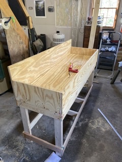

Day one of the sink project! Chiseling out around the drain is a bit tedious but this is otherwise very easy. Home Depot cut up the board.

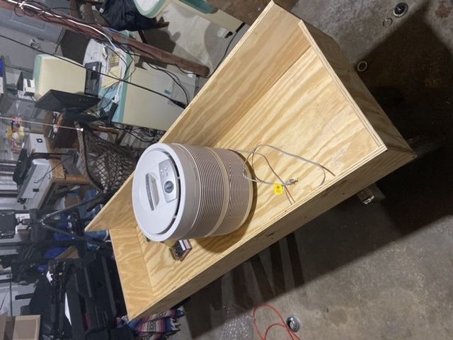

Taking shape a bit. There are some larger gaps at the corners than I hoped to see. I guess I will use caulk to seal them up as best I can after I finish putting on the epoxy paint coats.
