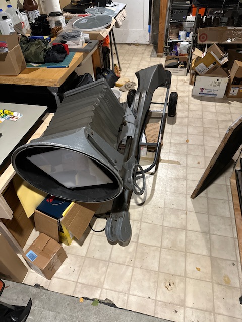

I got the Elwood out of my car and into my basement today. I will likely disassemble and do some cleaning. This leads to some questions.

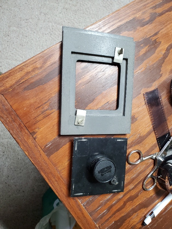

1.all I see to retain the lens board is a small maybe 25mm square piece of thin steel.
If this is correct, I may look into modifying or making an adapter to take the Saunders/Lpl 4550 style lens cones.
Or maybe a free 23cII will pop up and I can cannibalize the lens stage pieces.

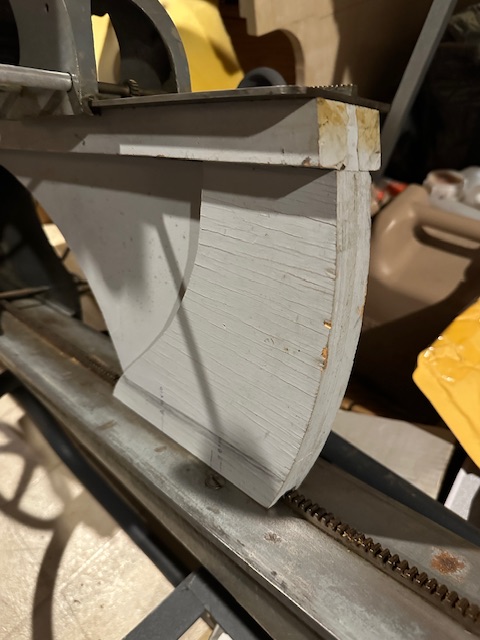

2. The stabilizing or parallel holding “fin.”
The part that keeps the main column and lens stage rails separate but parallel. Is this supposed to be a cast piece?
Mine is made of wood.
3. Does the Bellows actually need to be so large to accomplish its job?
4. I’m really tempted to bolt the thing right to my floor to maximize available height.
Aside from it then being semi-permanent, are there any drawbacks to this idea?
I’m really curious which model Elwood built first? 8x10 then shrink the tooling and forms to make the smaller ones or vice versa?

The wood is factory. I think some may of had a cast part. The springs (lifts) are same as 5x7, only 8x10 came with 2. Lens boards are the same as Kodak (IIRC) There exists an Elwood cast adapter that allows the use of 4x4 inch Beseler style lens boards. My buddy has one of these and she built a wooden platform with 6 inch wheels off an old lawnmower, puts the enlarger about 8 inches off the floor. Allows for the enlarger to be raised full height if you have 8' basement ceiling.

Her unit has huge bellows too.
500W mogul base bulbs.
Wood piece looks ok.
Making a custom lensboard holder seems like a good idea. You could also attach it with 3 spring-loaded fasteners so it can be tilted/aligned to the negative stage.

I have 80" height available, so placing this thing on a thick base is not really an option. Main 2-piece column is 70" tall. If anyone is curious, it will not stand up on its own. The head casting is heavy and projects quite a bit away from the column. It's quite "tippy."

After my post last night, I did some more looking and there is a slot on one side of the lens stage casting that accepts the lens board, so the little single piece of steel makes more sense now.
The cast base on my unit actually has 5 places to send bolts into the floor or base panel. 4 corners, and a 5th "eye" in the rear center. I realize "base" may confuse the issue. The lower part of the main column from the pivot point down is what I am referring to as the "base." There is a worrying amount of slop between the 2 sections of the column. I have the bolt in place that secures the 2 sections, maybe I just need to apply some more torque?
My other thought regarding bolting to the floor is time. I would guess 20 minutes to get it bolted to the floor vs anywhere from 1-4 hours building a wood base depending upon scrap use and how much milling I had to do.
For extra stability, it looks like there are 2 holes dead center up on top of the column where one could swap to a single center support spring vs the left/right pair of springs. (or add a 3rd spring I guess since there is a 3rd hook)? To me, these "extra" holes are a prime location for a strap or some type of top end support strut.

That 4x4 adapter looks nice and simple.

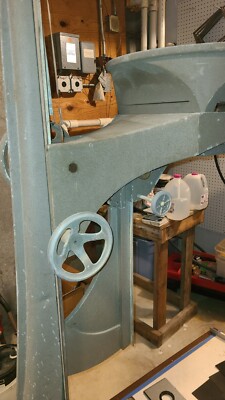

I'm curious if any of you have a big head elevation knob on both sides. There's an ebay listing for one that has a large wheel on both sides. It's possible one of them is the elevation lock wheel I guess?
