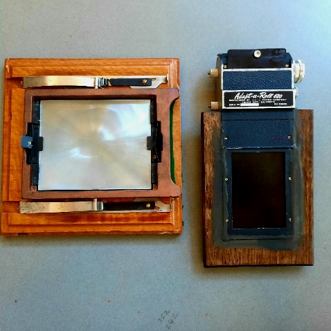

Go for it, Ive made several backs to fit various cameras using salvaged backs. Just measure the film plain and make sure it matches the ground glass. Hardest part is making it light tight and secured. Adhesive felt if help full.
Hers a couple of DIY backs

Making a 4x5 back shouldn't be all that difficult. When I was making the back of my 14x17, the most critical measurement was the distance from the inside of the back to ground glass... it must be of same thickness as your film holder. I measure with a gauge the woodworking teacher had at my school, then used a router set to same depth. My ground glass is just some plexi that I sanded by hand.

The most critical measurement is the inside edge of the film holder to film. That should be the same thickness as the ground glass from inside edge to glass. Ignore the bellows to film plane. If those two thicknesses do not match, even though you can focus a sharp image on the ground glass, stick a holder in and take the photo, you will find the negative is unsharp...
Of course the critical film/groundglass distance (they must be congruent) lies in the back itself, unrelated (other than it be parallel to the back) to the position of the standards. I had a complete 4x5 Graflok assembly at one time, grafting it to a homemade back panel would have been pretty simple as long as the hole was in the right place and it was square. An off the shelf item like that would save a lot of time and effort as well as accepti any Graflok compatible accessory. Just a thought.
I also made a simple way to test the congruence of the gg and film plane: I drilled 5 good sized holes (4 corners and the center) through a film holder septum, removed both dark slides and groundglass. I put an exposed piece of film where unexposed film would normally be in the holder. Using a lupe I could then focus the camera on a focus target on the film. After removing the modified holder and reinstalling the groundglass if focus was the same I knew was good to go.
The film is 5mm away from the front of a 4x5 film holder, by ANSI specifications.
Thank you all for the help. I found the one I was pretty sure I had. I now have a complete 4x5 Graflok assembly. It's mounted in a frame that doesn't work on my intended camera, so the wood working shall begin.
No need to get overly complicated. Basically, you need a light tight connection to the camera, a method to hold the film flat and an indexing to know when the film is perpendicular to the light path from the lens.
