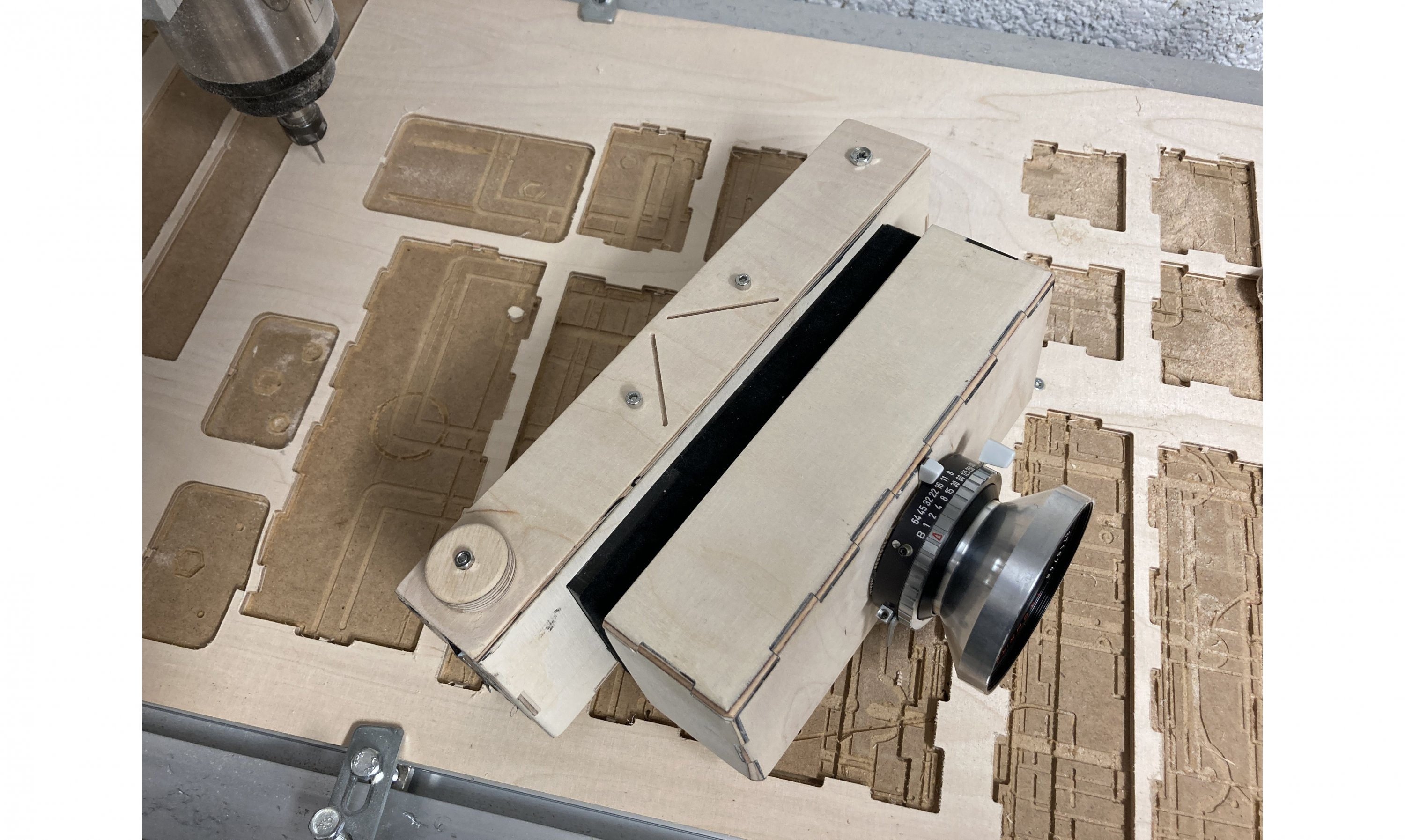

Hi,
I got my 6x17 camera to a point where I could shoot some test shots with it so maybe it is time to show my creation :smile:
It is completely my own design and CNC milled from 4mm baltic birch plywood. I'm using Schneider- Kreuznach (Technika) Super Angulon f8 / 90mm lens.
The horizontal FOV is 86 degrees and the 35mm equivalent focal length is 18mm.
Today I shot first shots in really dull snowy conditions to paper positives so nothing to show yet. I'm going to try a roll of 120 film next.. Now I only need to find some scene that suits this true panoramic format :D
Usual question. I don't see the focus mechanism. What am I missing?
I ask because although I don't shoot 6x17 -- 6x12 is my widest -- I've found that 90 - 100 mm lenses have to be focused.
Focusing is done by moving the box where lens is attahed. There is adjustment "slide" is at bottom, unvisible in these photos.. However at f16 it is sharp from 1.7 meters so there isn't really need to focus..
Thanks for the reply. Double sliding box. I take it you're going to put distance marks on the outer box. Since there seems to be no provision for a ground glass, how do you plan to do that?
Yes, my plan is/was to mark certain distances so I can focus by moving the outer box to the mark. But I don't know how much I need that at all.
I can pre-focus by using ground glass in place of film plane. I was playing around with the focusing today with ground glass and I can confirm that the hyperfocal theory is correct :wink:
If my experience is any guide, you need it.
I believe in you. I don't have real experience on this format at all, only calculations.
The aspect ratio and FOV is so different than what I've used to shoot so there is lot of learning to understand how to even compose for this format :D
As I told you, I don't shoot 6x17. 6x12 and nominal 6x9. On these formats even lenses shorter than 90 mm have to be focused for best results (plane of best focus where wanted, etc.).
What I learned today with ground glass is that the area where infinity is sharp is quite "long". I couldn't see any sharpness change, only the shortest focusing distance changed. Of course after certain movement the infinity became blurry.
But that was only by looking at the focusing glass. I've understood that hyperfocal theory is based on "acceptable" sharpness and the CoC is key point in that.

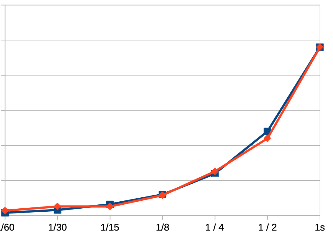

I measured the shutter speeds and first I thought all times were doubled. But then it came to my mind if the iPhone SE2 has faster slow-mo video frame rate (compared to my previous phone 6S with 120fps). And sure it is! 240fps. The shutter speeds are pretty fine!
Orange=measured, blue=what is should be
