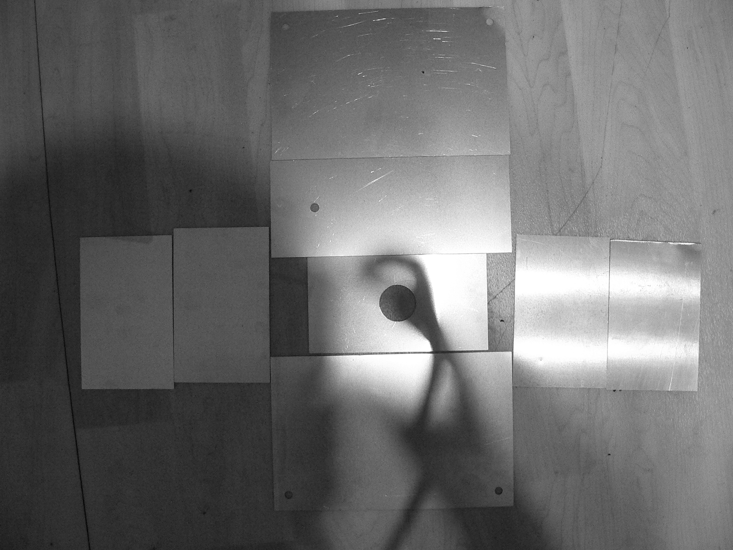

Hello there, I want to adhesive 90 degrees walls together ? What do you advise ? Is metacrylate fit to the purpose or epoxy is needed. And I want to paint black inside with few black graphic marker pens.

Given those two choices, I'd use epoxy.
Seconded. Even so, I feel there is not enough contact area between two plates at 90° for a reliable glue bond. I would add a corner reinforcement in the form of a small square bar or L-profile. And make sure you dull the parts to be glued with medium grade abrasive paper; and de-grease thoroughly.

Sharpie will not give an opaque black on metal. Use a spray can of matte black paint. Two or three light coats; never reach the point where the liquid paint starts to accumulate; just enough for the droplets to merge.

I would use hot glue as it will form a bead around the inside edges to reinforce the join. Epoxy will shear at some point. And I concur black magic markers are not truly opaque and the silver surface of the aluminium will show through especially in long exposures. What's wrong with a rattle can of auto matt black? But unless you are using aluminium for a particular reason I'd have used 5mm black Perspex and glue made to bond Perspex, but you'd still need to paint the inside.

I agree. This should have been designed to be assembled with screws into a brass or aluminum framework, if the aluminum is not thick enough to edge screw.
It's possible to weld aluminum. Maybe look into that and then caulk interior corners with black silicone - after spraying the interior surface black.

Personally speaking, I'd make it thicker and include rabbet joints, or the like.
Or a skeleton/exoskeleton frame.
Or a different material, like baltic birch plywood.
There are many ways that are more effective than trying to marry thin aluminum sheet parts.

Another option is fabricating outside full-length corner cleats that you can screw or rivet to the sides.

@OP, I'd use tape (black, several layers if you want to try with film at that stage) first, to see if everything fits and works to your expectations. If/when it does and you want to make it permanent, epoxy should work, but only together with L-profiles as has been mentioned, or reinforced with strips of fibreglass or similar fabric. Of course this would go inside; it won't be pretty and typical epoxy isn't very UV resistant.

For such a fun project I would use black expanded PVC. Easily cut DIY with a circular saw (fine-toothed blade) and a clamped-down mason's ruler as a guide. . Easily glued with specific PVC glue. Mistakes not very costly.

Boatbuilders often use epoxy "fillets" to increase the surface area of a glued joint. This is done by adding a filler to the epoxy, such as wood flour (sanding dust), silica, or microbaloons. The thickened mixture is worked into the angle of the joint with something like a popsicle stick or tongue depressor leaving a fillet of material.
See: https://www.westsystem.com.au/basic-techniques/bonding-with-fillets/
But epoxy fillets are messy. As a hobby woodworker, I would probably cut some wood sticks to fasten inside the joints.
Before using any glue or paint on aluminum, it must be very clean and a little bit rough (not polished).

Yes!, that’s what I meant by exoskeleton. Screw or glue or metal tape… he’ll consider this good design option sooner or later. 1 mm aluminum sheet is just too thin for many other options.

Oh and if you use epoxy, you'll need to add black pigment to it to get light-tight seams!

I will second the idea of external tape for initial assembly. Vinyl electrical tape or duct tape. Epoxy plus tape might work well. A helpful thing to do is attach small guide blocks on the inside edge of a part for another part to lean against during assembly. A 2 or 3mm square rod cut short of the ends, epoxied inside one part and set back 1mm from the edge might give you the solidity you need. I've butt-glued 1.5mm material for a rough camera box, but 1mm is getting down there for simple butt joints.
Black markers are not a good approach to blacking the aluminum. Flat black spray paint is what you want. Sure, aluminum should be roughed and an etch primer used for lasting adhesion. But for now just get it blacked out some?
Ideas should come to you on other ways to do things. Very possibly you will be able to use the parts you have for a working prototype, and that might be all you need.

Another option is to glue non-glossy black paper or fabric to the parts of the body that will be inside.
