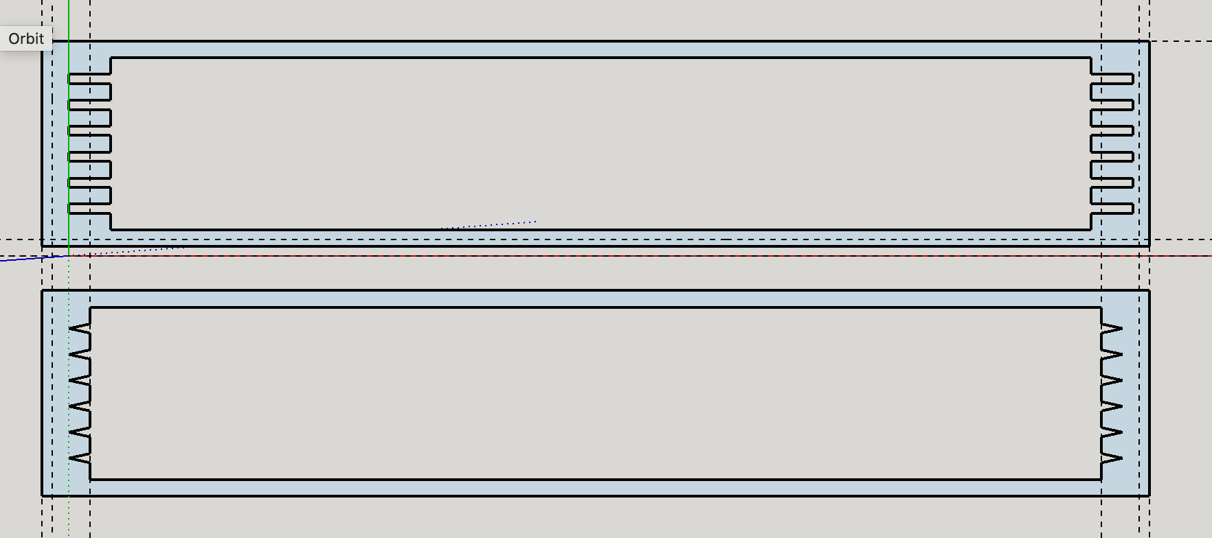

I've used the taco shell method to develop my 5x7" sheets but I usually have 6 sheets to develop and I need to develop in two sets which feels a bit tedious. Also the chemical usage is really high on taco shell / paterson tank.
I saw similar design like drawn below and started to think if I should make one myself (wood).
Any experiences on designs like this? Is there a risk sheets sticking to eachother? If anyone has similar tank which is working, what is the distance between sheets?
And which notching would be better, the following views are bottom down (5" wide):

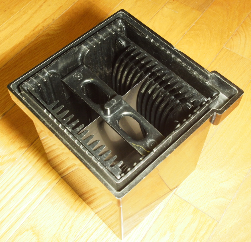

Ideally you need to support either end of the film as well. Have a look at the Dallan tank in this thread. I have a coulpe of these tanks, one like this the other newer, the inserts are the same though. Also look at how 7x5 film hangers aremade the ones I have are slip in 3 edges are in a channel, the idea is to stop the film sagging and falling out.
Ian
Do the pictures represent the tank itself, and you intend to close it and invert to agitate? Or do the pictures represent a “holder” which you then dip/dunk in an open tank?

Yes that was just the profile for the "holder". Of course it has bottom and top :smile:
Water + wood is not the best combo, I know. But as milling plywood is peanuts for me, I really prefer wood. Next question would be: how to protect the wood from liquids. Epoxy would probably be best option but it is difficult to apply to all corners etc.
Maybe I need to consider POM or other plastic.. Much more expensive :/
Ian
Great tip. Yes I had in mind to support from bottom but then I need to reconsider how to circulate the developer from pouring inlet .. The Dallan tank looks a bit metallic masterpiece - not possible for me.

So maybe the sheets wont stick to each other. But how I should protect the wood? Linseed oil? Paraffin oil? Paint?

I need to 3D design + print film holder and think of that solution too. I guess the double opening (top/bottom) is pretty stupid idea. It should be closed from bottom, for sure.
Just asked prices for PVC sheet from local supplier and those seems pretty reasonable. PVC supposed to be good to glue.
Maybe plan would be build a box and light sealed lid with some liquid holding cababilities.. The groove system is really hesitating idea still .. Maybe I try making a wooden one and try loading that with sheets and check how it works!

Also, it seems like holding the sheet curved around the horizontal axis makes it less likely to curve vertically - if the sheets were flat then then they might be more likely to flex and touch each other during agitation. The instructions do warn to only agitate parallel to the film to avoid knocking the sheets loose. I haven't had that happen accidentally yet.
There is usually some uneven development, a dark overdeveloped line on either edge of the negative along the slots. In almost every thread I've seen about this tank someone is complaining about this, I haven't found any solution.
