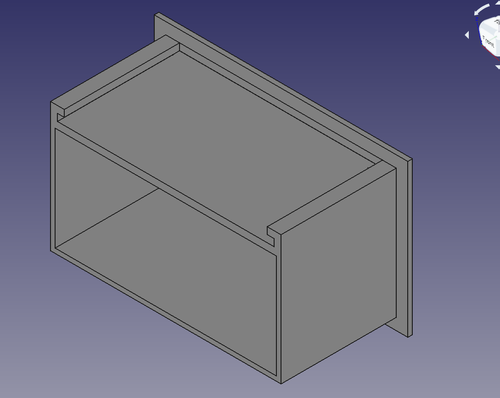

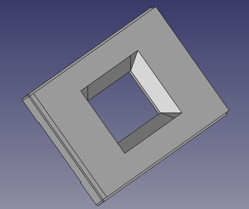

A while ago I joined a local "Technology Cooperative" and I've been taking some classes there on 3d printing.
A couple of years ago I saw the Film Toaster at Photo Plus, and it looked like a workable idea, although for $1300 us it's quite steep. I was thinking that something much simpler could be made that would be nearly as functional for much less.
Now that I think I've graduated from doing simple 3d print things like little kitchen gadgets and Baby Yoda dolls, I've been playing around with a design for a box to do just this.
I'm envisioning a box to hold a light source and a two-part plate with a 36x25.. (for a slight overscan) which would all sit on a more or less standard copy stand.
Simple! Almost minimalist.
I haven't printed any of this yet, and I'm interested in hearing if anyone here sees any issues that I'm overlooking.
The one issue I'm well aware of is that (at least the pieces that touch the film) will need to be carefully sanded and polished, as 3d prints tend to be rough, particularly around the edges.
I still haven't figured out what kind of light source to try. (LEDs???) Any suggestions?
Thanks. :smile:
General feedback:
1. Make film mask interchangeable so that multiple film sizes and formats can be scanned with it by simply replacing the mask part.
2. Make the box large enough to comfortably house the largest film format you plan to support scanning
3. Make the box with some channels to put diffusion material between the light source and the film, you may need more than one layer of diffusion to get a smooth output
4. Make the box deep enough so that there is enough distance between the diffusion and film that the diffusion material will be out of focus when scanning at reasonable apertures.
5. If possible, put in some facility to have standoffs for adjustable feet so that the whole assembly can be leveled with the camera. This could take the form of some blocks on the bottom that can be drilled and threaded so that the feet can be screwed in/out to adjust the level at each corner of the box.
Mask specific feedback:
1. The area where the hole is for the film should be as thin as possible and/or the edges angled away from the opening at least 45 degrees, if you don't do that, you'll get shadows and/or reflections in the scan from the thick material surrounding the film
Light specific feedback:
1. Ideally, use a light source with as high of a CRI as possible
2. Be prepared to make it as bright as possible, you ideally want to scan with an ISO of 100, a shutter speed of at least 1/60, and an aperture of at least f/4.0, this requires a lot more light than many realize. Less light means higher ISO (more noise), longer shutter times (more noise, and vibration induced reduction of sharpness), and more open aperture (way shallower depth of field, more difficult to keep the whole frame in focus).
I personally use a strobe in my setup, but if you can get it bright enough with enough diffusion, LEDS can also work. Halogen/Tungsten can also work, but will have heat management issues. I'd avoid fluorescent lights, as it can make it difficult to use higher shutter speeds with some cameras as the flicker can show up as banding, depending on the camera and shutter speed.
Let me know if you have any other questions, I've scanned a lot of film and will be happy to pass on any general knowledge I've acquired through doing so.
Keeping in mind that I'm going for simplicity and minimalism here, as in I don't want the "perfect" to stand in the way of the "good", I've been thinking of using those small stick-on feet on the bottom of the box, mostly for stability when sitting on the copy stand. Realistically, the error from level should be in the small fraction of a millimeter. LOL, the terms "drill" and "thread" are things I'm trying to avoid here. :smile:
I do see the point of a bevel in the top of the box, and that's very easy to add.

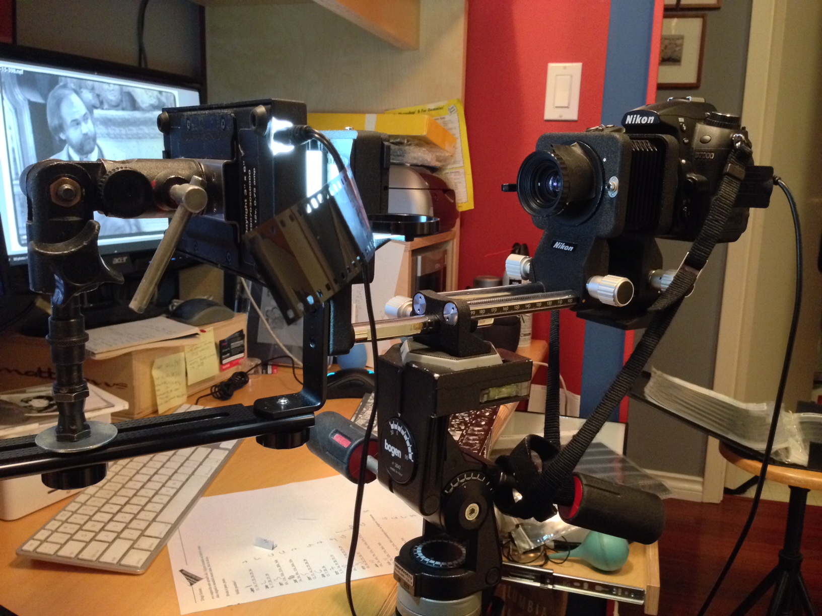

Adrian, thank you for sharing your insights! Do you mind sharing picture of your setup with the flesh as light source? I'm using Nikon bellows unit with negative/slide holder, Rosco LED and only for BW negatives. I would like to try using it with strobes (Nikon's SB series) but all my ideas are fairly clumsy. This picture is from a few years back.
next time I’m at the lab I’ll snap a few photos of just the light source, but will be not including the full setup as there are a number of things I have in development that might actually be marketable products. The light source itself isn’t actually that interesting. It’s just a speed light firing into a heavily modified light panel. I have all the diffusion and baffling on the inside of the panel, so from the outside, there’s actually not much to see, and I’d very much rather not take it apart to show the innards as it’s heavily used on a daily basis and I don’t want anything to change. The speed light I’m using is a Lumopro LP180. I picked it because it’s manual, and has a high voltage port so I can power it from a wall adapter, and it has a wired sync port, so I can trigger it from the camera with a trigger cable. I’ve burned through 2 LP180s and am currently on my third one (yes they do wear out and fail with use), unfortunately, it looks like Lumopro won’t be making them any more so I’m on the hunt for a replacement and will make a new light source designed around whatever strobe I end up with. I’ve also completely blasted through (and then a whole lot more) the designed shutter count of the camera I was previously using, which prompted replacing it with the camera I’m currently using, the Canon 90D.
Thank you in advance Adrian!

My LED light source - a Nanguang CN-T96 - is much brighter than the typical "tracing pad" and is advertised as having a fairly high CRI (says "CRI>90" and also, "CRI: Ra: 95").

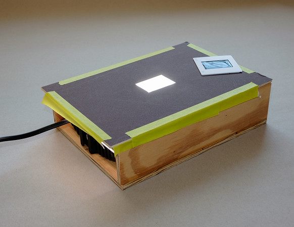

Thanks Runz! Things like this are what I'm looking for, as in examples of what people before me have done along this line, whether or not done with a 3d printer or more "low tech" :smile: tools. :smile:
I googled that light source, and even though it's about three times the area of the box size I want, it shows me that a LED light source can and will work with such a project.
Various "maker" sites have LED strips, banks, squares, etc. which are physically smaller. I like the idea of LEDs for illumination for simplicity and lack of heat, and if photographers are comfortable using them to render skin tones, and others have used them for scanning, I'm feeling more at ease with using them for this project.

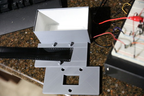

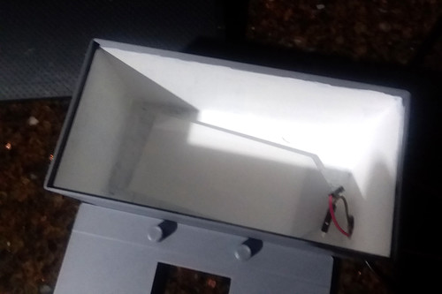

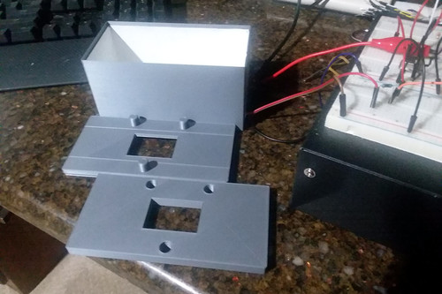

I made a slight tweak to the item that holds the film and faces the light, as shown in the first image below. This view is the side opposite the one shown in the view above, and shows the bevel to control any shadow cast on the negative.

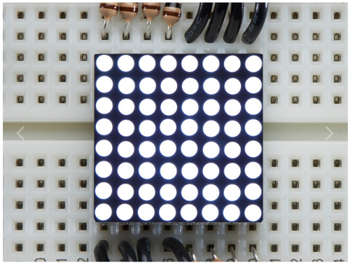

The second view below shows an item I stumbled on last night on one of the "maker" supply sites. It's the light source for a small LCD display, without the LCD display part, and it's ridiculously cheap.
Does anyone see any reason why it would not work as a light source, just placed in the bottom of the box? It looks like it should not need any diffuser at all.

the second image looks pretty nifty, though I’d have to wonder how bright it is.

For those who care (and for those who don't) :smile: I've successfully 3d-printed what is basically the first version of the scan box and it does look promising.
I painted the inside of the box and the top of the middle item flat white. In 20/20 hindsight, they did have some white 3d print filament, and I guess I could have used that instead of the default grey color. I placed the backlight thing (not really sure of the best name to call it) in the bottom of the box, not permanently mounted yet. Not having a real power supply for it yet, I took it in and got it to work (with some help, of course) in the lab using an adjustable bench power supply. Using a 150 ohm resistor (that's what one of the guys who knows these things said was a good value to start with) it starts to light at about 4 volts and anything over 10 volts gives it no significant change in brightness. The light intensity looks very consistent across the plane.
The whole thing fits together like a glove! I'm impressed! {blow on fingernails, wipe on blouse} :smile: The top two pieces which hold the film fit together very precisely. I centered the one image and slid on the top.
I have not sanded or smoothed it, so I was VERY careful in loading a test slide, one from a roll of Ektachrome 100 that I shot last year.
The light appears to be bright white and consistent across the film plane. I have no practical way (that I know of) to measure the color spectrum, so further tests with this light source will probably be trial and error.
